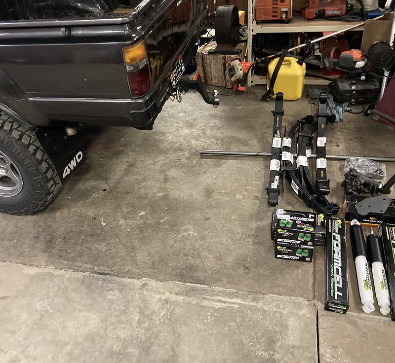

and the good stuff.. I picked up a full Ironman 4x4 foam cell suspension re-fresh/ 2" lift kit
Ln65 hilux by Ryan Miller, on Flickr

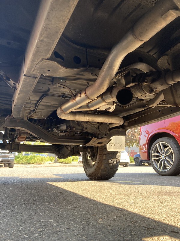

I swapped over all 4 springs and shocks to the Ironman stuff. I removed the steering box ( and radiator ) cut off the stabilizer bar on the frame and axle and started mocking up my rhd IFS box.
I rolled out outside and actually drove it a little with the old steering and swept the shop out.. but I’m still going to do the timing belt before the radiator goes back in, so still a bit of work ahead of me
Got the steering box located, welded in the bracket and fully mounted. Got the steering shaft to connect up and centered.
I installed the hi steer arms.. had to dismantle one side fully as the bearing dropped a needle out when I removed the stock J arm.
Got the axle back together and then made the drag link and tie rods. Was able to put the truck on the ground and see clearance and fitment..
new issue is the 2” Ironman lift is not enough lift to clear my oil pan under compression.. I can lift up one side about 8” before things get near hitting..
still need to figure that out, leaning toward modifying my oil pan for more clearance
Update: watch my 'tube! video done with the major maintenance for now and drove it around a little, however I do need to drop the oil pan down and somehow shorten it so that I get more clearance.. I really don't want to extend the bump stops if I can avoid it.
so far I put about 200 road miles on the truck, the steering bar barely kissed the oil pan under some heavy bumps, my remedy was to clearance the oil pan slightly and extend the bump stop down a little bit.
