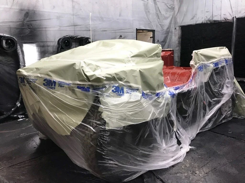

Cage is ready to go into the powdercoatin' booth ...

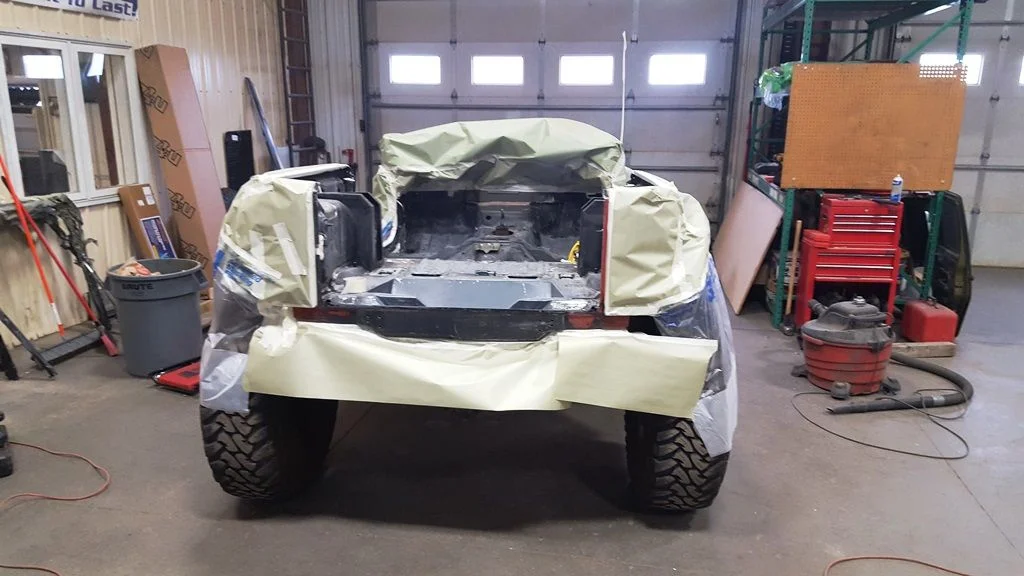

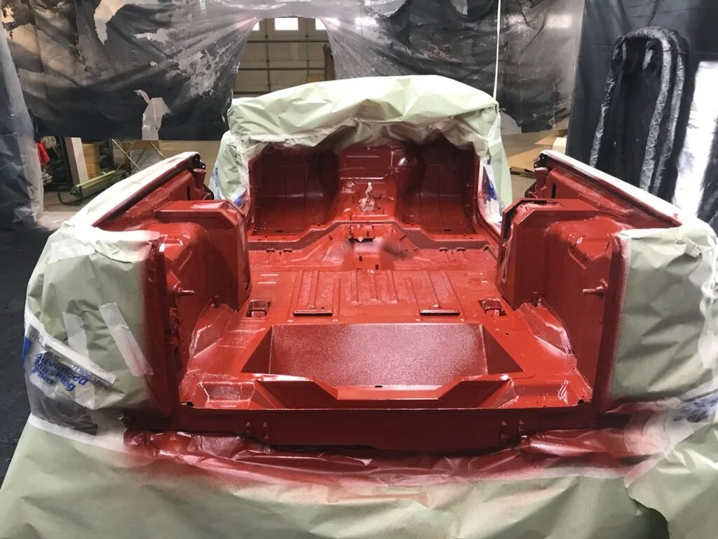

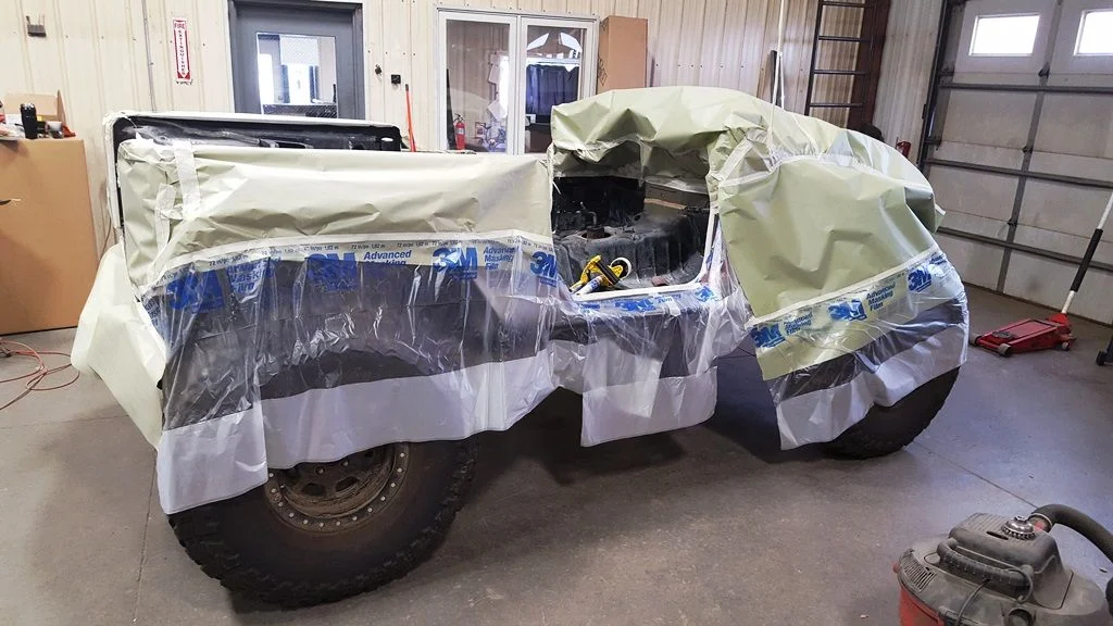

And the Turd's tub's done been prepped for primer and then a coat of Line-X ...

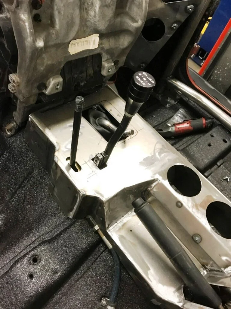

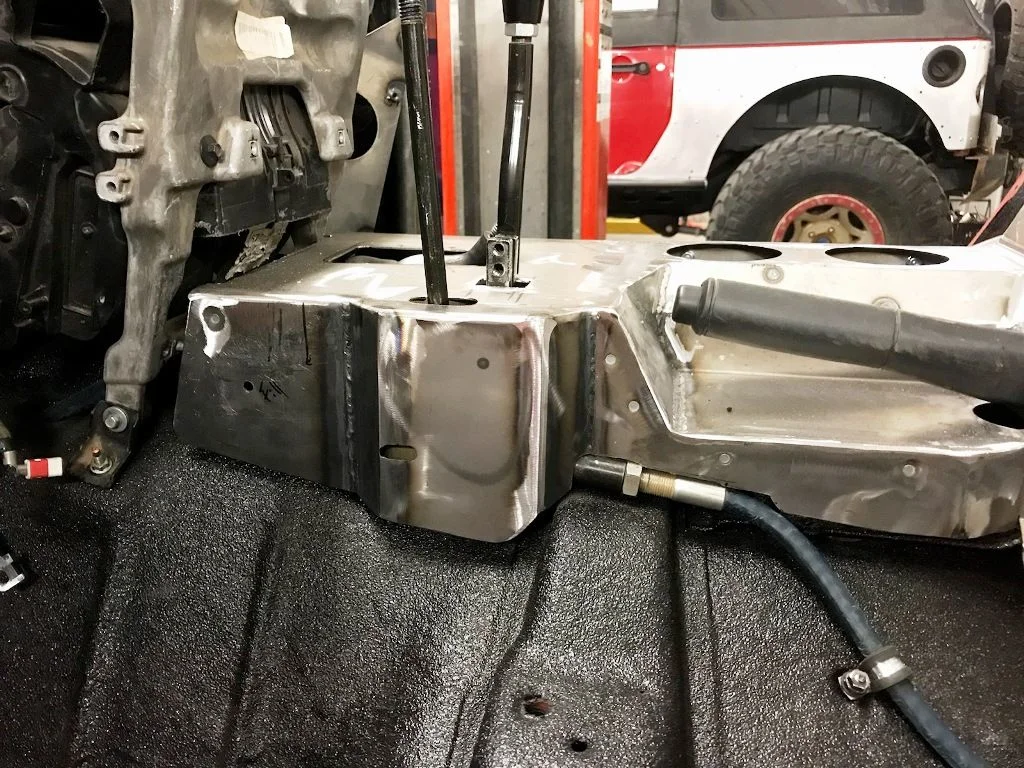

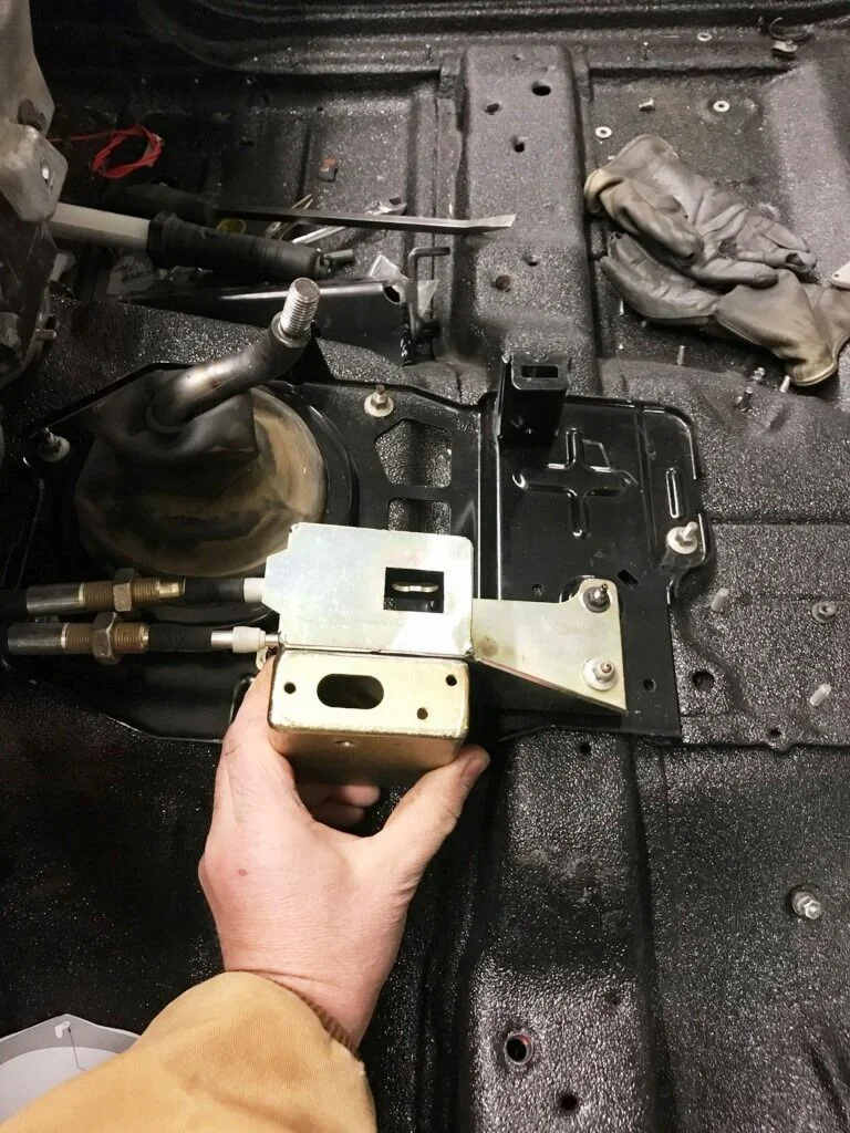

And movin' the third Atlas shifter from underneath the front seat up to be side-by-each with the other two Atlas shifters. Couldn't of reached it under the seat once I actu'ly start wearin' the shoulder harnesses and the move frees up some much needed storage space. Note that the 6-speed shifter handle's done been shortened as well. Try to quicken the shifts a bit on the truck tranny.

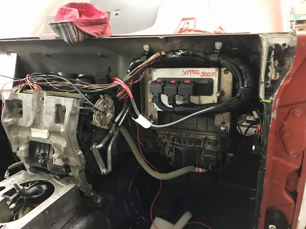

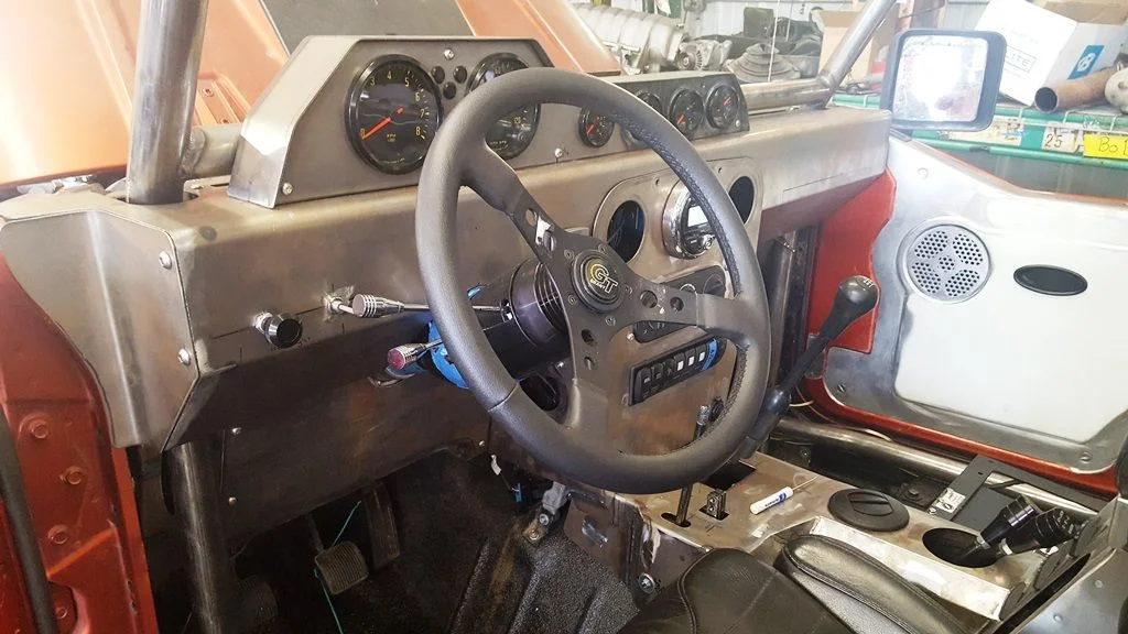

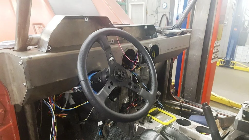

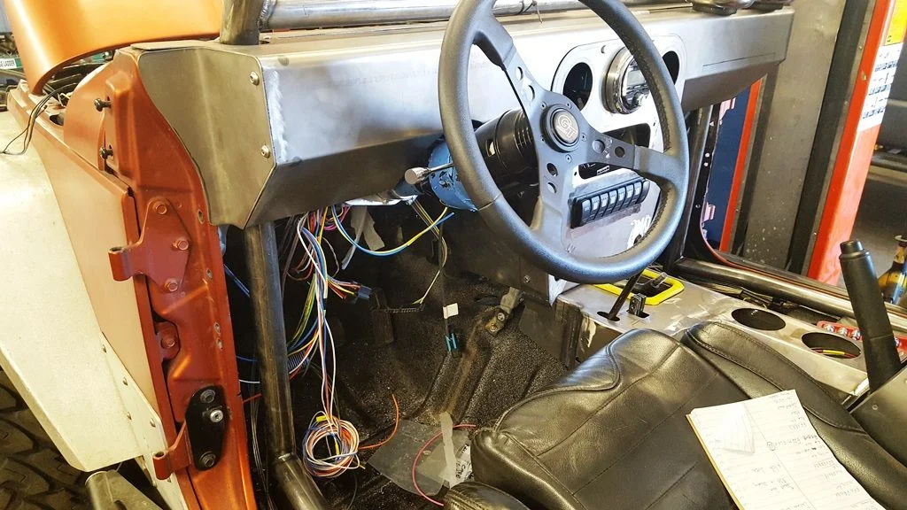

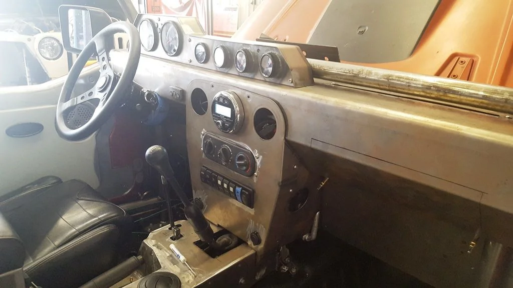

At TNT Customs, the wirin' is startin' to wrap up. Here's the gauge pod actu'ly mounted to the dash. And forgot to mention earlier that the column and steerin' wheel are mine rather than the mock-up ones.

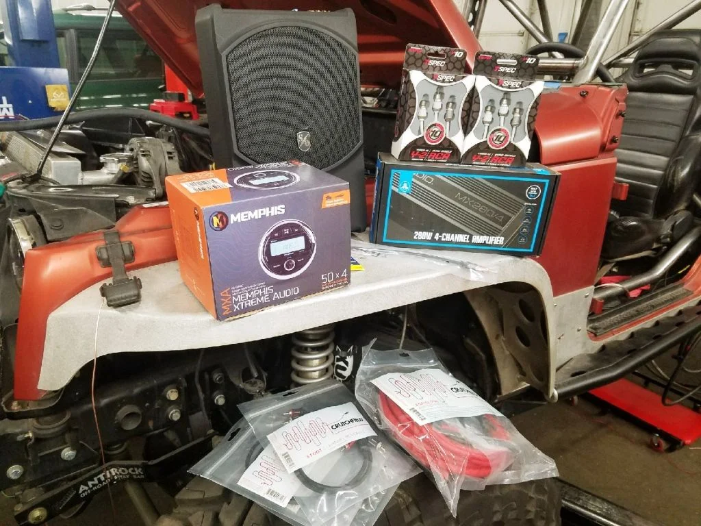

And all the stereo parts have arrived so that's gonna get wired in today.

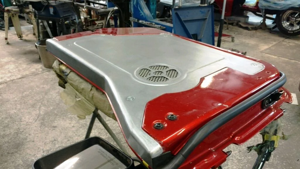

And the sexy new metal version. Check out the way-cool metal covers for the new door speakers ...

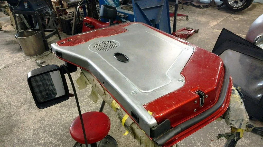

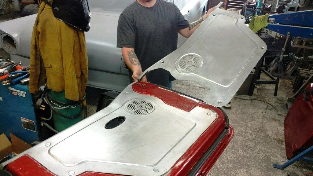

Signature Customs is wrappin' up the lil' doors.
Got a super-sexy interior door handle from Lokar Performance Parts and the mountin' pieces for the fact'ry upper doors. Second panel has already been fabbed and Matt says he'll have 'em both done by the end of today.
Then the doors go back to TNT so the crew can spray the inside of the doors with Line-X to match the rest of the interior.

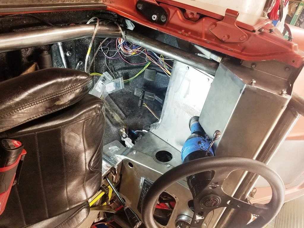

The final piece of the custom dash has been fabbed and installed below the steerin' column.

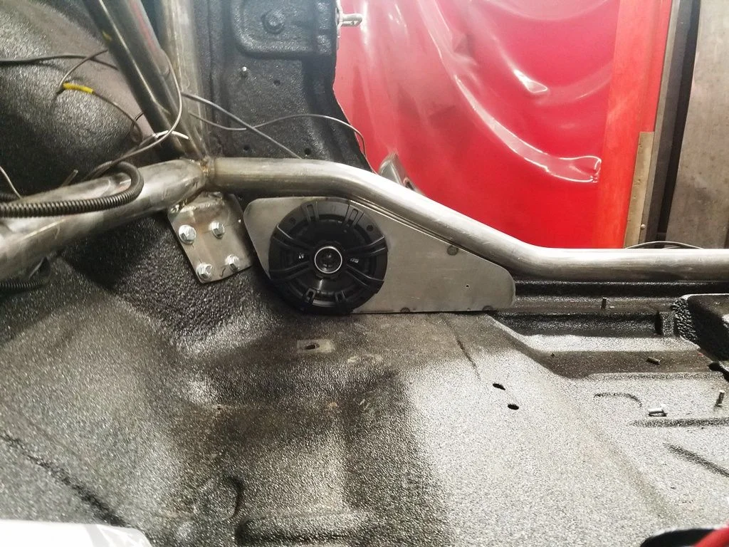

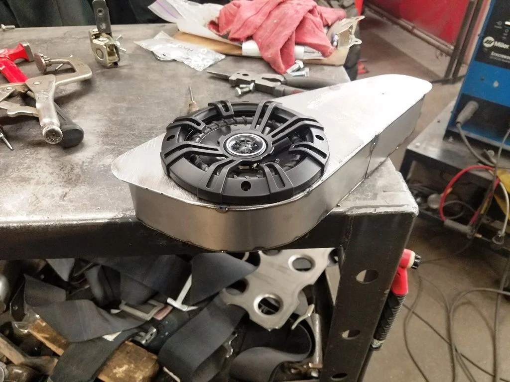

Fabbed up some sweet enclosures for the rear speakers that tuck in tight into the cage.

Reckon it's done been awhile since I posted up some updates. Mainly cuz been kinda slow-go on the Turd. Kraig at TNT Customs was gettin' to his wits end on the 'lectrical crap so last time I was home I told 'im to just step away from it for a week or so. Can't afford no mistakes at this point and I think the delay will pay off in the long run.
Got back on 'er after the holiday weekend tho. He sent me a short video clip Tuesday evenin' of 'im turnin' the key in the steerin' column and the engine started. Video ain't gonna win no academy award but sure meant a lot to me By Gawd. Lots of stuff has to work right for that to happen and she ain't turned over in a really long time. So basic'ly time to start puttin' 'er back together.

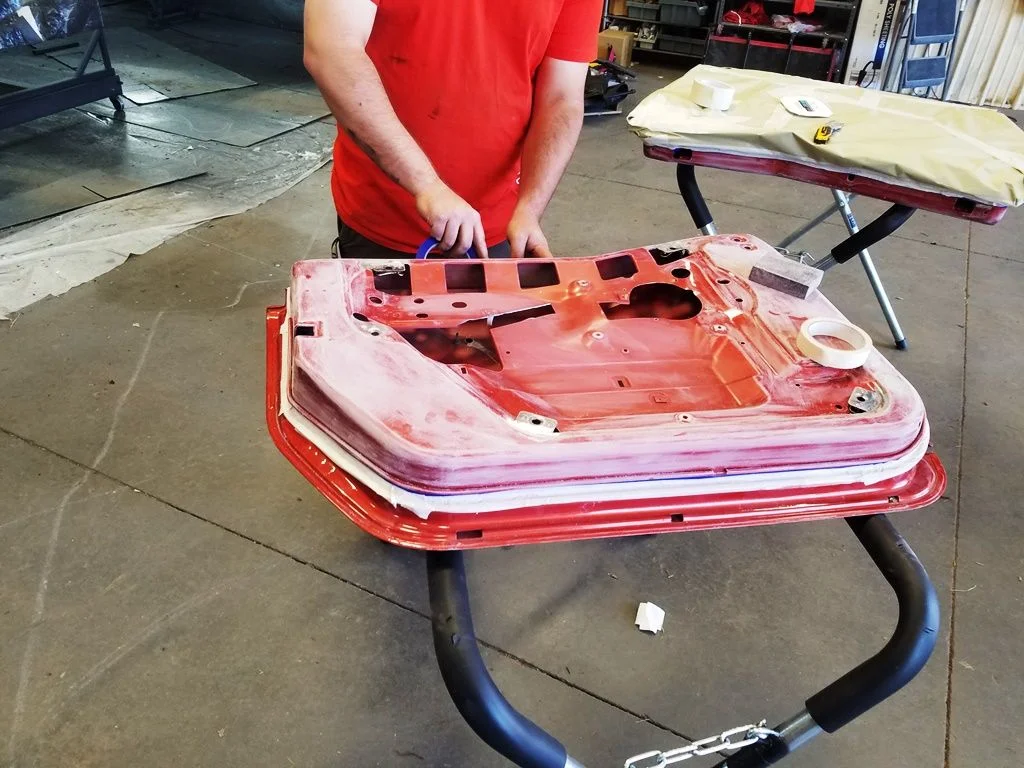

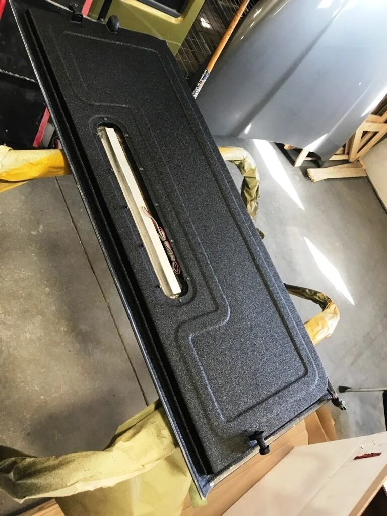

Here's the lil' doors bein' prepped for the Line-X Ultra ...
So they can join the door panels that are already in the spray booth ...

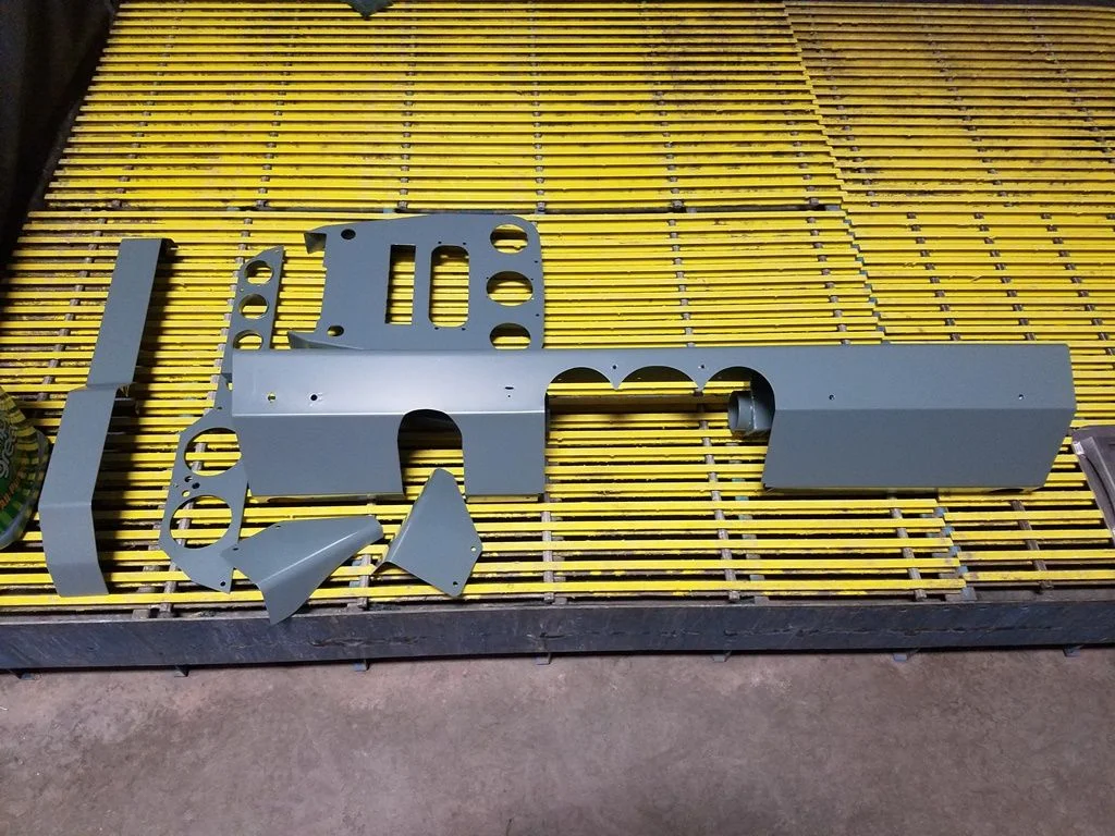

And all the dash pieces done been primered and are ready for the powdercoatin' booth.
