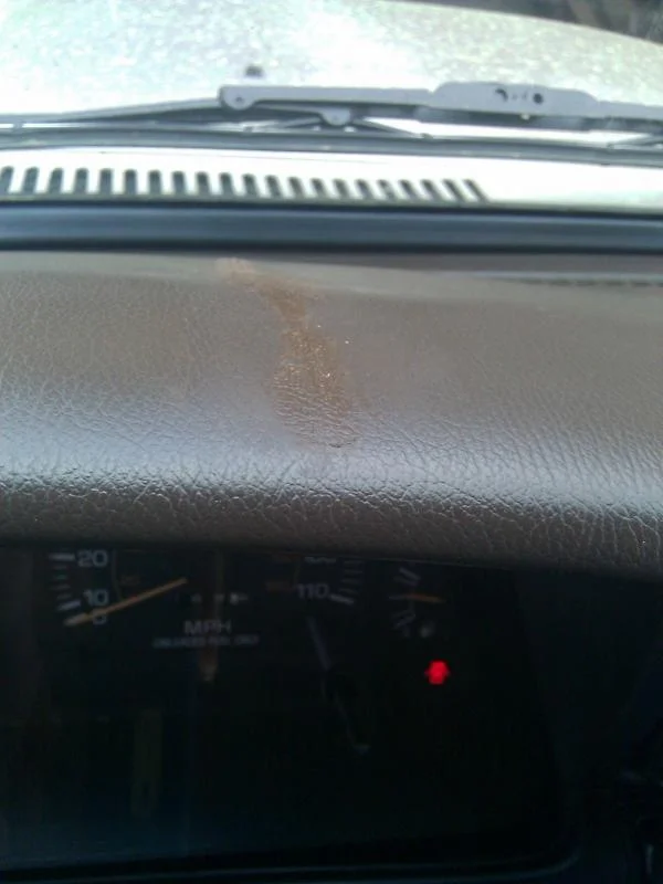

I had a wide crack just above the steering wheel which extended all the way to the windshield and I wanted to repair it, not just fill it. Once repaired I wanted to match the repaired section with a color filler as closely as possible with the dash color.

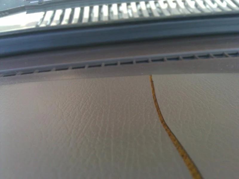

First thing was to trim the crack with a razor blade so that there is absolutely no curling edges. This will allow the repair to blend in with the rest of the dash (no awkward humps).
Next I cleaned the area with alcohol. Then I lined the edges of the crack with painter's tape being careful not to expose any of the dash area near the crack. I also extended the width of the tape double just to make sure I didnt get any adhesive on the dash.
Then I used the "spatula" in the package to fill in the crack. Bad idea. It sucked. I ran to the garage and grabbed my painter's spatula and simply dragged the spatula across the crack with tons of adhesive under the blade so as to fill as I went. If doing this you should work quickly because this stuff dries into gel rather quickly. I found that as I dragged I was also pulling the adhesive out at the other end. ARRGH!:mad:
Finally I was able to fill the crack somewhat to my satisfaction. These pictures are the result of doing the above "without" lining the edges with tape. The next time I did it I didint take pics but it was a much better result and had no residue outside of the cracks.
I let it dry overnight, package said 4 hours. When it dries it shrinks a little which will allow room for the color fill.

Below is my finished product. Its not professional quality but It cost less than $20.00 and the crack is sealed but also somewhat matches the dash.
