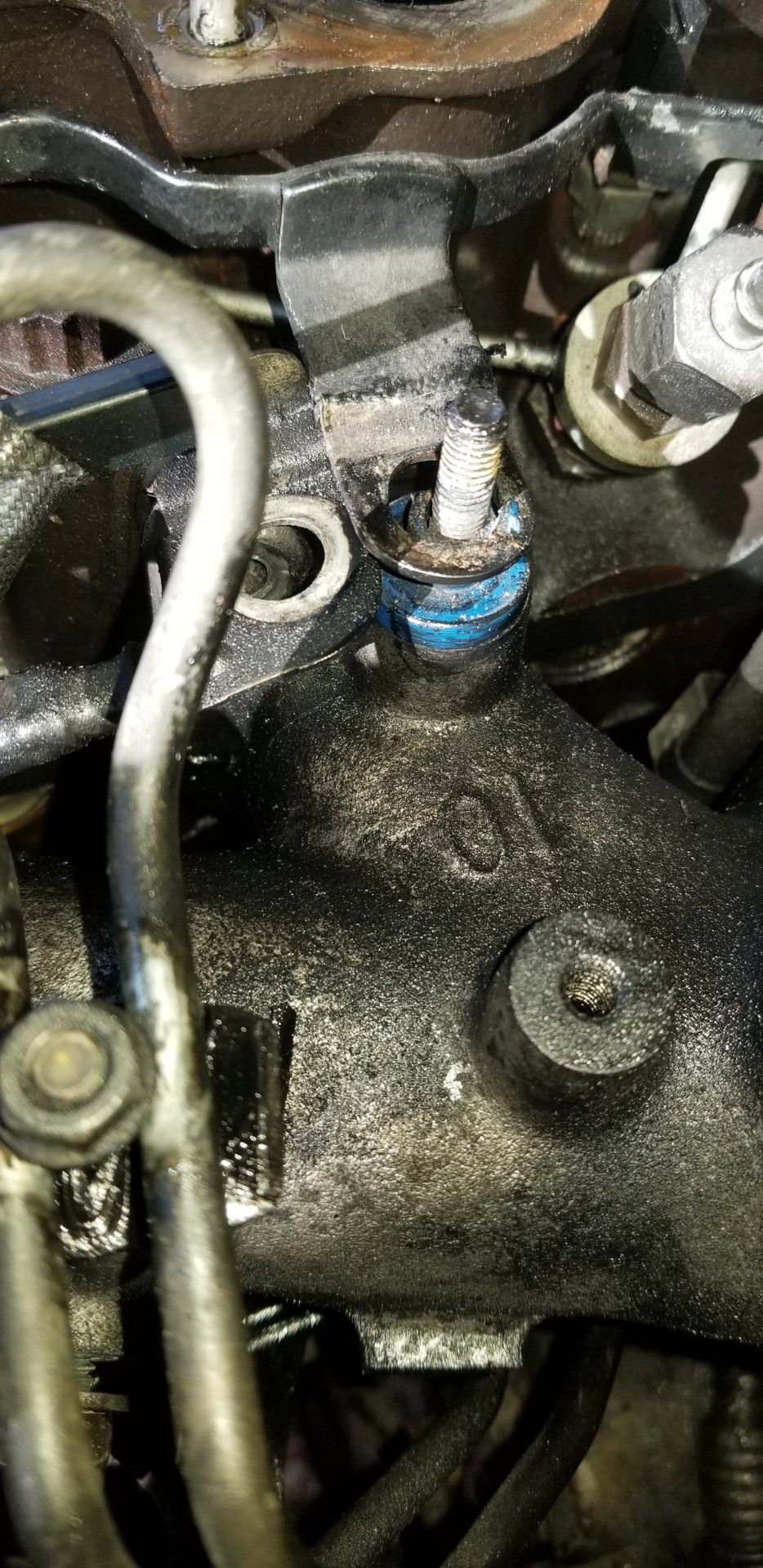

I cant seem to get this stud to drop low enough to come off manifold stud towards firewall
You have to remove your injection lines from the injection pump too. It's a real knuckle scratcher under there....
If you pull the 4 nuts off of the glow plugs that bus bar will lift right off. Just be a little careful with them. The plastic covers will be brittle. Not a catastrophe if you break one, just makes them a little tricky to get off after the plastic crumbles. I suggest a 6 point deep socket and not the slotted head.
And it's definitely a knuckle scratcher down around that pump. Every time I do something down there, I spend a few minutes looking at it trying to talk myself out of whatever is about to make me work down there.
Yeah I figured this out after messing with it for an hour. Never actually took them off though. Just slowly but surely worked the intake towards firewall until i could get front out from in between both sets of fuel lines. I did have to tweak on fuel lines some but after inspection, none of them appear to have been kinked. I would have removed lines from injection pump but never could get them to break loose. Broke my knuckles a couple times. I just need better tools haha.

If you have an open ended 17mm wrench you should have been able to crack the fuel lines off the pump ok. Maybe someone over-tightened them in the past? I think I removed the skirt from the wheel well, turned my tire a certain way and reached in that way to crack the fuel lines. Make sure the wrench is square to the nut and it is much less likely to slip. Start with the lines that are easy to get at, once they're removed you can get to the ones behind.
Bending them is a bad idea. They might bend one way ok, but when you bend them back at reassembly they get really weakened and there is a chance they can crack. There is 2200psi in there.... If you bent them a lot, I'd be looking for some spares on ebay asap.....
Yeah I could never get the 17mm nut to budge. It did however loosen up where it enters the injection pump. Tightened that back and left it alone. I'll have it back together Saturday and check for leaks.
Ouch! Yeah, someone definitely WAY over-torqued those!
Knowing my luck it will probably leak there now lol. I'm looking online for hard lines just in case I f'd up and did damage them. Havent found any yet.
