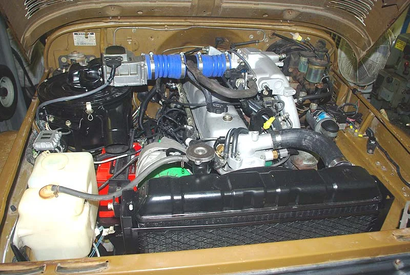

My Boy Blue - 1973 w/ 3FE + Cruise Control
On Rootbeer, we used the stock air filter can from the FJ62, but it's a 2FE, close to the same?
attachment.php
Did you change the diameter of your fuel lines? I am working out my fuel line plan and am concerned about fuel volume through the stock 40 hardlines.
Also, how did you hook up to the fuel filter. Are you running the stock filter or aftermarket?
Stock fuel lines. The filter and pump are attached to the frame under the fuel tank.
