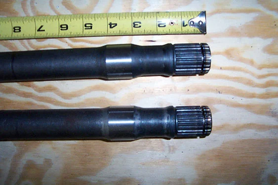

Quick question about the inner axles: in slide 21 you mention that "careful inspection of the axle diameter reveals we're relatively screwed -- we need new inner axles --" what, exactly, failed the inspection? Is is the groove, or did you mic the OD and determine it's out of spec? My axles have grooves in them where the inner axle seal rides, look like the one in the picture... they're supposed to have grooves, right?

negative on the grooves! That should be one smooth surface. I've never read of any spec on what's exceptable but it looked to me to be almost 1mm deep. I'd have to beleive that was too much.
thanks Rick- so then I take it a new inner axle doesn't have any groove in it at all? Mine aren't 1mm deep, but half of that for sure... what's a new inner axle cost, anyway? And if it's not too much of a hijack, anyone have experience "sleeving" an axle? Is that a viable alternative to replacing the things? damn, just when I thought my front end was good to go for a while... :censor:
Just to give you an idea.
Bill

Sorry to disappoint you, but those are yours!
Bill
