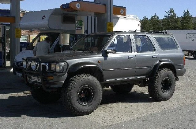

Build My Bad 91 Runner on 39.5's (should have got 42's)

Been a while, have done a few things now. Built my allpro in-cab cage, have to paint it before installing, got the allpro rear bumper which I had to shorten, installed my duals today on the allpro triple crossmember and a new ome clutch.
swapping my interior for a Grey one, but the dash i rhd so that will still be red...
swapped some lights for an additional arb locker, but might go for aussies front also. Tired of not getting my arb to unlock... easier to have autos...
Go Aussie, you wont regret it! I drive mine around 50miles a day, if not more and its never been more enjoyable. They have virtually no draw backs!
Got the first drive shaft! Front one, with allpro long slip kit... The rear one is in the mail, hope to get it before the weekend.
Getting started tomorrow on swapping interiors, got my donor truck yesterday. Grey... had the original cd-cassette dual din player also. Might try to install this one too, hope it works! Also since the truck is rhd it has no rear heater so I don`t need so much adjustment to the arm rest case.
Test drove it, feels reel good with the duals. The allpro triple crossmember makes allot of vibrations but thats how it goes when I do not do my homework up front!
