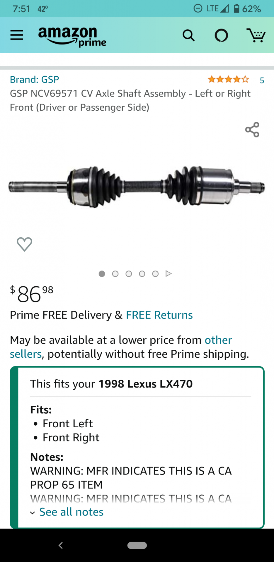

A little over 10,000 miles ago I had an upper ball joint let loose and take my cv axle with it. It had a crappy aftermarket tri-lobe cv.
I am not one to "drink the Kool Aid" and just do like everyone else and go with the $500 OEM cvs just because the internet says so. I looked around and found a cv axle on Amazon for around 80 bucks so I figured I would give it a try.
My truck is a 1998 LX 470 with AHC, Japan 4x4 spacers, 80 series rear springs, and a sensor lift. Needless to say I don't sit at stock height and have no diff drop so my axle angles are way off of where they should be.
The axles I found are made by GSP in China. They are the Rzeppa type. I have had zero issues with these axles, no vibration, or anything.
The first axle I paid full price for. I went back to Amazon about a month later to buy a spare and found a "Warehouse Deal" for $28 so I picked it up. Ended up putting that axle in another LX for someone else so I looked again and found another deal for $12. A couple of weeks ago I decided to cut the clamp off of the boot to have a look at the inside. I found a lot of grease and a Rzeppa joint. I checked Amazon again and they had 2 deals listed, one for $12 and the other for $8. I bought both. The $8 axle was delivered and had 2 in the box. So now I have 4 spares. There has been nothing wrong with the axles I have bought other than the boxes being trashed.
This is just my experience, others may be different. I have had great luck and have not heard of any problems from the other one I helped install.

Here is a screenshot of the listing on Amazon:
