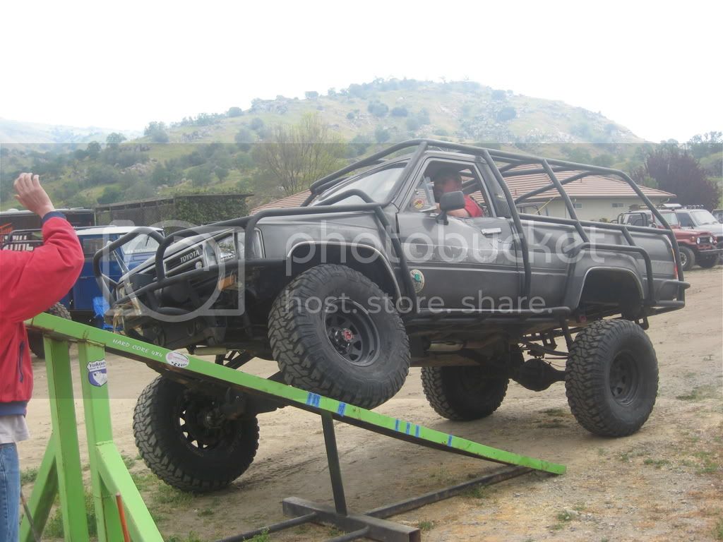

After years of wheeling in a fullsize truck I decided to down size.I have a family so my 86 4runner is what I got.After driving it for a couple of years with 3" body lift and some 31's. I decided to go with some 33-10.50-15 and some 488's an air locker and a lock right up front had it like that for a couple years.
In May of last year the project started pulled it in the garage and cut the front ifs out and went to town. I don't have any pics of the build :frown: but have a bunch after the build.It took from Memorial to Labor day weekend to build, with four nights of going to bed when the sun was coming up. The neghbors just love me :D .It took me a lot longer then what I expected with a new baby and work not much time to realy work on it.Oh ya forgot after working al day in 100+ temps the last thing I wanted to do was sit in the 100+ degree garage with a torch and welder. So like I said alot of late nights. This is the ending project wel not end just yet still have other things I want to do with it. I have some rock sliders,rock ram that will go on in the next month.
Then one shot with it on the 39.5's
Heres what I have done to it. 5" springs fr and rr,529's /air lockers fr and rr,30 spline Longfeild's,hy steer w/six stud knuckle's,14" hoops w/14" travel shocks up fr and 12" travel mx6 shocks in the rr.The motor is stock the trans is stock it has dual cases both rebuilt w/2.28's in the fr and 4.7's in the rr case and heavy duty skid plate for the cases. All my parts are from Trail Gear exept the mx6's they are from my garage. It sits on 36-14.50-15 TSL radial Super Swamper mounted on A/E 0589 wheels.I have a set of Pro Comp wheels that are waiting for bead locks. Also I what to build an exo cage for it and a good interior cage that covers my little one.
I will put up more pics as it go's along with some more parts added on and some action shots.

I had a friend that did a full exo. It was nice and al but the only thing I didn't like was the bars you have to run from one side to the other. Also he cut the top for the bars to go through and lost a lot of room for some losing the room isn't a big deal but for me it is.
So if I do an exo and an inner then I wont lose any room.
Because I can use short peices to tie the to together to make it sturdy. That so the sides bars have the support they need when you lay them against something. Thats why I want to do an inner and out cage.
Also started my rock sliders today :clap:.
Very cool looking Runner...little advice from experience. If you exo it make sure you put flanges so you can remove the cage. Mine isn't and i really makes working on some things tough. And really the only cross bar that gets in the way is the one across the bottom of the windshield. But you could probably run that through the engine compartmen and have it come out through the fenders.
