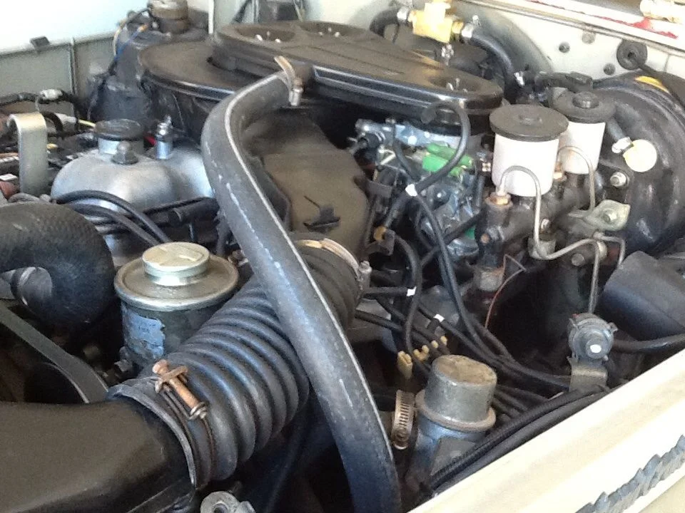

  • installed carb on Thursday
  • Replaced all hoses on Thursday and fired it up - it actually ran at 450 rpm, without dying - never would befor
  • Reinstalled Air Cleaner on Friday, adjusted the idle to 650 rpm and fired it up - always starts on first turn of key - hot or cold - now runs consistently at 650 rpm, with 18 inches of vacuum! Excellent job, Jim!!
  • Drained oil and dropped the oil pan (to replace the gasket I screwed up the first time) on Saturday - this job, I HATE!!
  • Replaced Fuel Pump on Saturday - nothing wrong with the old pump, just looked really old.
44 is really running well!! Thanks Jim!!

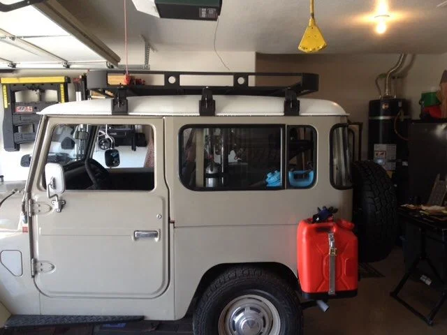

  • Took the rack to Jose, at JOJ Welding and had three 1/4 x 2" crossbars welded on to Make the rack wide enough to accommodate the gutter mounts and mount to 44
  • Cut and rounded the ends of the new crosspieces, cut slots for the gutter mount bolts.
  • Took rack to Custom Powder Coating to have it sandblasted and powder coated for $240
  • Installed the rack and (great news!!) I can leave it mounted on 44 and still get into the garage with 4" clearance!!

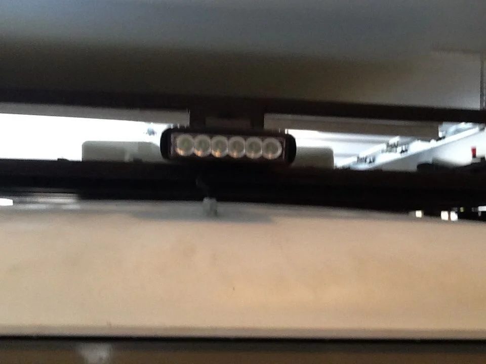

  • Installed 2 LED lights on the front bumper and an LED work bar light on the back of the rack - both switched from toggles on the dash.

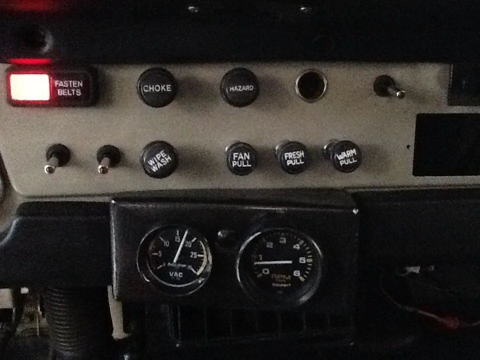

  • Built a two-gauge cluster from 26ga sheet metal and mounted a tach and a vacuum gauge on the dash, over the radio hole - love being able to see rpm sand inches of vacuum, while I drive!
  • Couldn't get the carb cooling fan to work, so I bypassed it and installed a manual timer (no room on dash, installed it on the firewall, behind the pedal) - thanks "someone on MUD - sorry, I don't recall who's idea this was...

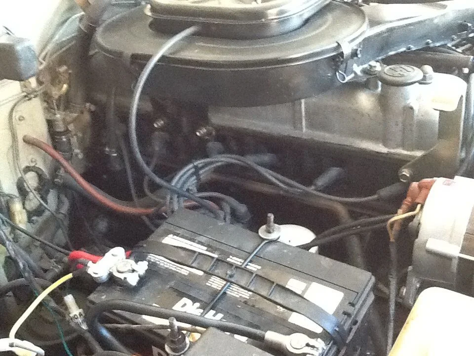

Carb installed - new hoses
Passenger side - back end of new alternator - can't shoot GR Starter

Rear work light - again, best pic I can take right now

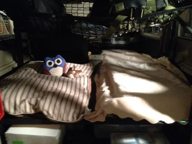

The next order of business was a sleeping platform (for those simple overnights - no need to pitch a tent). I removed the passenger seat back and ripped a sheet of 5/8" plywood to two 24" widths and cut the length to reach just past the front of the passenger seat bottom. I laid the doubled plywood in place and found that the front seat bottom is exactly the same height as the rear platform I previously installed.
So, I then shaved the front of the doubled-plywood into a 'sorta' ironing board shape (to allow access to the transfer case gear shift on the driver's side and to allow the passenger door to close) and placed it back in 44 and covered it with a Harbor Freight moving pad, laid my sleeping pad on top and covered it with an old bed spread and placed Gunner's bed on the back platform (next to me - my sleeping bag (and backpack)) travel in the cargo netting above it) and we now have a travelling apartment!!

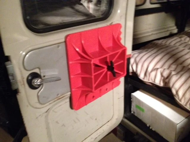

Now, I needed a new place to carry my Hi-Lift jack base, so I set it up on the driver's side, back door - here:
