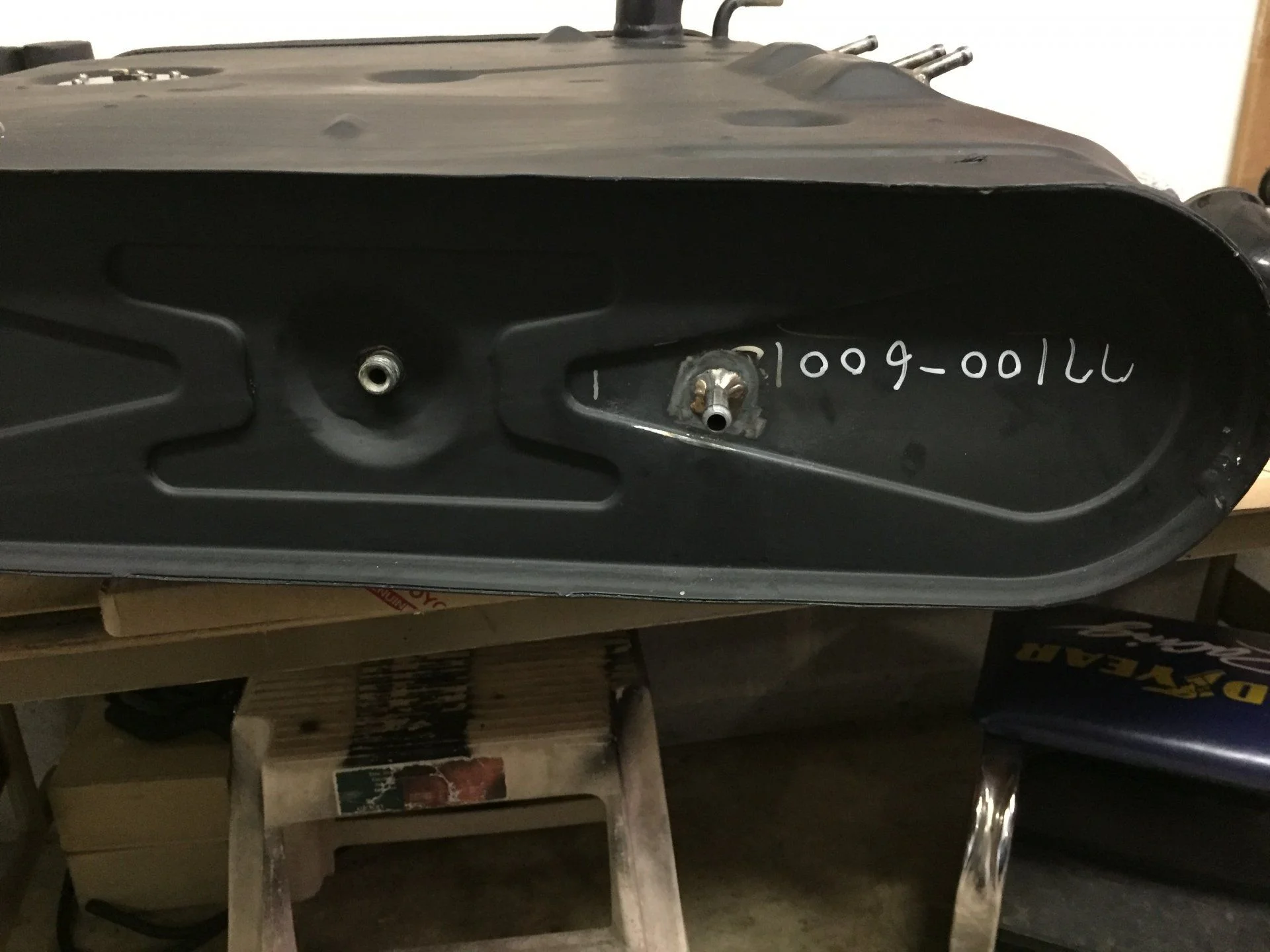

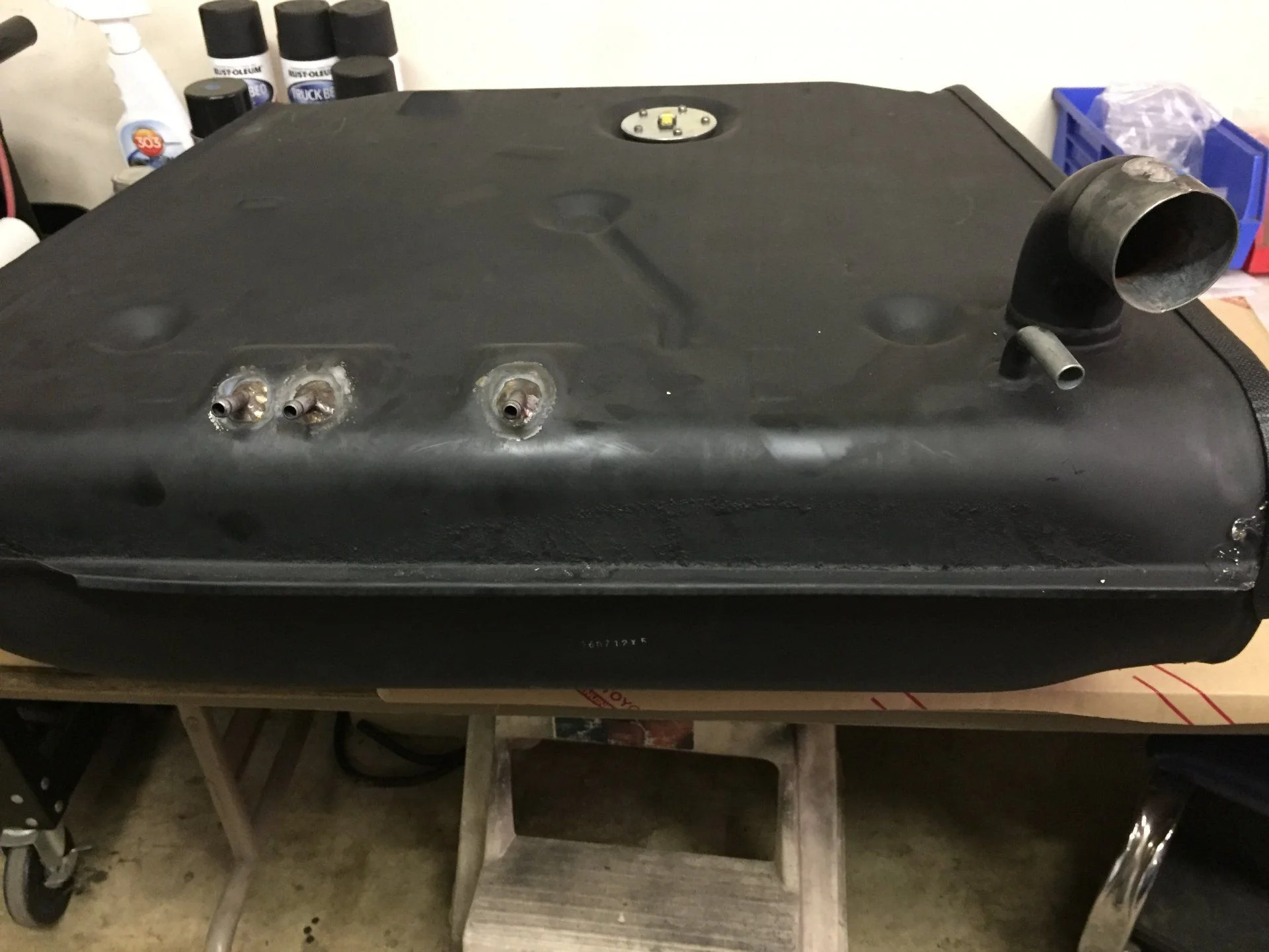

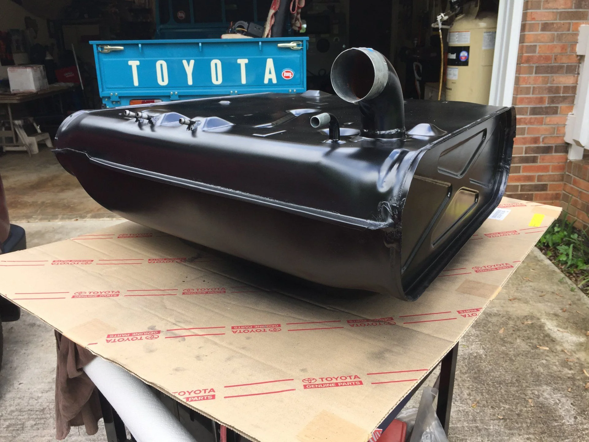

I picked up my fuel cell from the machine shop this afternoon. It needs a little paint but overall I'm pleased with my new FJ45 tank.

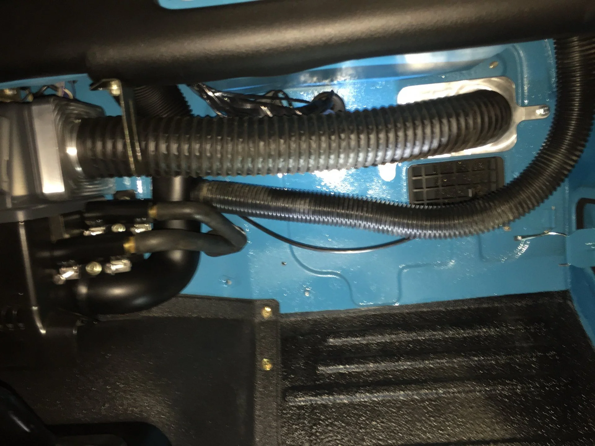

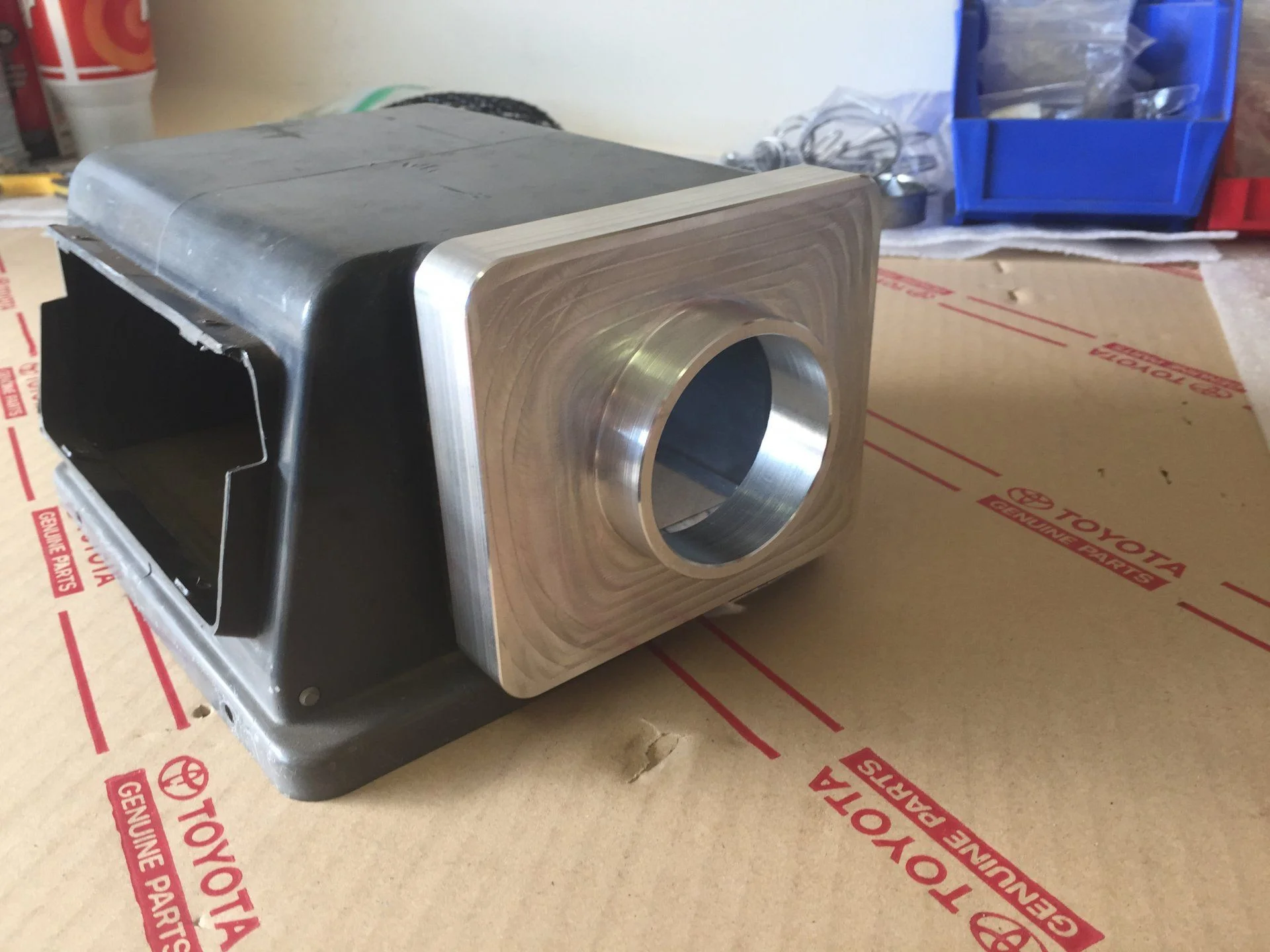

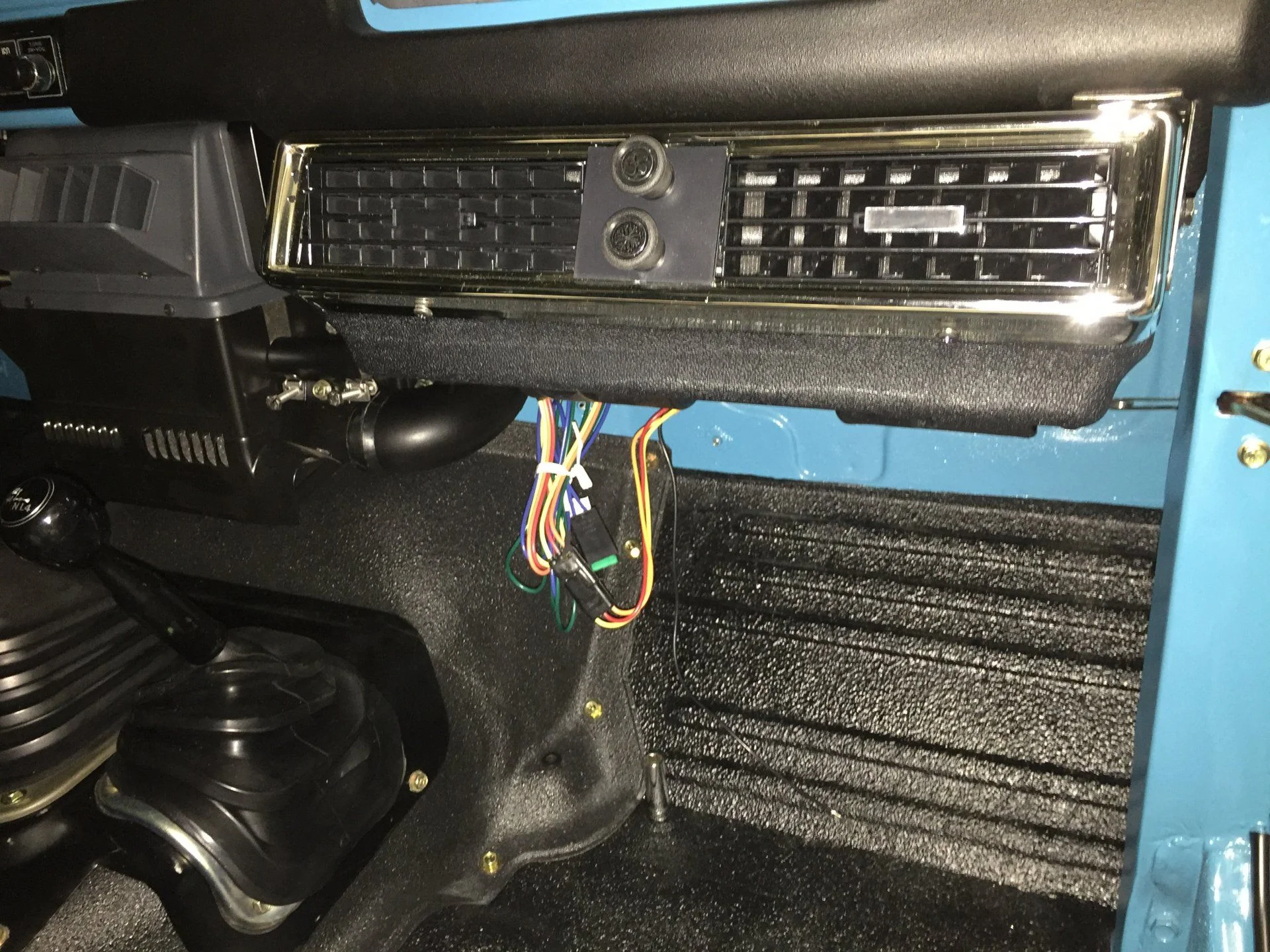

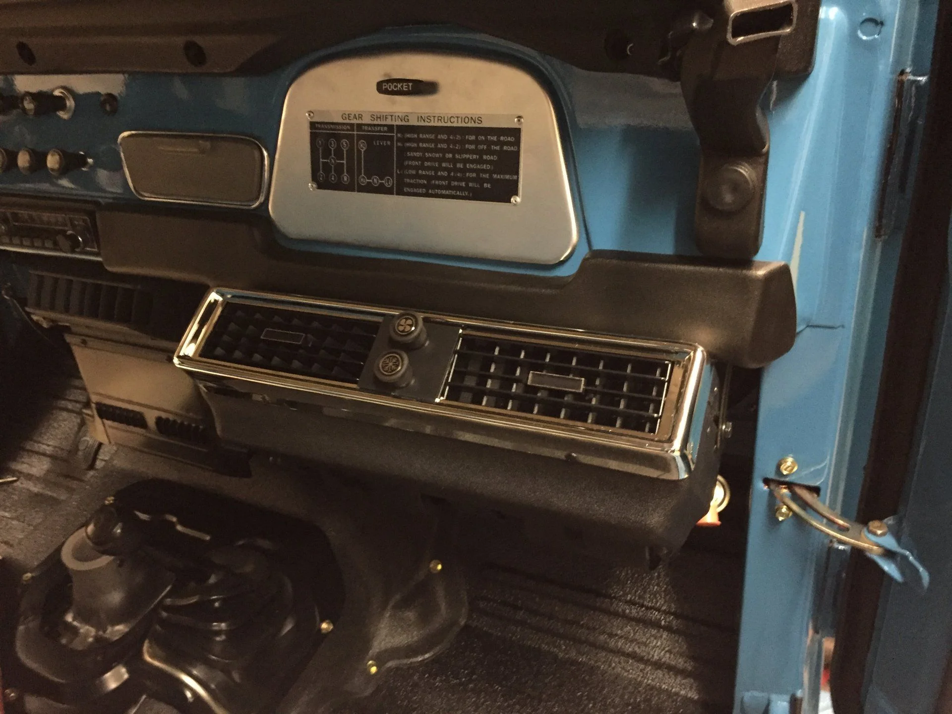

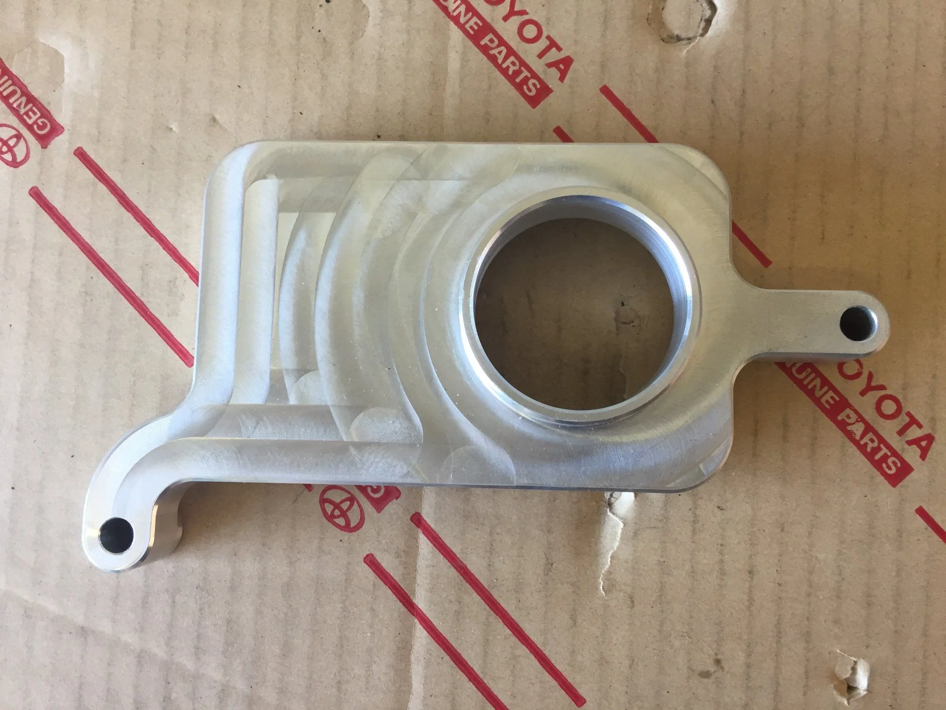

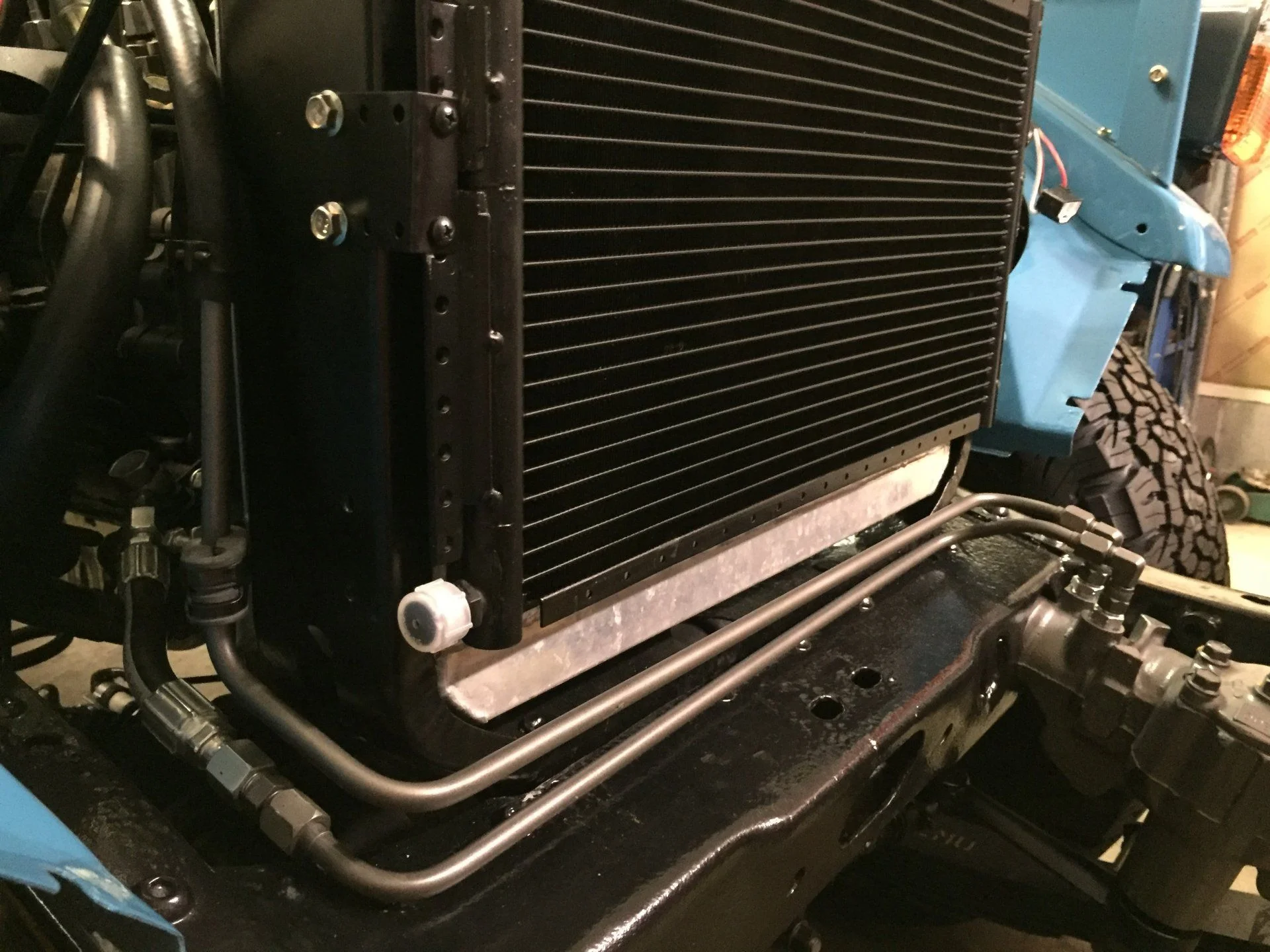

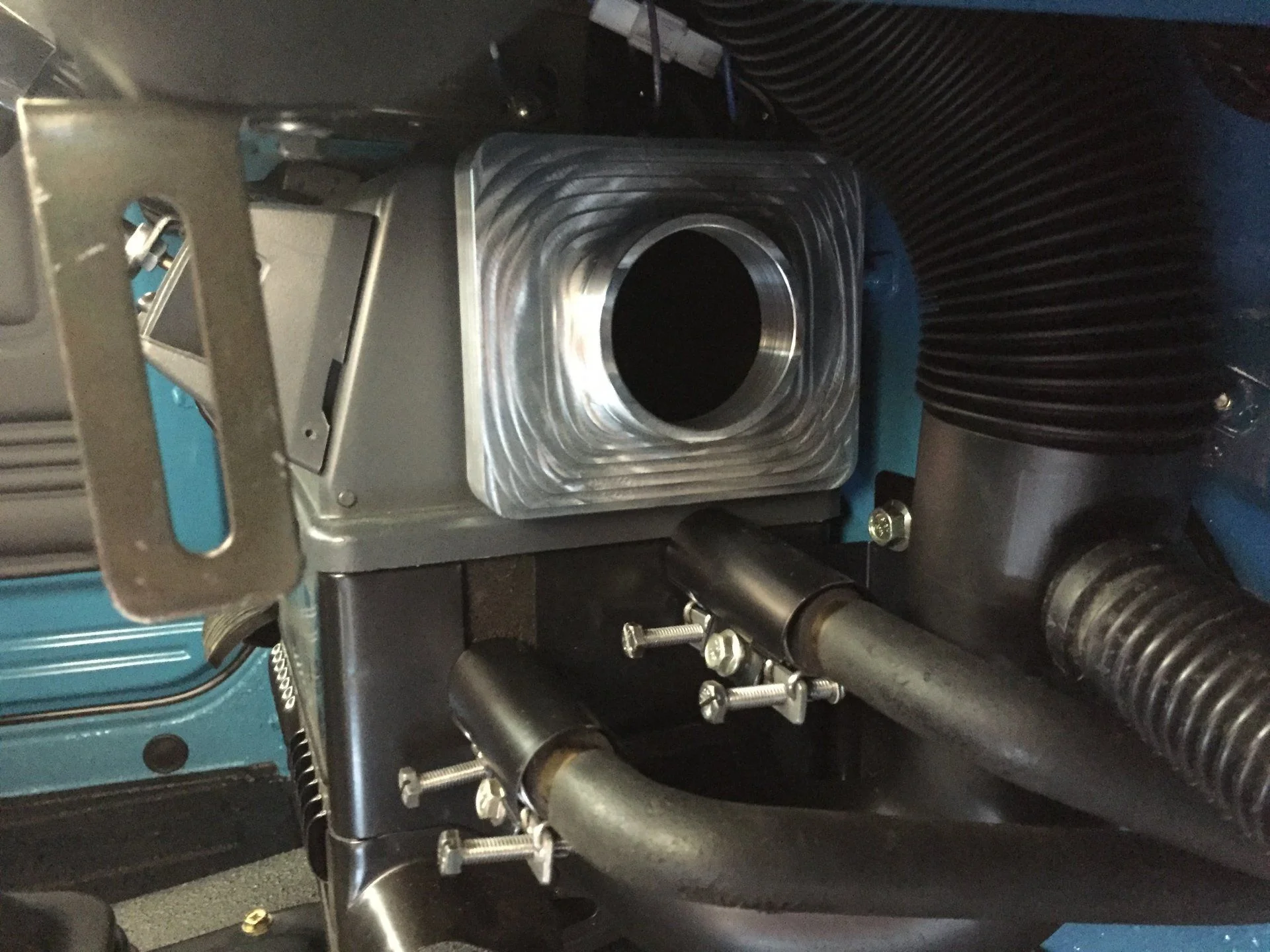

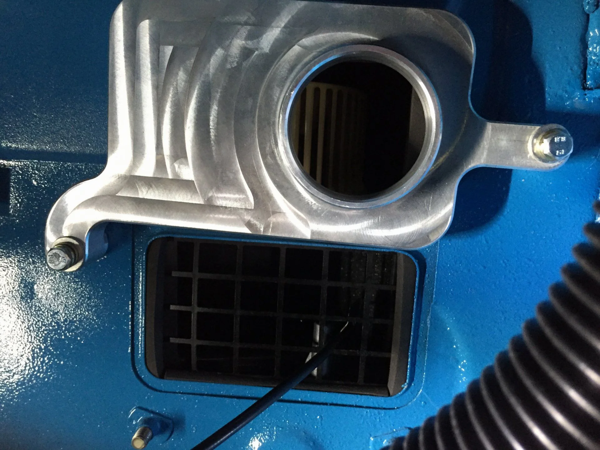

I have been working on a couple of items this week. The first is PS lines. That installation is almost complete. The second is a replacement for the heater air box duct. In the pictures they are still raw aluminum. Which is great for illustrative purposes. They will be painted satin black for final install. This mod will allow the AC unit to rotate up in the back.

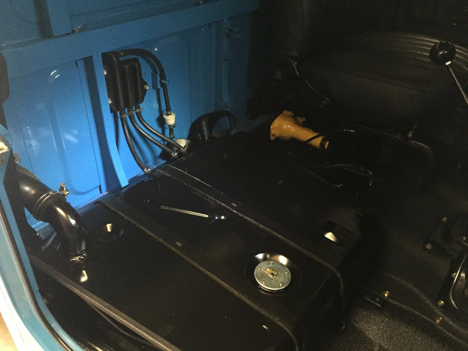

Well not much to show but I made some progress on wrapping this thing up.
Filled the PS system
Filled the cooling system
Filled the WS washing system
Connected, filled and bled fuel system
Connected starter

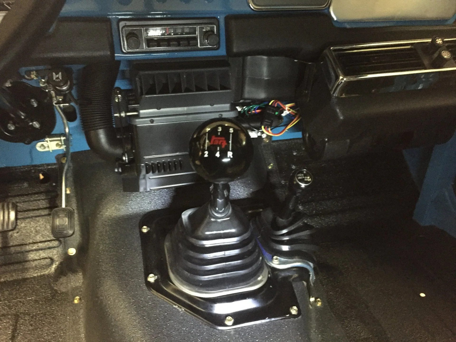

Reinstalled the AC head unit
You can see the difference in the back of the unit in these pictures.

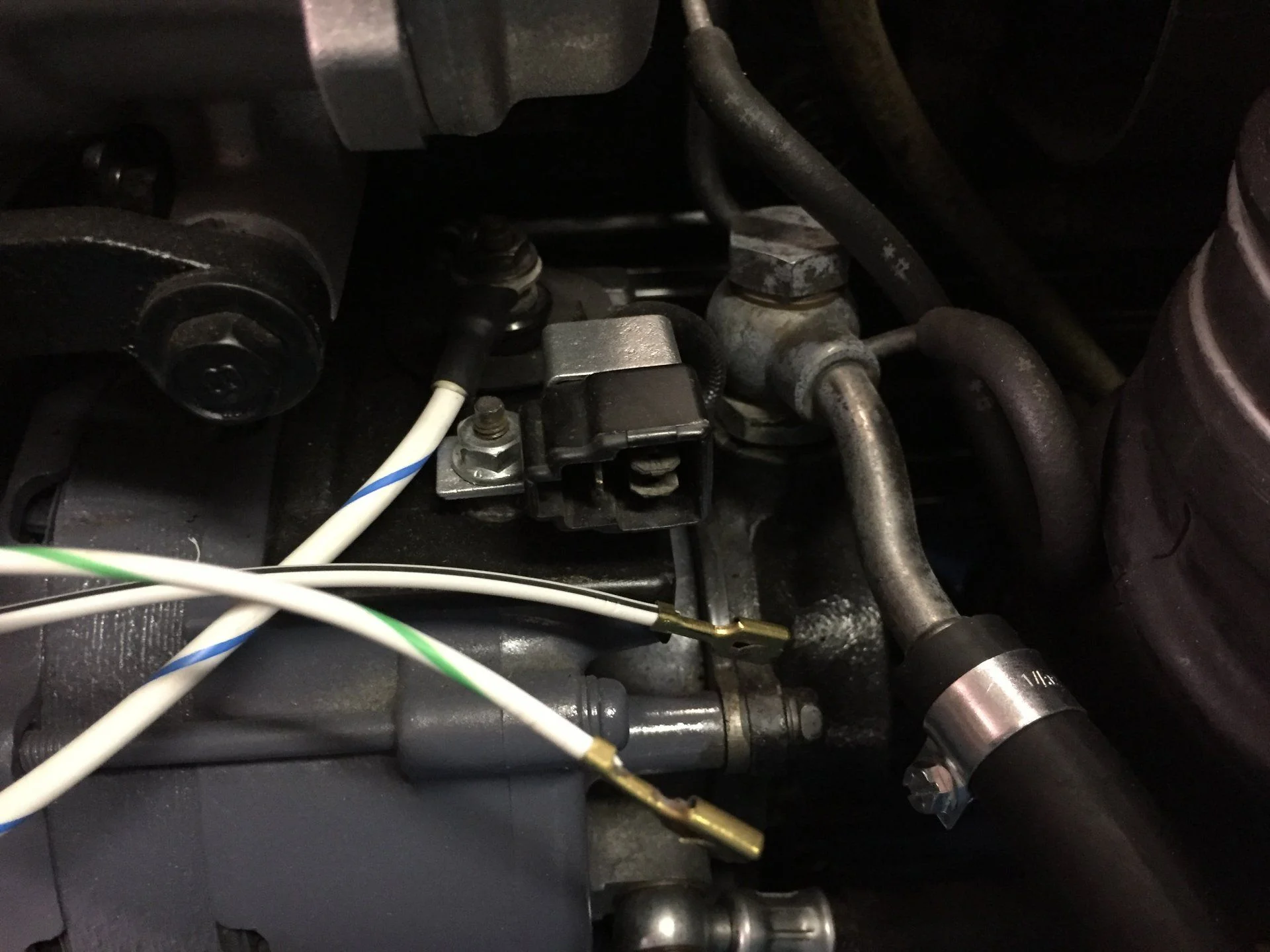

If anyone can tell me how this wiring is supposed to be connected I'd appreciate it very much. (12v externally regulated)

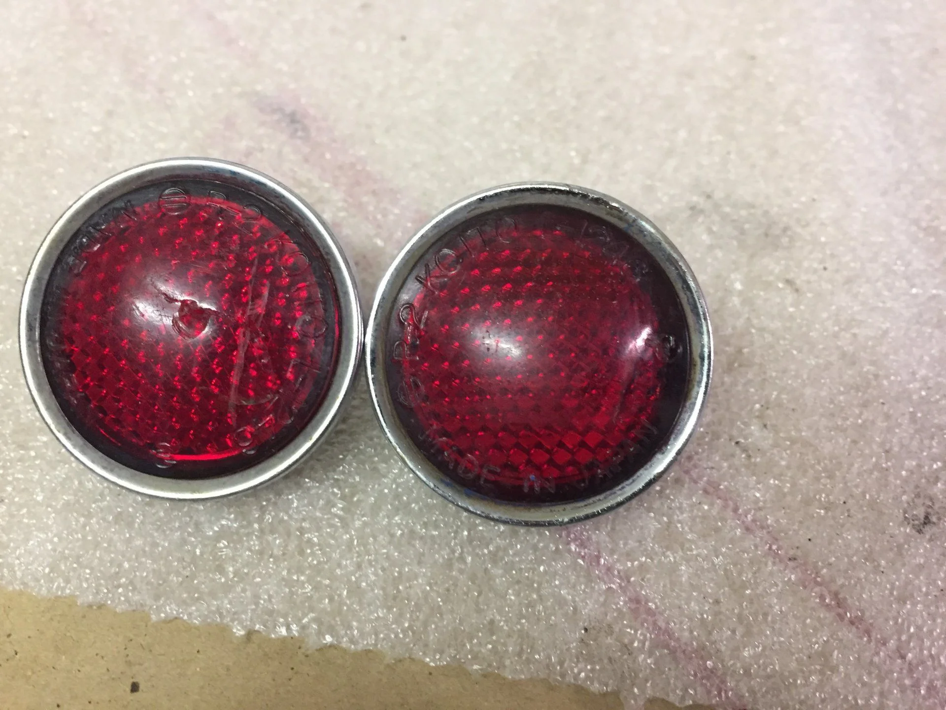

Hey @cult45 look what I dug out of the parts bin. I need to polish the lenses a little but the rest of it cleaned up right nice! I do wish I had taken a before picture. They had two different colors of paint on them.

do you still need to know where those wires attach? i could help if you need.

Thank you for the kind words of encouragement. I think I have the alternator wiring sorted out. But if you have a good picture of what it should look like, I would certainly appreciate the sanity check. With a complete new wiring harness I sure don't want to singe it right out of the gate.

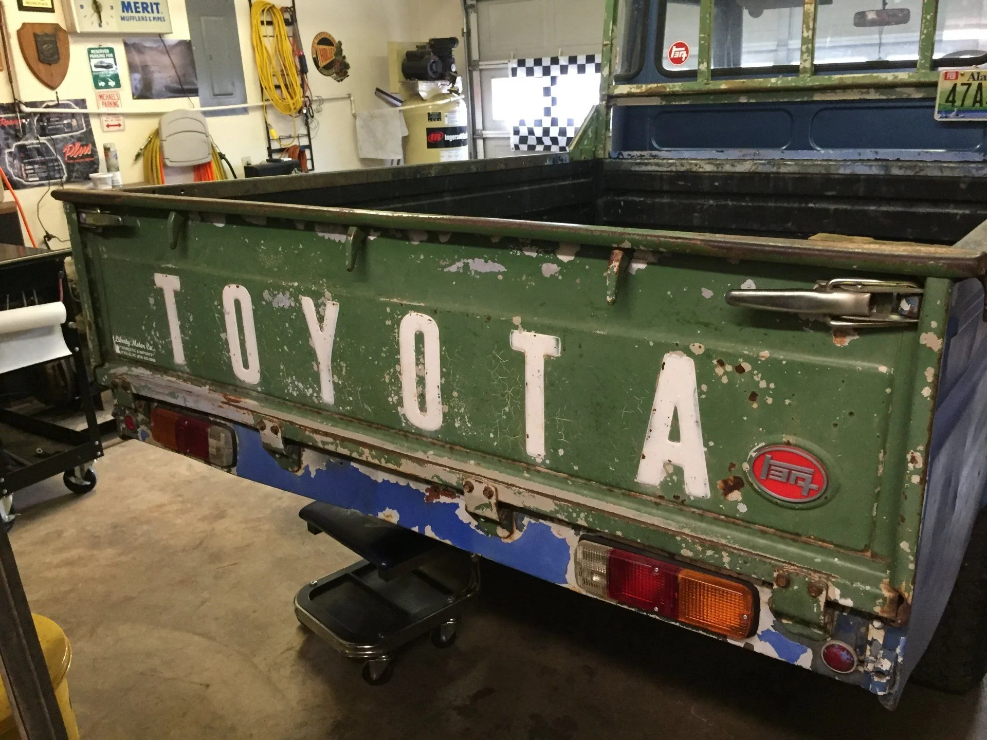

Where do they go mate? On the tray??
Dan here is a picture of them in place before the tear apart.
