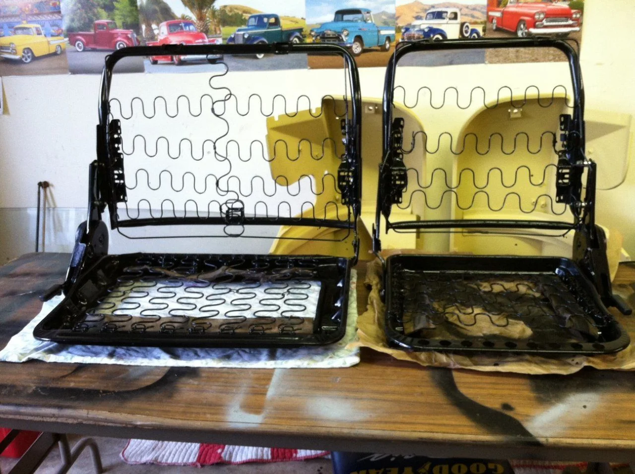

I finally have my seat conversion complete. I now have a LHD FJ45 seat frame. Off to the upholstery shop!

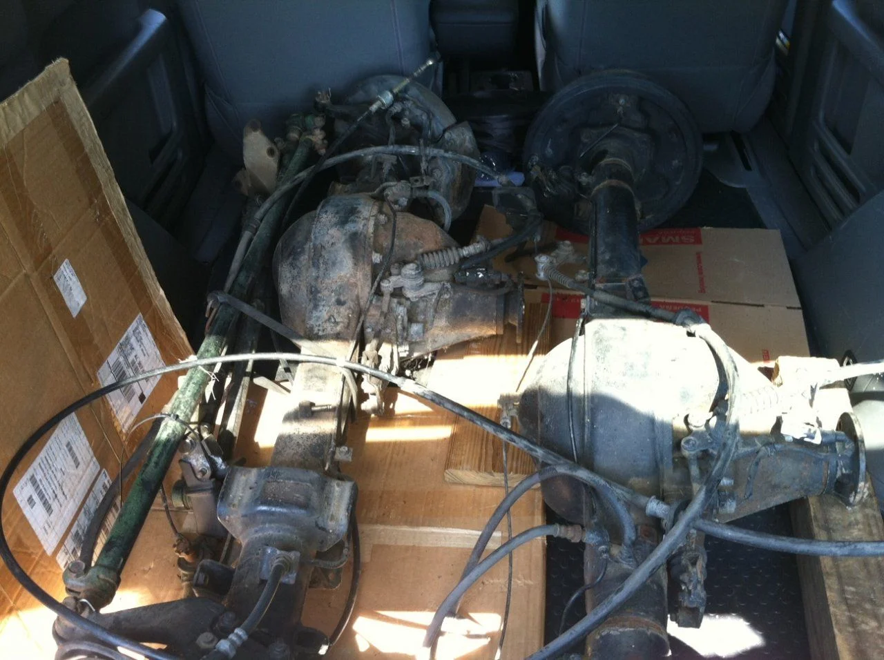

Well 28 hours 10 mins + 1579 miles = a pair of 70 cable locked, FF axles with disks and parking brake! I think I'm getting to old for these Iron man solo runs! But I made some new friends. Joe Katana supplied the axles (for a minor fee) and I dropped by Old Air Products while I was in the neighbor hood (Dallas) and picked up my AC unit for the 45. In case your wondering what I hauled them in, it is my 2010 Honda Element (aka Red Ryder). I only got 28 mpg and I didn't even have to move the seats forward. Included with my 45 and my S2000, the Element is one of my personal top 3 favorite vehicle I have ever owned.
