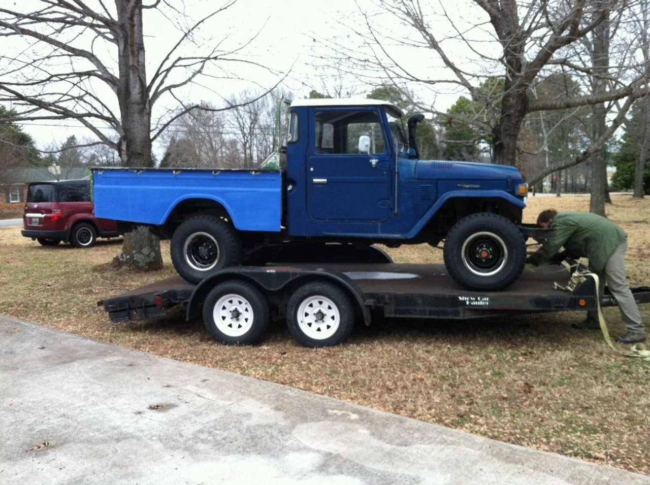

Heading to the muffler shop. For those who know him that is Roma strapping the 45 down and the oil slick in the trailer is from a FJ62 he drug home last night, not my 45! :santa:

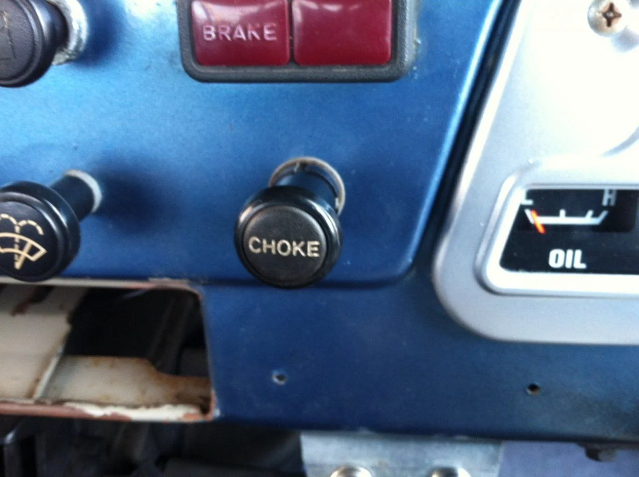

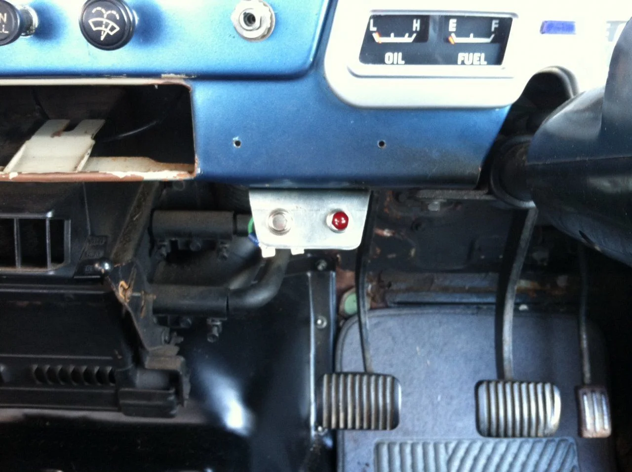

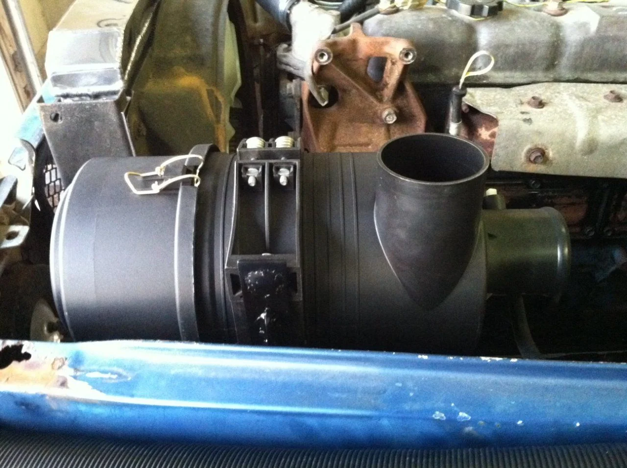

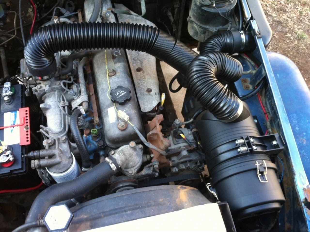

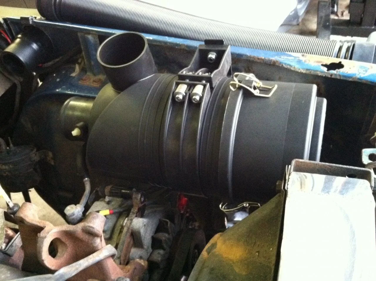

Pictures of the Choke cable I'm using for a fuel shut off, the glow switch and indicator and the snorkel/air box plumbing.

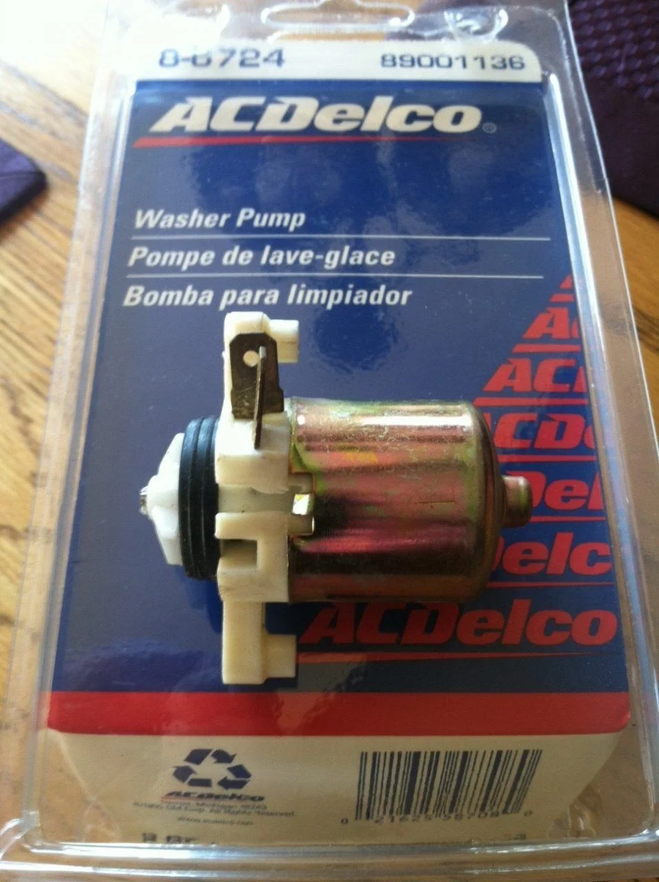

I found a new windshield washer pump. These seem to be hard to find and expensive when you do. I think these will also work for FJ60's as well. I ordered it from Rockauto.com. It was $23.00 shipped.

Looks good. Let us know how that windshield washer pump fits and any adjustments needed.
Bear it installed just like it was original! No adjusting or tweaking required.

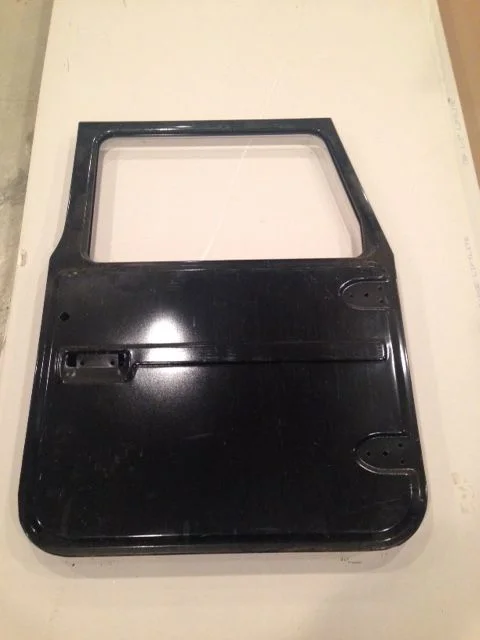

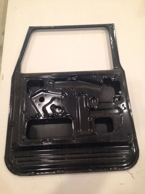

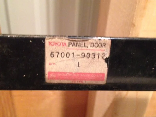

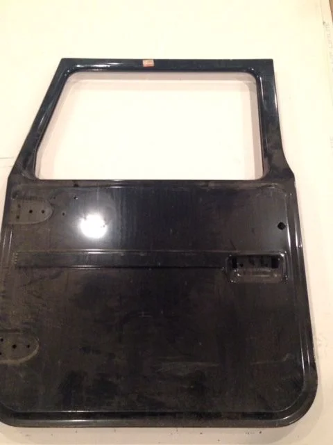

I have been busy buying more parts. I finally found the windshield frame and doors I needed. I got a little crazy on the doors, but in the long run they will be a good investment. I'm about ready to start the tear down and rebuild.
NOS left door 1.webp NOS left door 2.webp NOS right door 1.webp NOS right door 2.webp

Thanks for the info on the washer. Look forward to seeing the change.
