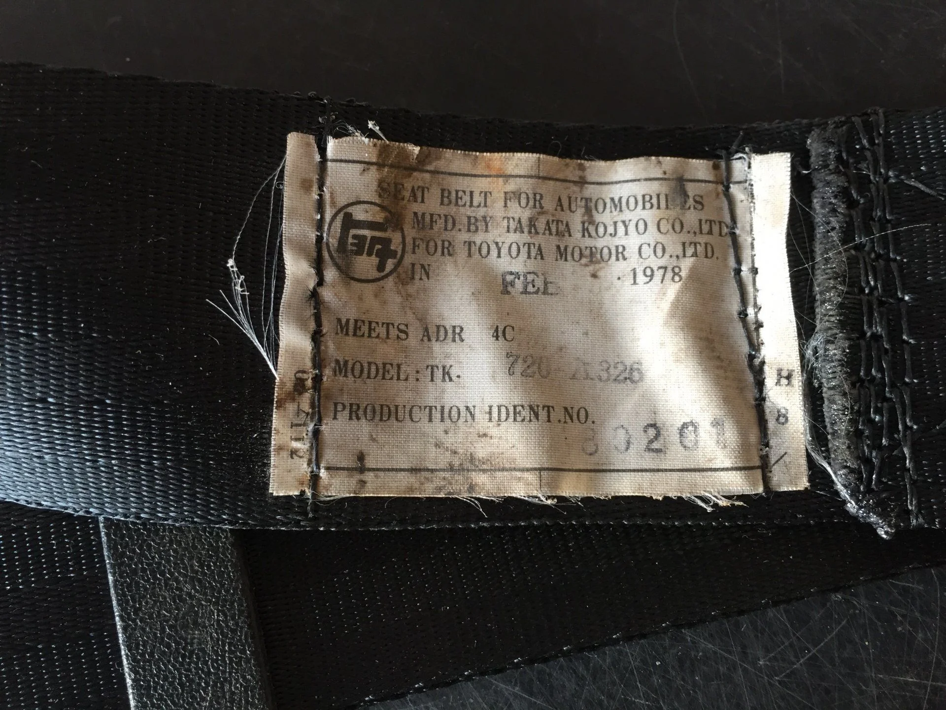

My seat belts were finally finished this week. I had the upholstery shop remove my original tags and sew them onto the new webbing.

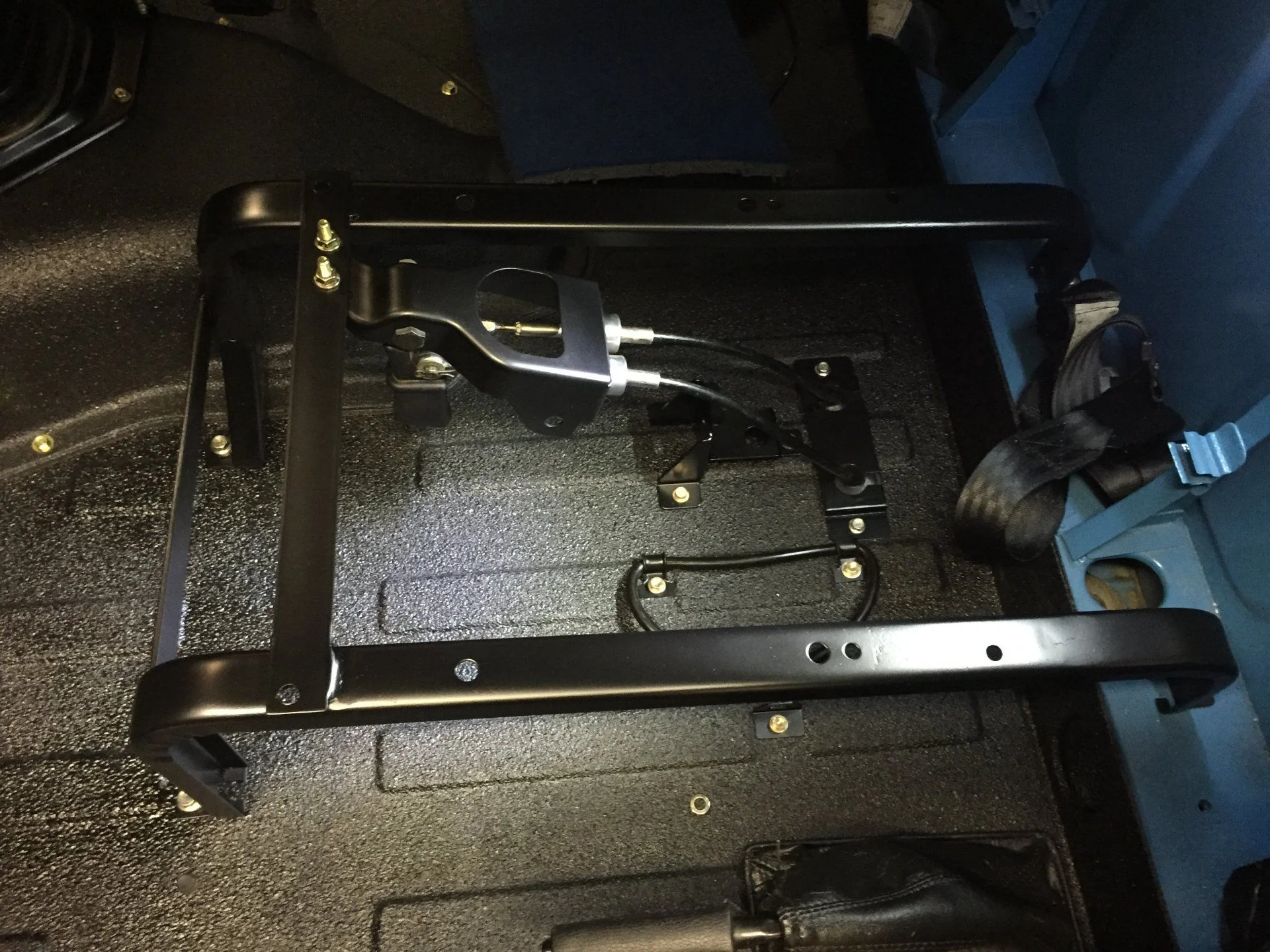

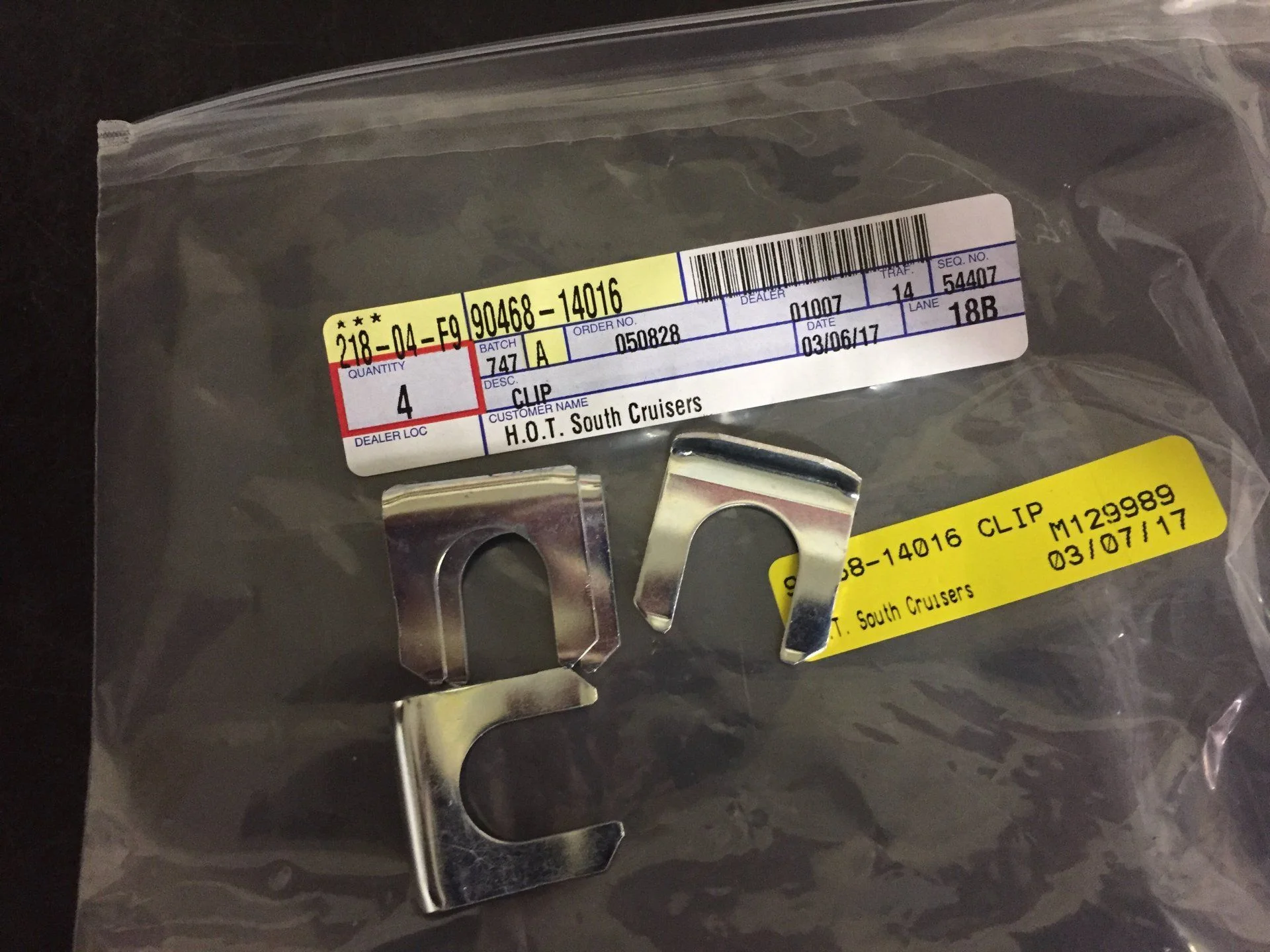

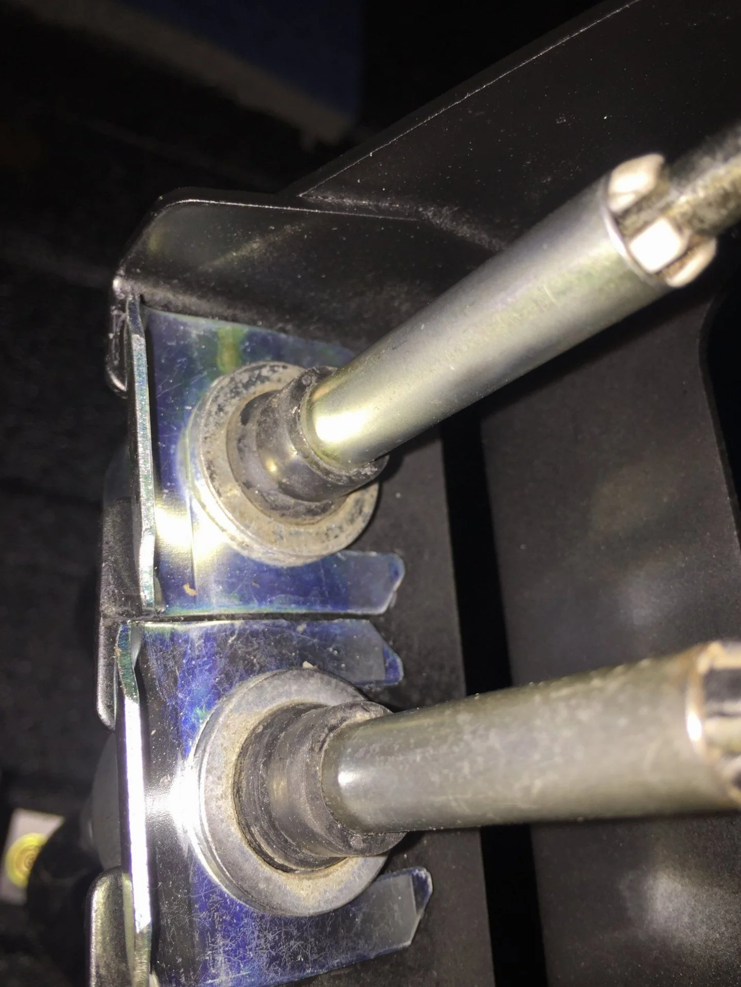

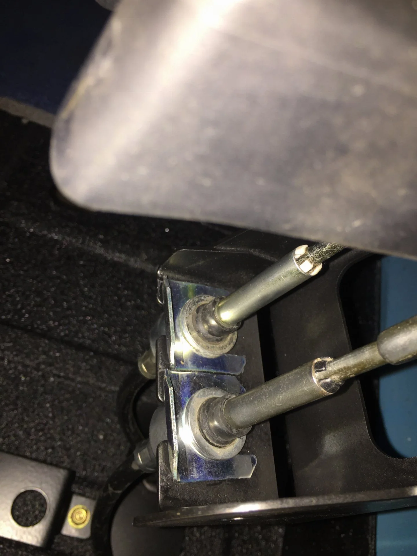

Next I completed the installation of the cables for the axles and the seat base. When I purchased the axles and cables there were no clips to lock the cables into there mounts. Those clips are NLA. So I found an acceptable substitute with the help of my favorite parts guy at my local Toyota dealership. They worked out rather well.

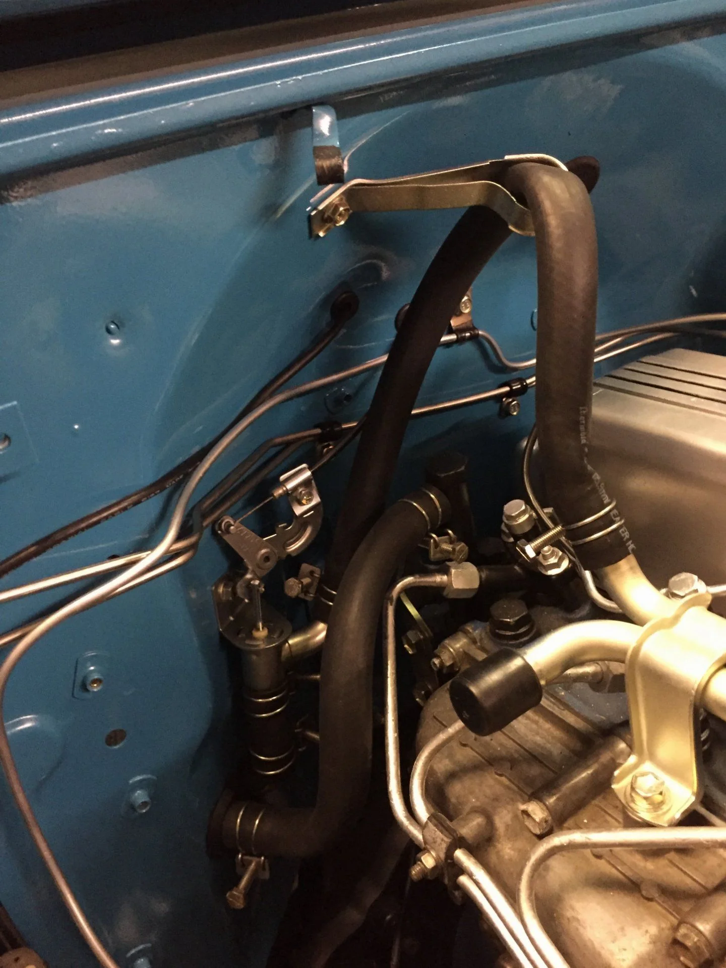

I slipped out to the garage for a few more minutes this afternoon and installed the heater valve. I decided to use the FJ valve instead of the HJ valve for a couple of reasons. I had both on the bench but after test fitting them it was apparent that:
A. I had room for the FJ valve.
B. The FJ Warm Pull cable was significantly different from the HJ cable.
So with those differences in mind and I wasn't keen on drilling more holes into the firewall I decided to use the FJ valve.
I'm pleased with the results. After that I could proceed with a bit more assembly work.

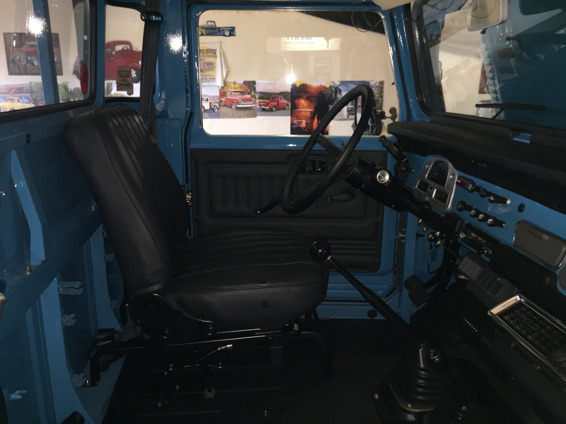

Driver's seat in! I'm McLovin it!

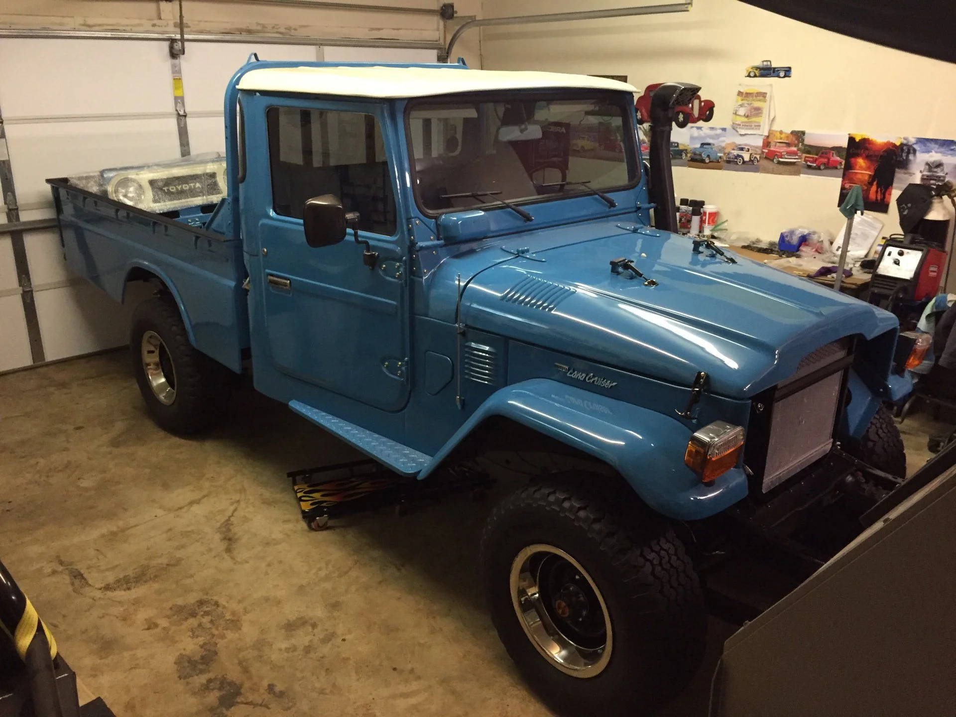

Yeah it shouldn't be long now. Hook up the PS, install the fuel cell, add fuel, brake fluid and antifreeze and it will be time for the first flight.
looking good man.
question, that seat belt behind the fuel breather pipe not going to be a problem? if some ones sitting there, wont it pull tight against the pipe?
Thanks @Vossie ! I thought about that when I installed it. But as best I can remember I think that was how it was originally. I may have to revisit that later.
