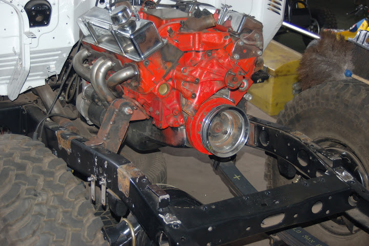

*Replaced the 6.2 GM Diesel with a 350 SBC, wich I'll stroke to 383 @ a later stage..
