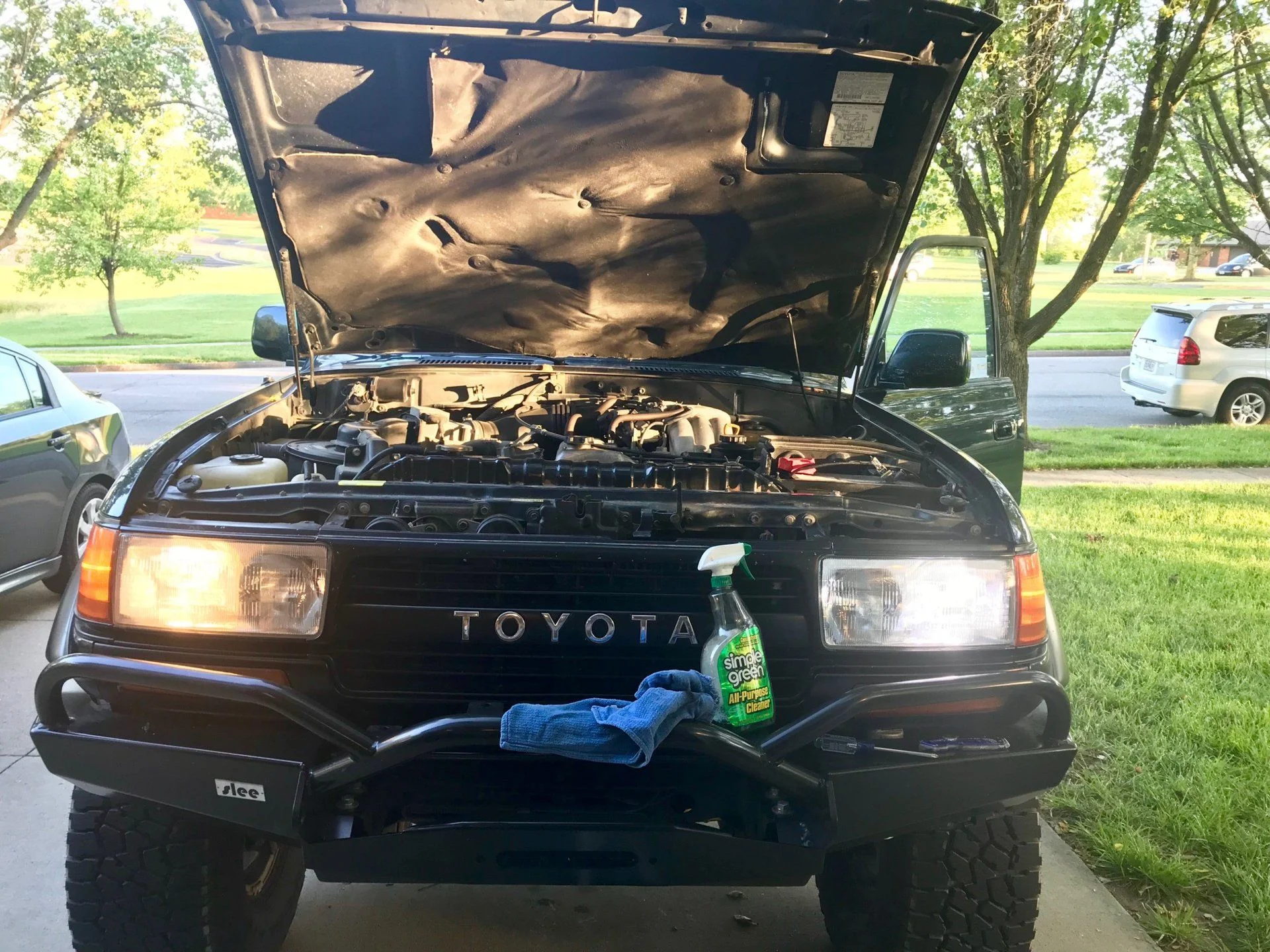

I have been waiting for my headlights to burn out so I could justify LEDs. The headlights are the last exterior lights to be switched over. I've been living with two different running lights/low beam bulbs that make my OCD kick in. I've had these LEDs on my Amazon wish list for some time. Finally one of the bulbs burned out and it was time to change them all!
Low Beam
High Beam

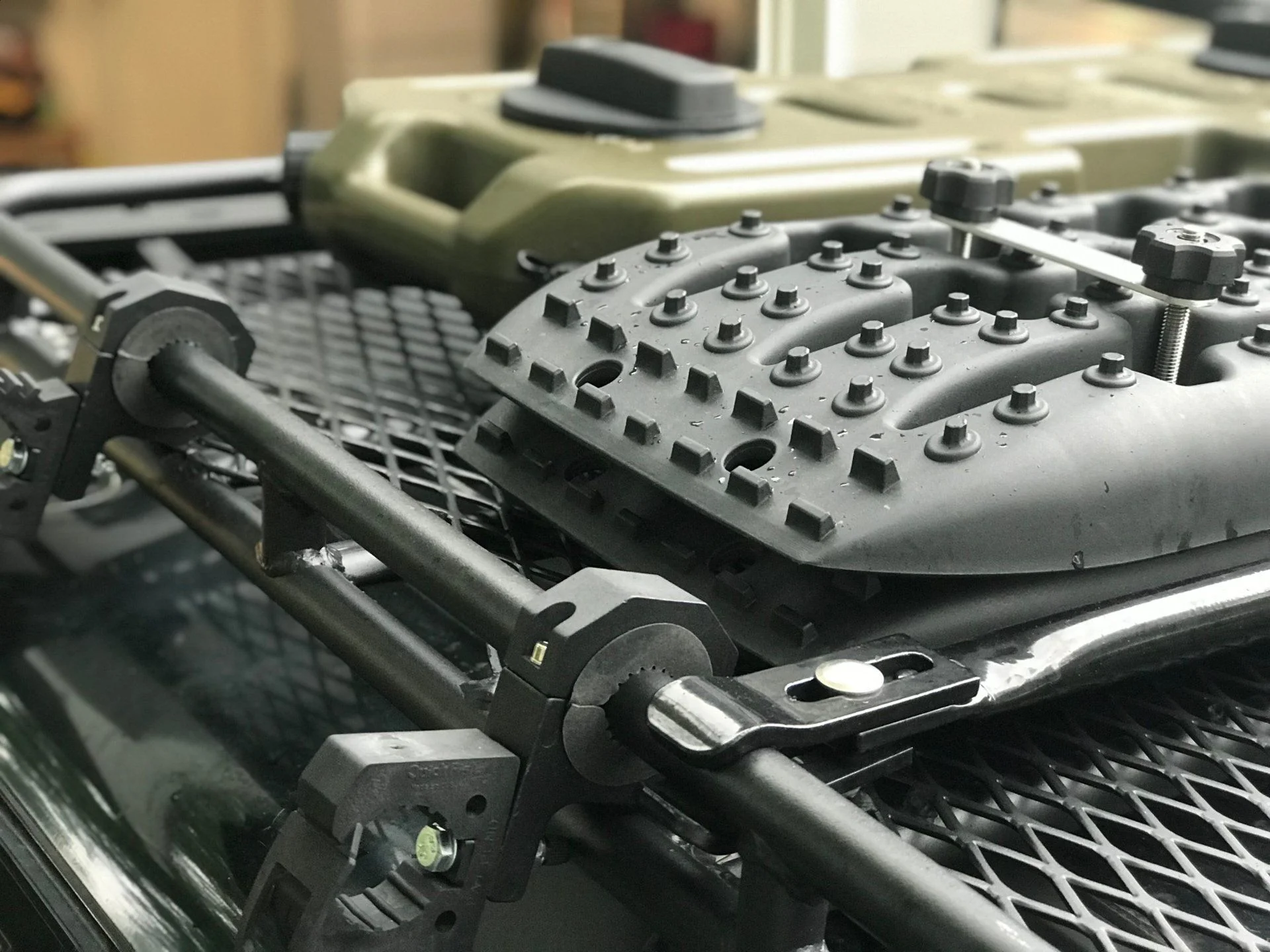

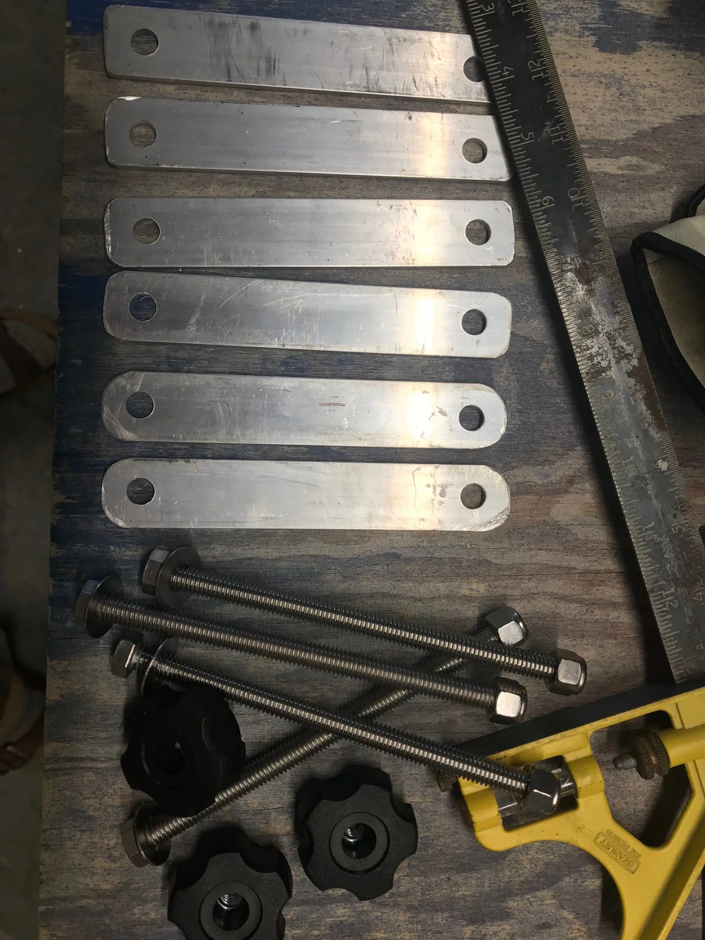

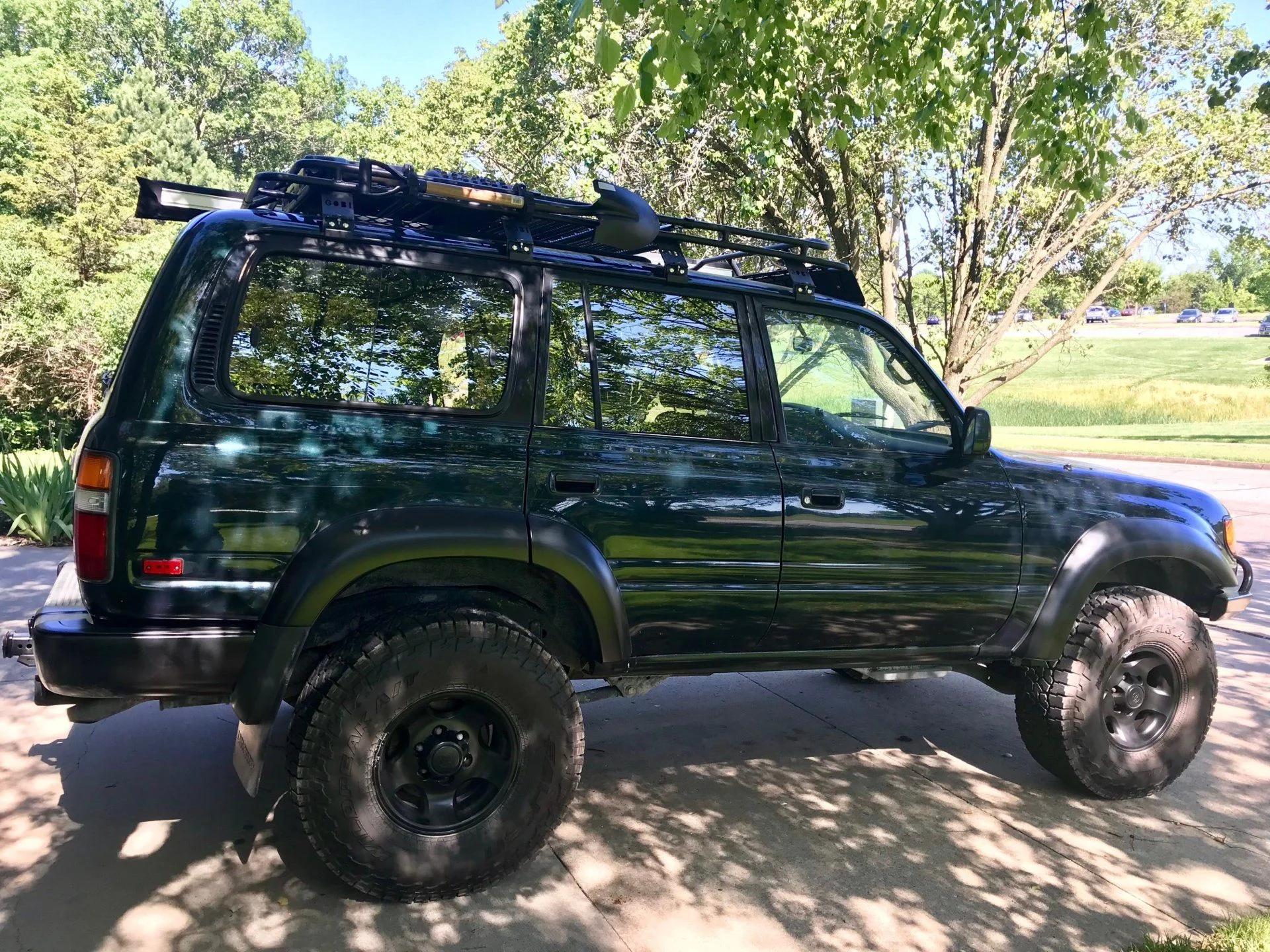

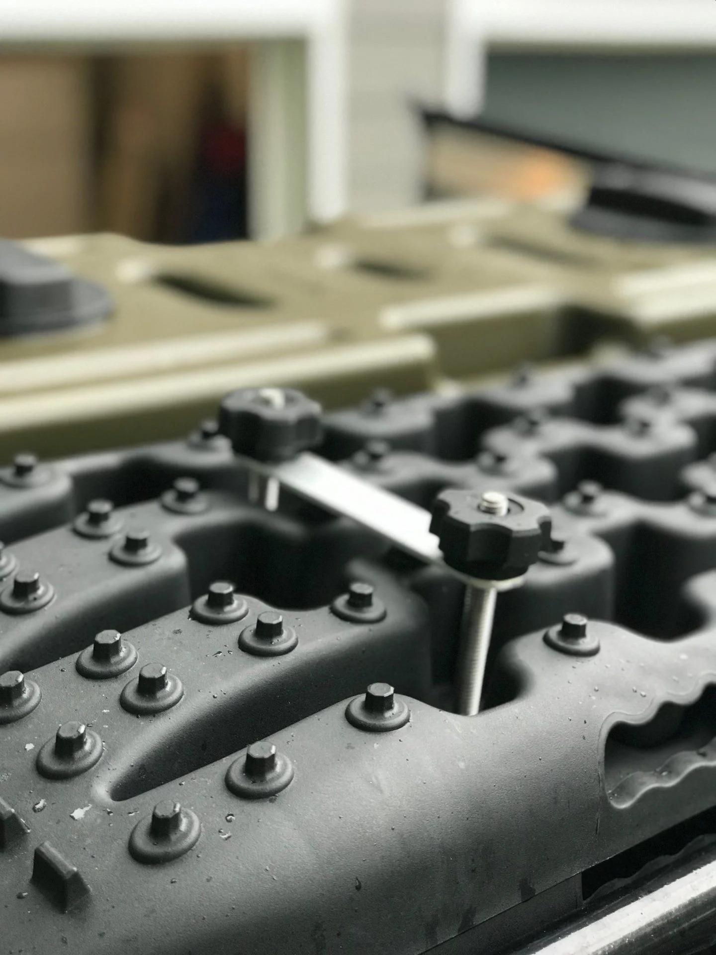

Created a few brackets to attach my traction boards to my roof rack. This is 1" aluminum stock, bolts and knobs from the hardware store.
Close up on the installed knobs and bracket. I'm a little concerned how well they will stay tight... they bend the bracket down and seem very snug, but will have to watch them to see how they do.
You can get a better feel for what it looks like here and also a shot of my shovel mounts as previously posted.

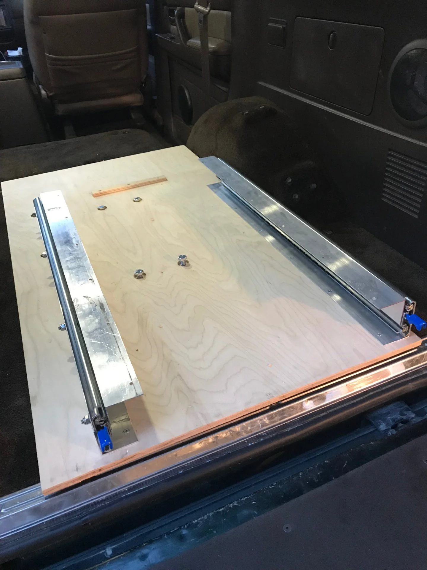

The upcoming camping and road trip made me get busy on building a custom cooler slide out. My cooler is so heavy when loaded--it is too cumbersome to take in and out. This took me a day to build but more than that planning and collecting all the parts needed to build. It even has a storage underneath for my folding table. Here's a demo!
I started out with ordering these 500lb fully locking drawer slides from Amazon. Then I locally sourced aluminum angle, plywood, lots of bolts, and screws. The tie down straps are $3.99 at Harbor Freight. I cut and assembled the sliders first then attached them to the base. This is all held down to the floor with the existing bolt holes for the 3rd row seats. I don't have many pics of the process... I just measured and cut things to what I needed. The base is wider and longer than what I need as I plan to build slide out drawers and possibly box in the cooler itself. Here's one pic of a test fit after I cut the anchor holes.
I like those LED bulbs. Any problems with the plug or did you have to cut down the plastic to make them fit in the housing?
Plug and play! There was one that was just too tight to kind of screw in and I shaved down the little extra nubbins on the bulb side. I'm sure that's only there to help make a tight seal but my old bulbs didn't have it and the new was still very snug.
My suggestion for your fridge slide is to remove the wood screws you have screwed the brackets to the plywood with. Go with a t-nut from the underside and bolt into it. You should have clearance for the bolt on top. Otherwise as you wheel and overland with it those wood screws are going to come loose.
Low Beam
High Beam
Are you happy with the light output those have? Any problems with being too bright with oncoming traffic? I have hir lights that have been recommended on here but they're getting pretty dim after a year.
Good idea, however after being yanked around for a couple of weeks of off-roading the platforms are holding together well. My wood screwed plastic tie-down brackets didn't fair well so will be switching those to bolted metal. This was some what of a temporary trial and would like to make a modular drawer system so I'll keep this in mind when configuring.
What is awkward is the white light. It takes a little to adjust to and even on overcast days you can see the white reflection from road signs. The output is outstanding and I haven't noticed any indication they are too bright with oncoming traffic.
