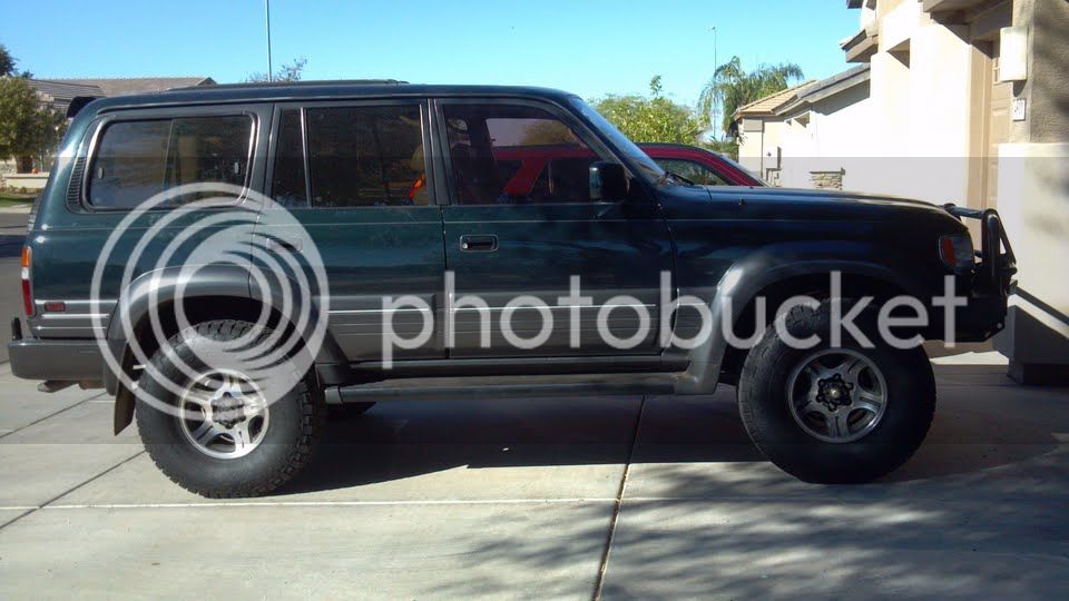

Best part...pics:
Off on it's final voyage with inferior sneakers...
As has been documented by others the guys at Discount asked me at least 3 times if they would fit, or if I was sure they'd fit. Even the guy who brought me the paperwork said he'd make a good turn pulling it out of the bay to see if they'd rub. I just said "they won't." Moving on...
Super sweet. LOVE IT. Of course can't wait to put on a lift but I can rock this for a bit.
Very nice! Looks beefy with all that rubber tucked underneath.
Great looking LX! Question what kind of rear bumper is that?
And what you plan on doing next?
Yep Kaymar Deluxe, PO had it on. Actually the next thing I'm going to 'do' is find a trail!! But for the rig itself next major item will be lift for sure. It already has OME shocks. In the mean time little things like roof rack removal as I mentioned and I'm going to add another dome light to the lift gate as many have done. That's just off the top of my head, it'll be neverending for sure.
Looks nice.
Maybe I missed it, but what lift do you have currently? Those tires fill the wheel wells nicely, you sure they don't rub? :hhmm: (I consider rubbing when the tires make any contact at all, not necessarily ripping the flares off).
No lift yet, stock springs with OME shocks. I'm sure it would rub if flexed but street driving, even turning wheel full lock either way, it doesn't.
Actually not at all. A tiny bit of highway hum but quite surprised at how quite. I don't have a lot of experience with mud and AT tires but would recommend these, grant it only driven about 20 miles on them so take it for what it's worth. Although I purchased upon recommendation from a couple of experienced AZ Mudders.
These tires are on my short list based on praise from a few of the CSC folks.
looks like you have a lowering kit,,,,...jk. looks cool. cant believe they dont rub. gotta love the huge wheel wells
Haha it is...factory lowering kit. Keep it lower for better mileage. :lol:
How's the gearing. Is it real noticeable going to 315's? Think you will end up regearing? I am thinking of getting these exact tires
I do notice, takes a tiny bit more to get going. But nothing I'll regear over. I keep the PWR button on for the shift points as I like it personally so that's good enough. I'm get a Yellow Box speed calibrator or similar too.
those tires have been great for 8000 miles on my truck, I hae had them in rocks, snow, and mud and they perform better than any AT i have had before. They seem really durable as well and the tread has not chunked at all. Hope they serve you well as they have me.

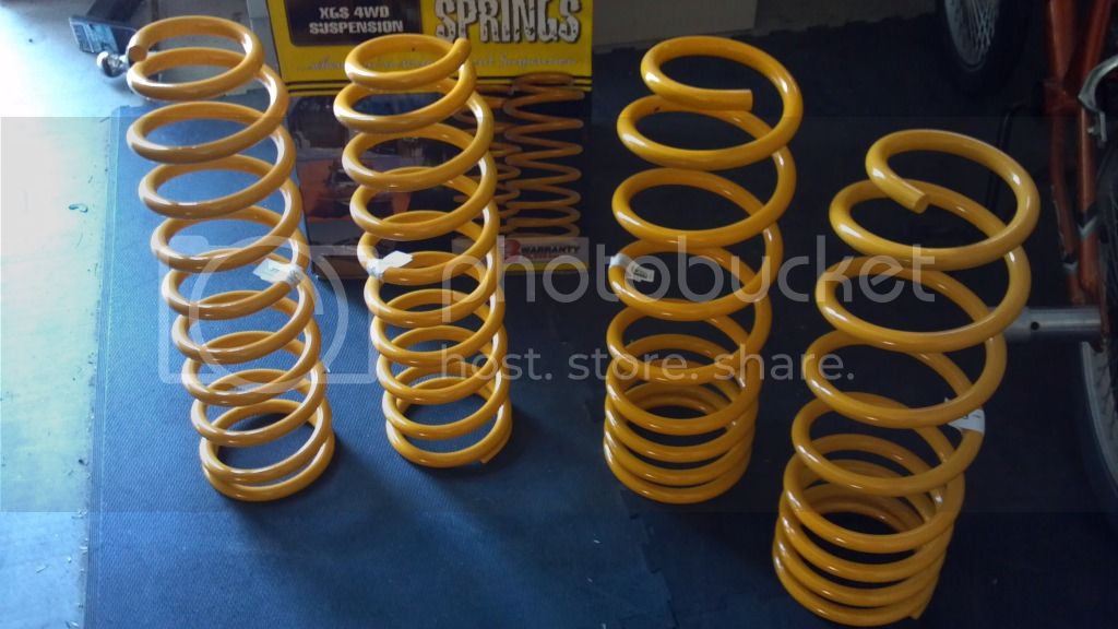

A little update and list of pieces ordered. Pics to come.
- Going with TJM 50mm heavy springs from Sierra Expedition here in town since Ironman are on b/o til mid November (picking up tomorrow!!)

TJM lift
Already posted this in a separate thread. Just adding to my build thread.
