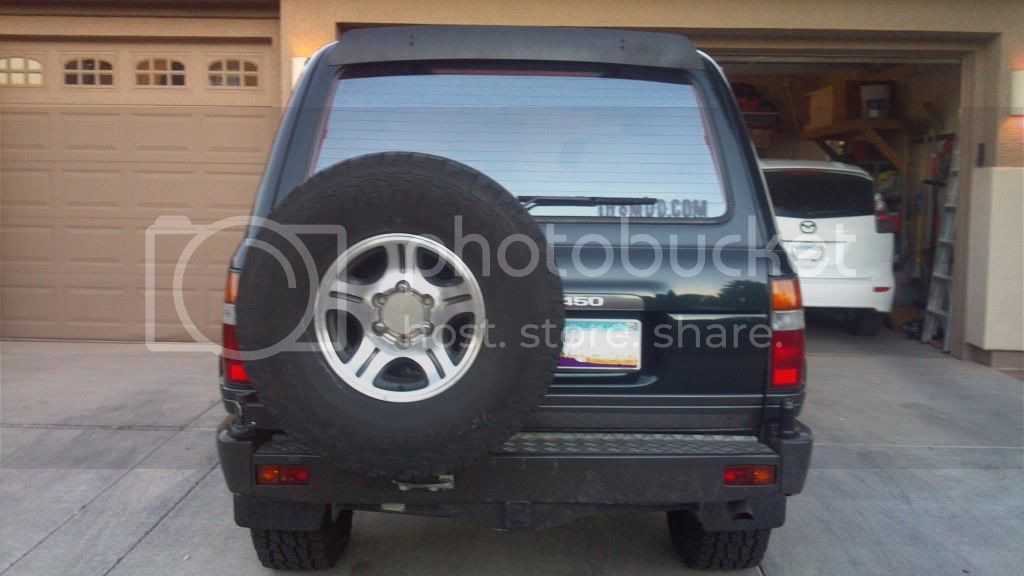

A couple more items off the list. Cree 7W reverse bulbs. I am amazed, doesn't take much to do so, but seeing these in person...pics don't do them justice.
Oh and also picked up the correct size spare, can't quite tell in the pic, $20 mounted.

A few little updates. Finally removed running boards (be looking for front mud flaps soon). What a difference, love it. My little guy thinks it's "cool" climbing in and out.
Reverse LEDs and full size spare.

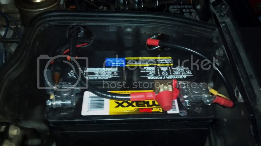

Finally get to add something to my build thread. Lack of funds means unable to do anything so when my alternator started going it forced me to make an upgrade happen.
150 amp from a 07 Sequioa, Photoman bracket/pulley kit, mil spec terminals, went with 2 ga wire for B post power and new ground to frame, also for main power. Blue Sea single post fuse holder with 175 amp fuse.
All went smoothly with the help of my dad (still learning from him at 41). Great instructions from Bill's kit. Feels good to get something done on the rig after so long.
A little difficult working with the larger gauge wire and not exactly how I wanted it but is decent and will work. A heck of a lot cleaner than what the PO had done. Don't worry, put the battery hold down on after this pic.

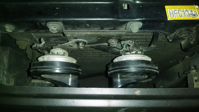

Baby steps. Added Fiamm AM80 horns from a foxbody Mustang. I have owned several and I liked the horn. Picked them up for $20 from a stang parts guy here. Spades matched so plug and play. May upgrade to Caddy 4 horn setup some day but for the money these are great.
