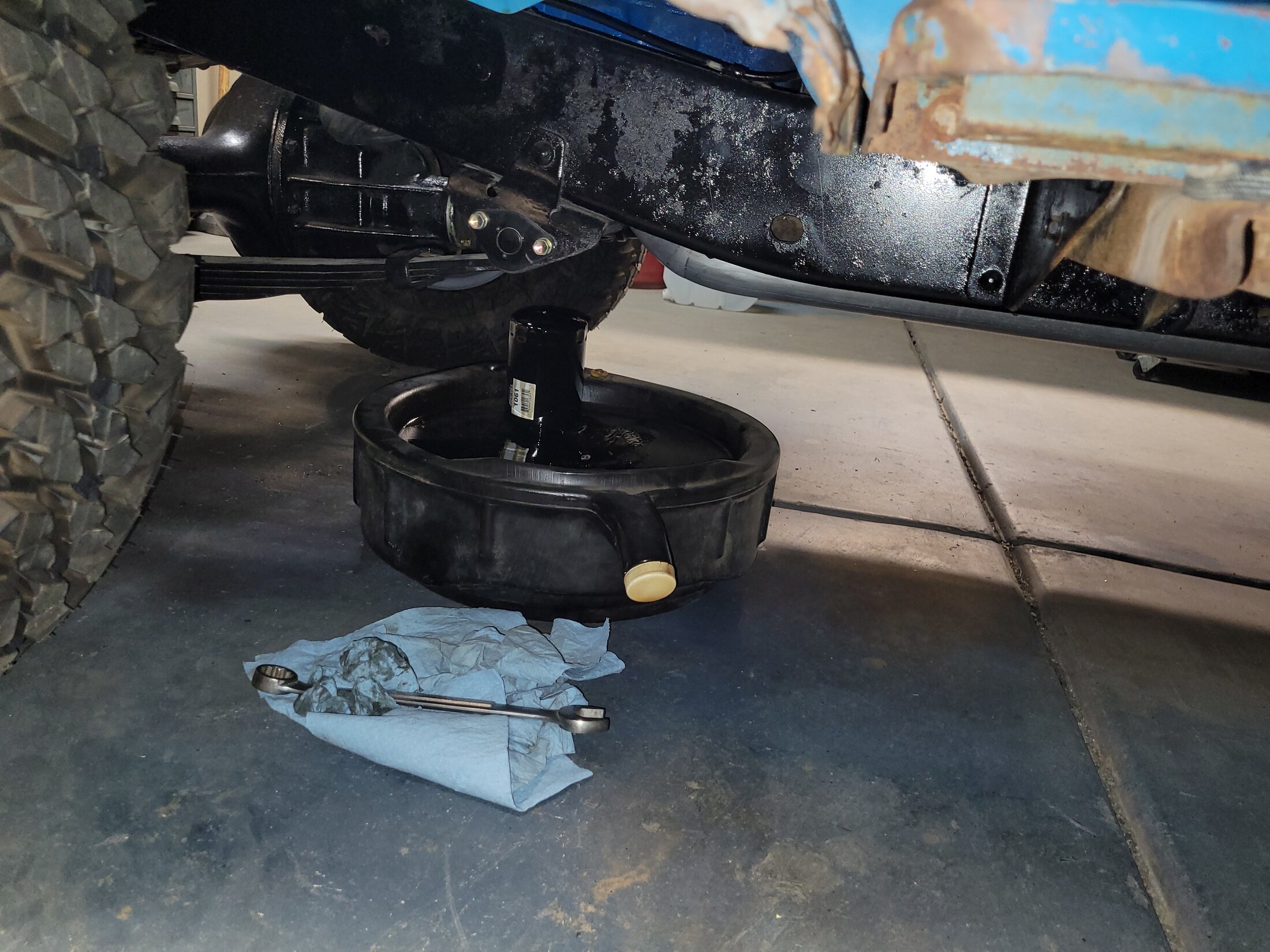

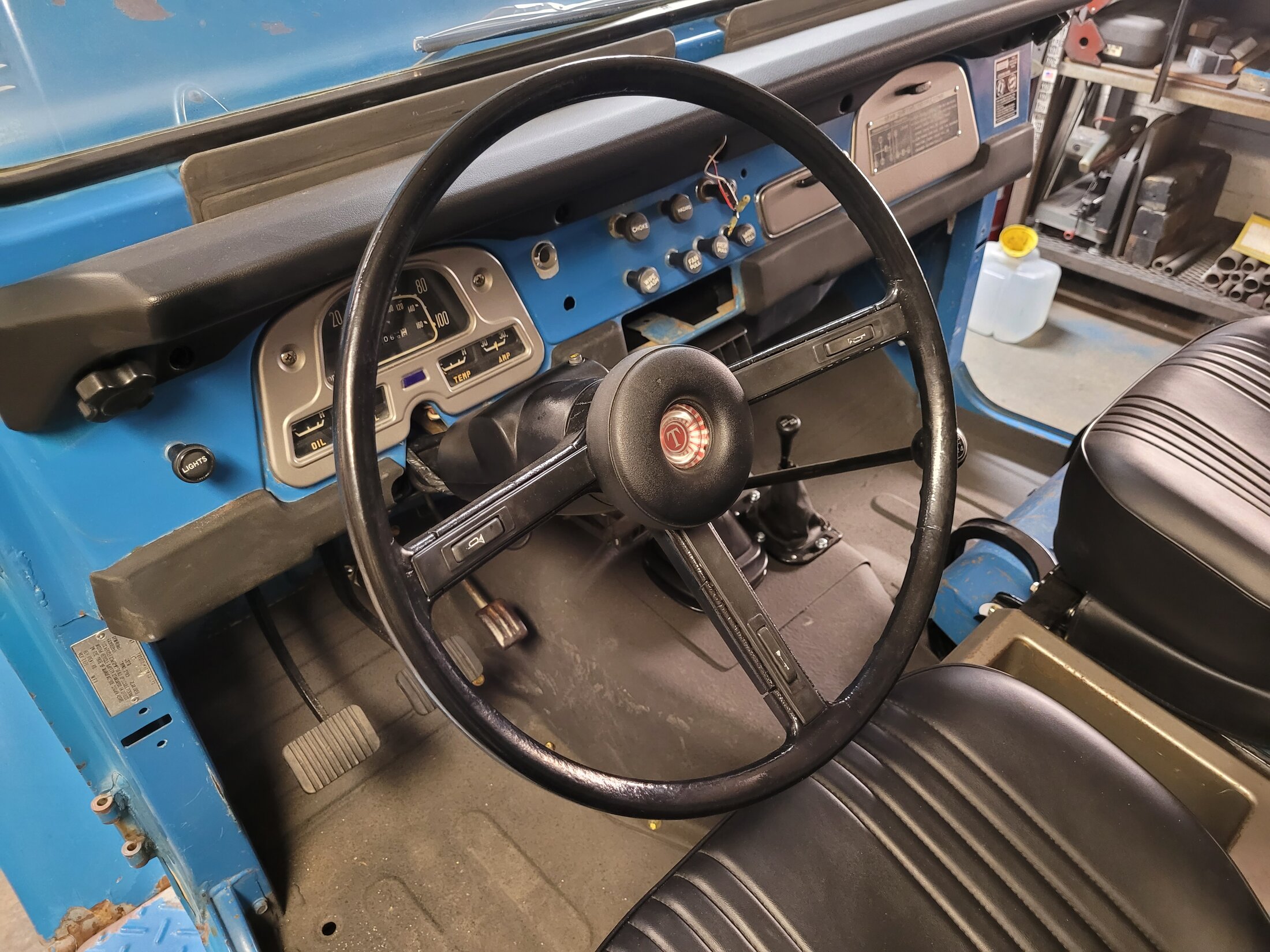

Got lazy and didn't work on the steering box mount yet. So, tonight I reinstalled the working head light switch, column covers, and steering wheel. Then drained the oil and removed the filter.
I had replaced the filter before I started the motor, but not the oil. So now, after some minor run time, I will replace both.

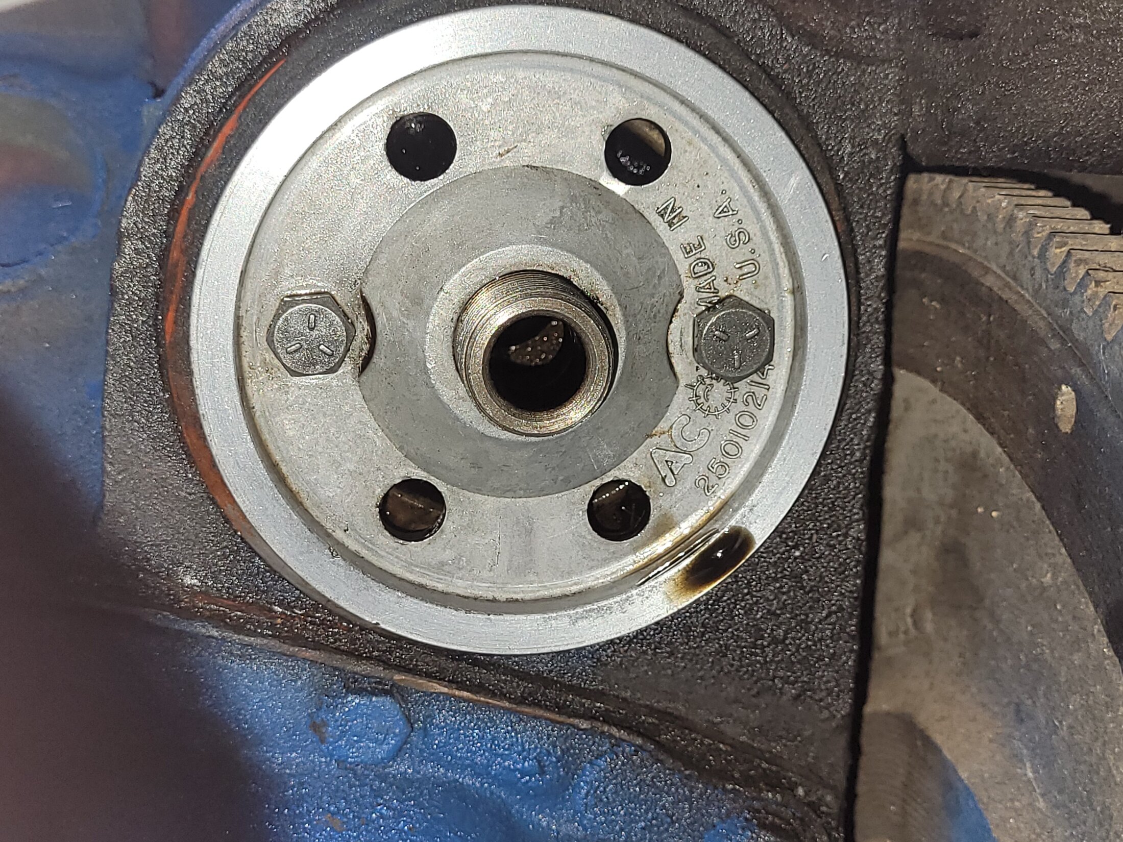

I noticed this filter adapter. It's an AC.....like AC Delco I would imagine. Is this an early sbc thing? It might be the source of one of the leaks.

The AC adapter is a canister to spin-on oil filter adapter. I'm not the greatest expert on these but they are usually seen on 283's and 265's, especially where the crank is not drilled for a balancer bolt. They don't usually leak but there is a big o-ring between the block and the adapter as well as a round rubber seal, likely where your leak is coming from.

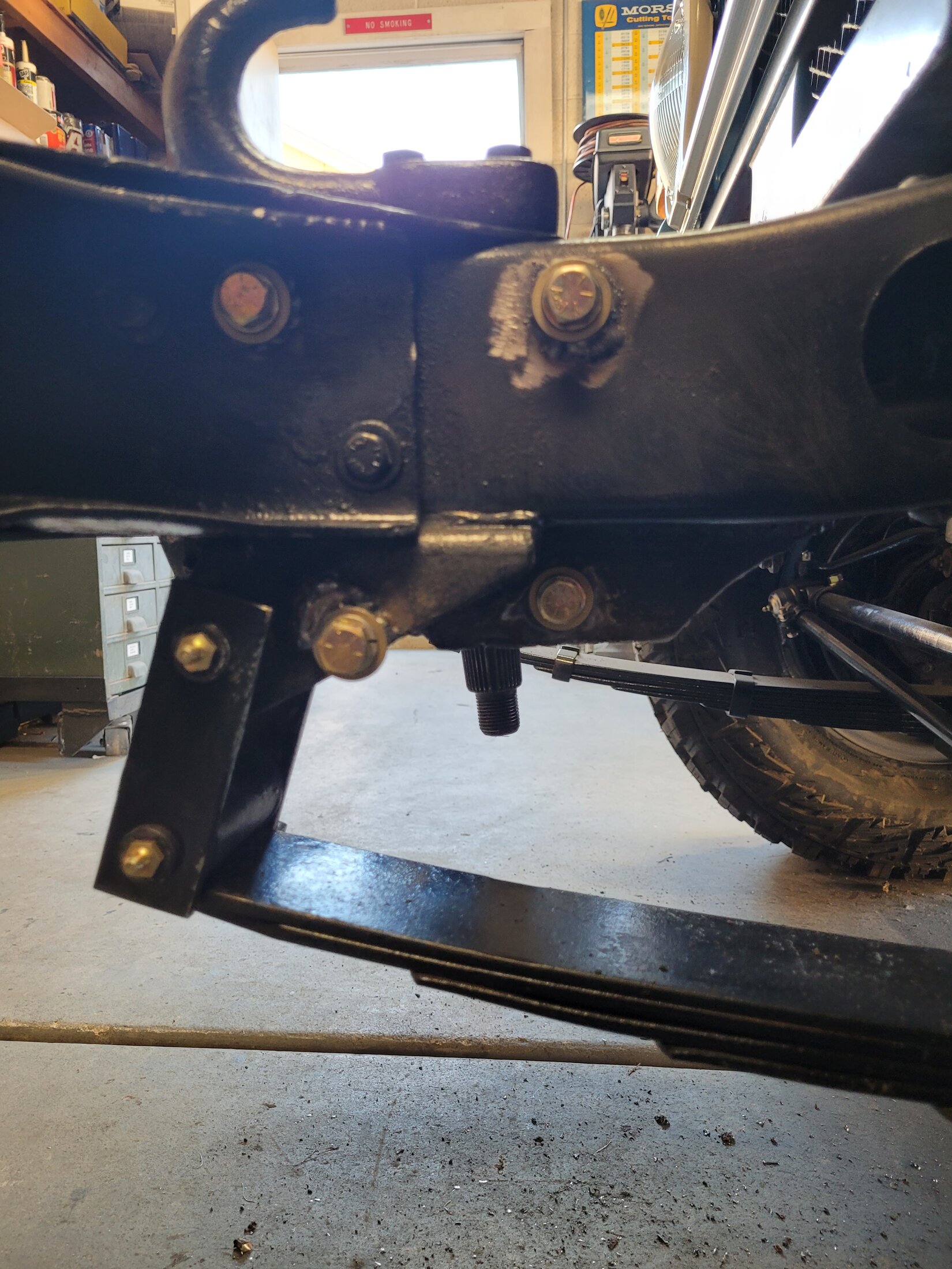

Finally worked on the steering box mount. Made sleeves for the frame and got 3 of those in place. One is off and will need to be adjusted. The 4th one ( not in place yet) is really close to the shackle hanger, but it will fit. I will shorten the outside part of the sleeve once everything is mocked in place.

and just so you know, there's ample clearance and no possible rubbage for the steering lines and the bib.
