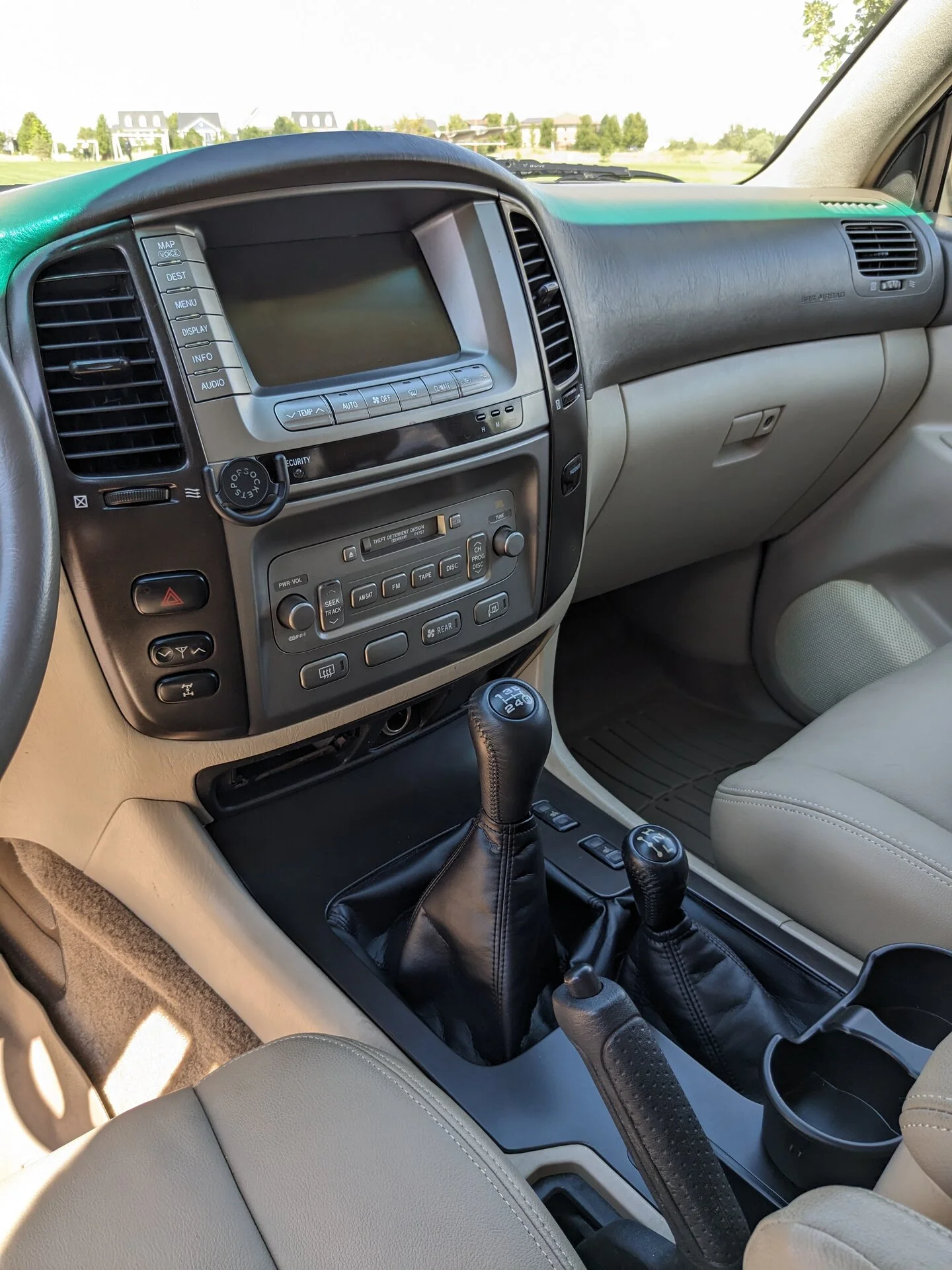

Made a console plate with transfer case shift boots so its all quiet inside. Ignore the extra wires those were removed later.
A layer of the factory insulation piece went on top of this also.

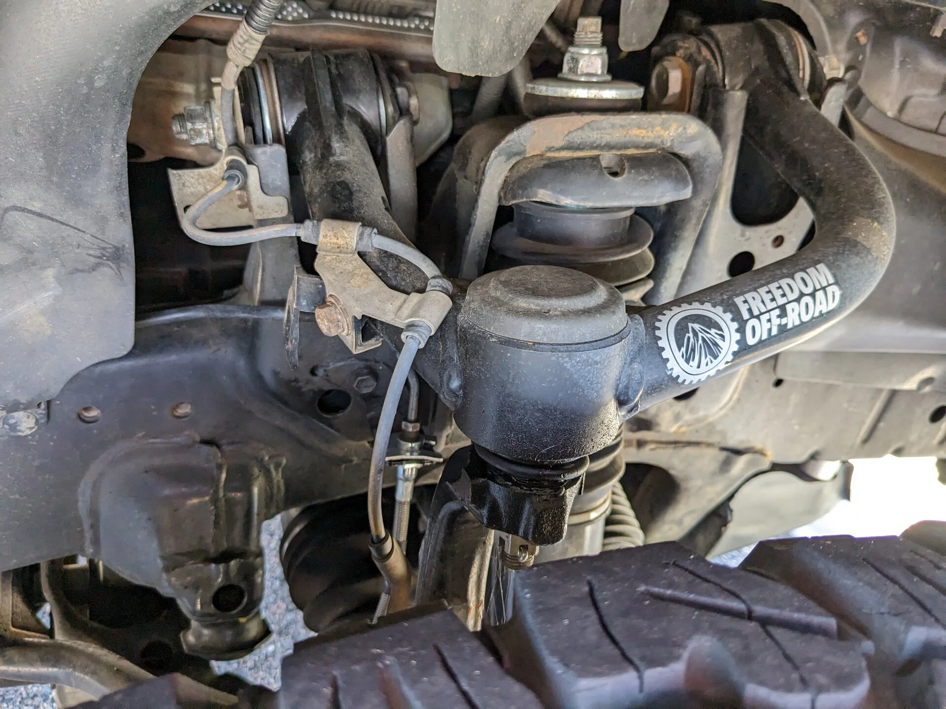

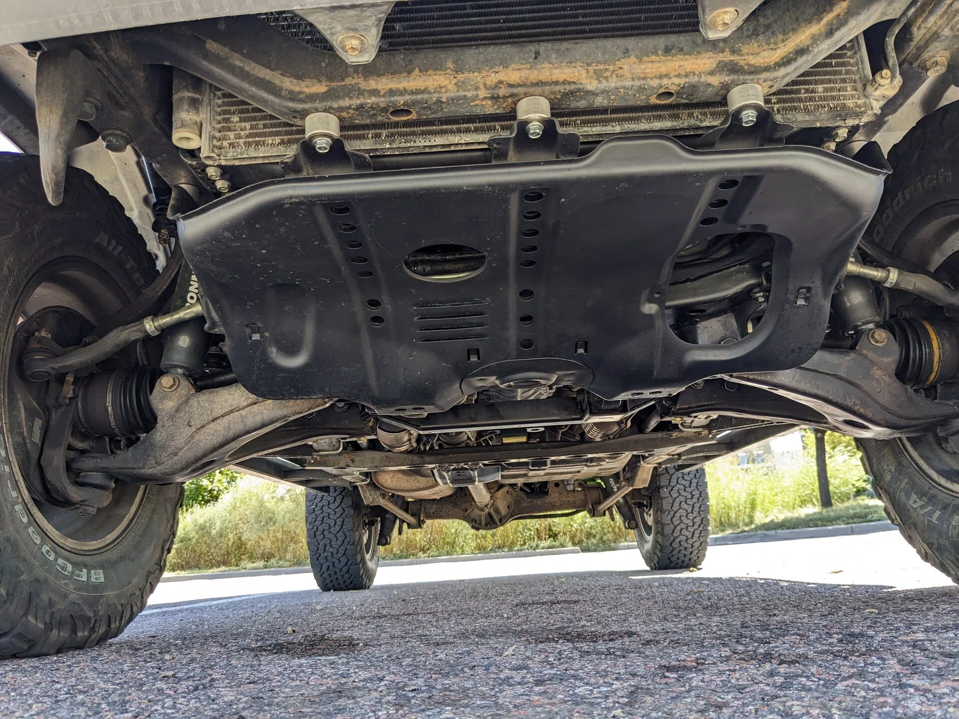

Ironman foamcell lift kit, high camber upper arms, rebuilt the hubs and new brake stuff, still need to install Slee front SS lines as the rear are already installed.

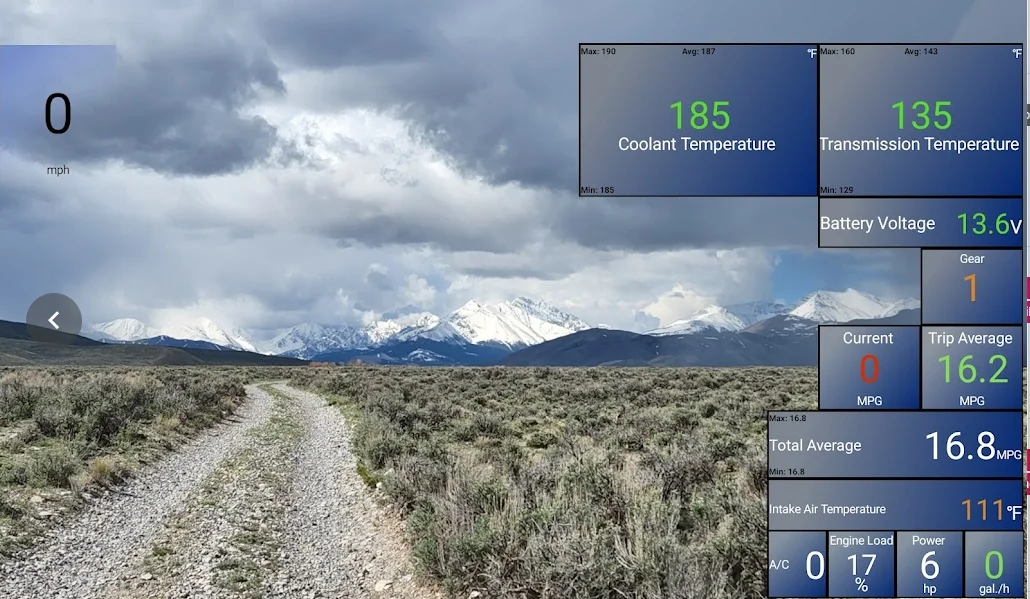

I feel the aftermarket screens aren't worth it, especially that tesla style. I haven't spent much time researching but with the way technology advances Id suggest just mounting a nice tablet instead and retaining the factory nav.
How much do the tesla style screens cost? More or less than the latest tablet?
Having a tablet will allow you to just upgrade as the years go and newer devices come out. Along with a BT45 bluetooth adapter its a solid solution. I can make calls, run spotify, use google/gaia maps and all normal tablet stuff. It's especially nice when connecting to OBD2 to monitor everything.

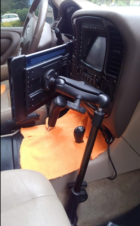

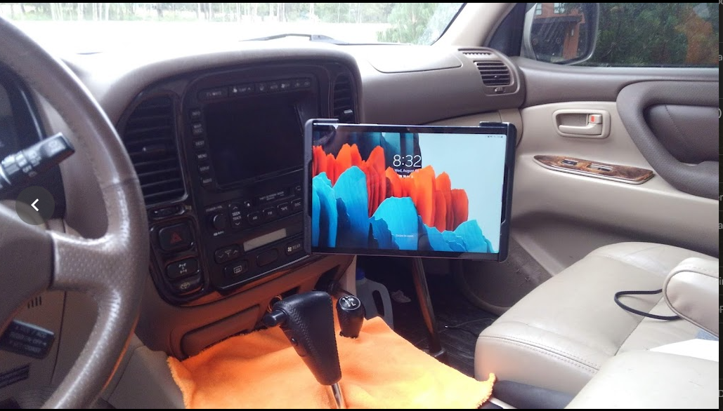

I have the @BenCC modification to put a ram mount ball on the center dash. I also have Ram mount that connects to the passenger side foot rail for rougher roads.
This is with the seat rail mounted setup. Can spin it to the passenger if they want control or back to driver when needed.

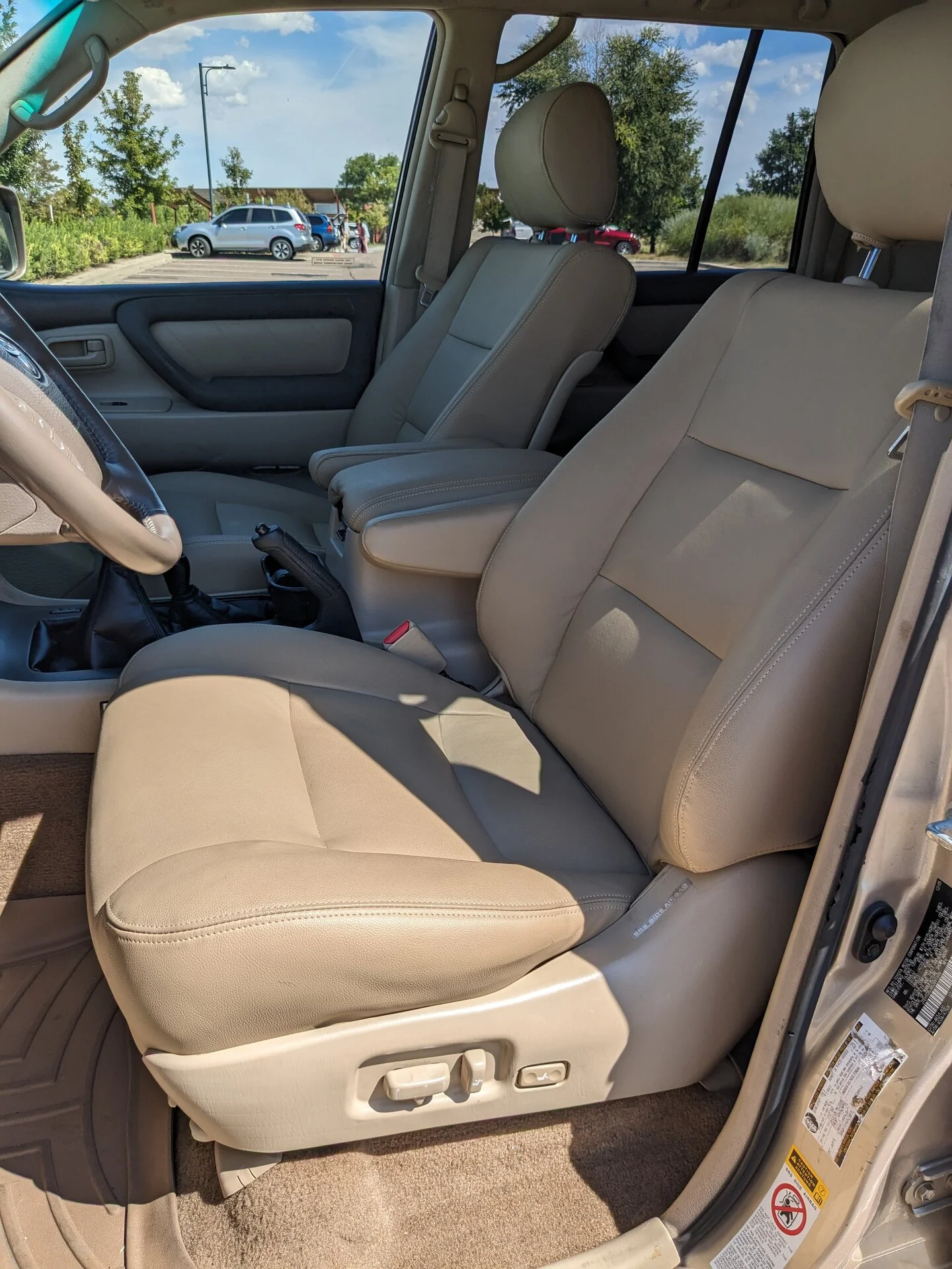

New carpet and recovered the leather seats

I would like to get something to replace the factory nav unit and stereo, the tesla screen is tempting but not sure how well it will work.
Open to suggestions haven't had time to research it yet.

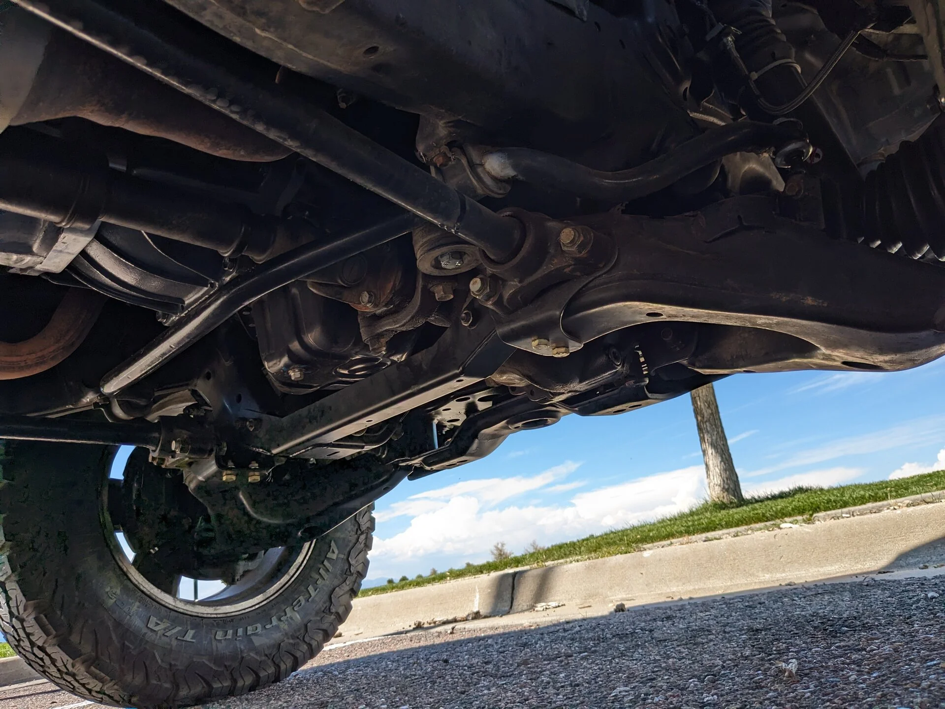

Finished installing the Slee stainless extended brake lines installed all around.
Installed a Delta pan hard drop bracket in the rear to make the rear end more stable with the lift and recenter the rear Axle.
Installed a Trail tailor diff drop to help with the front CV angles.
Don't have a lot of pictures of those installs as they are pretty straight forward but will snap some of the finished truck this week.

I also figured out how to make the factory ecu happy with the manual swap with minimal addons finally and was actually pretty simple.
I also did manage to get a tuned ecu for a manual swap specifically which is what is on the car now and doesn't need the extra stuff.
If you are doing a manual swap on one reach out to me and I can point you in the right direction.
All together the clutch is broken in and all the important stuff is working like stock, except the 100 is alot more fun to drive now =)

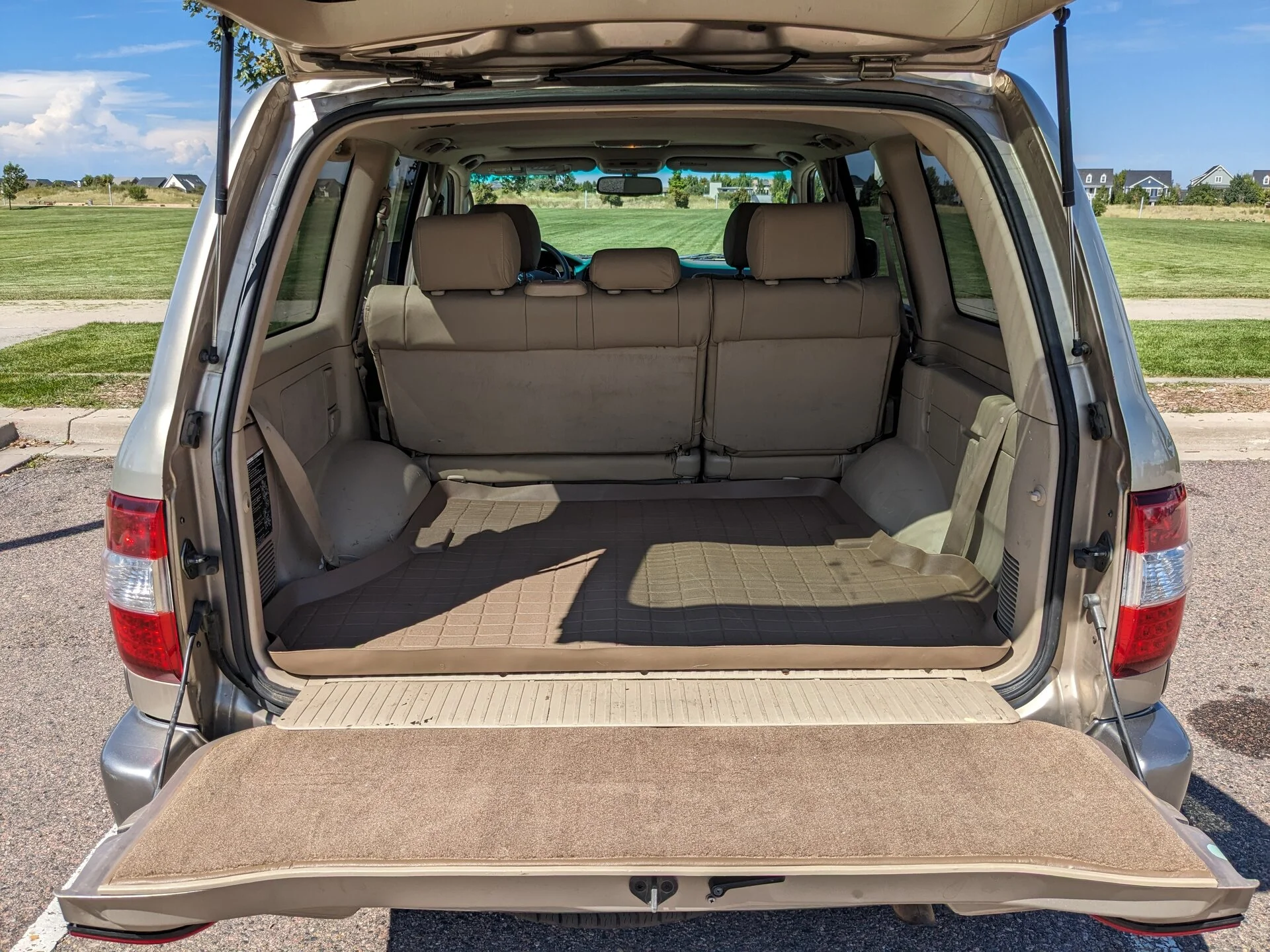

Got a chance to wash the LC and take some better pictures. Attempted a driving video but I need a better camera mount or a second person so will try again.
Exterior and some underneath shots.
