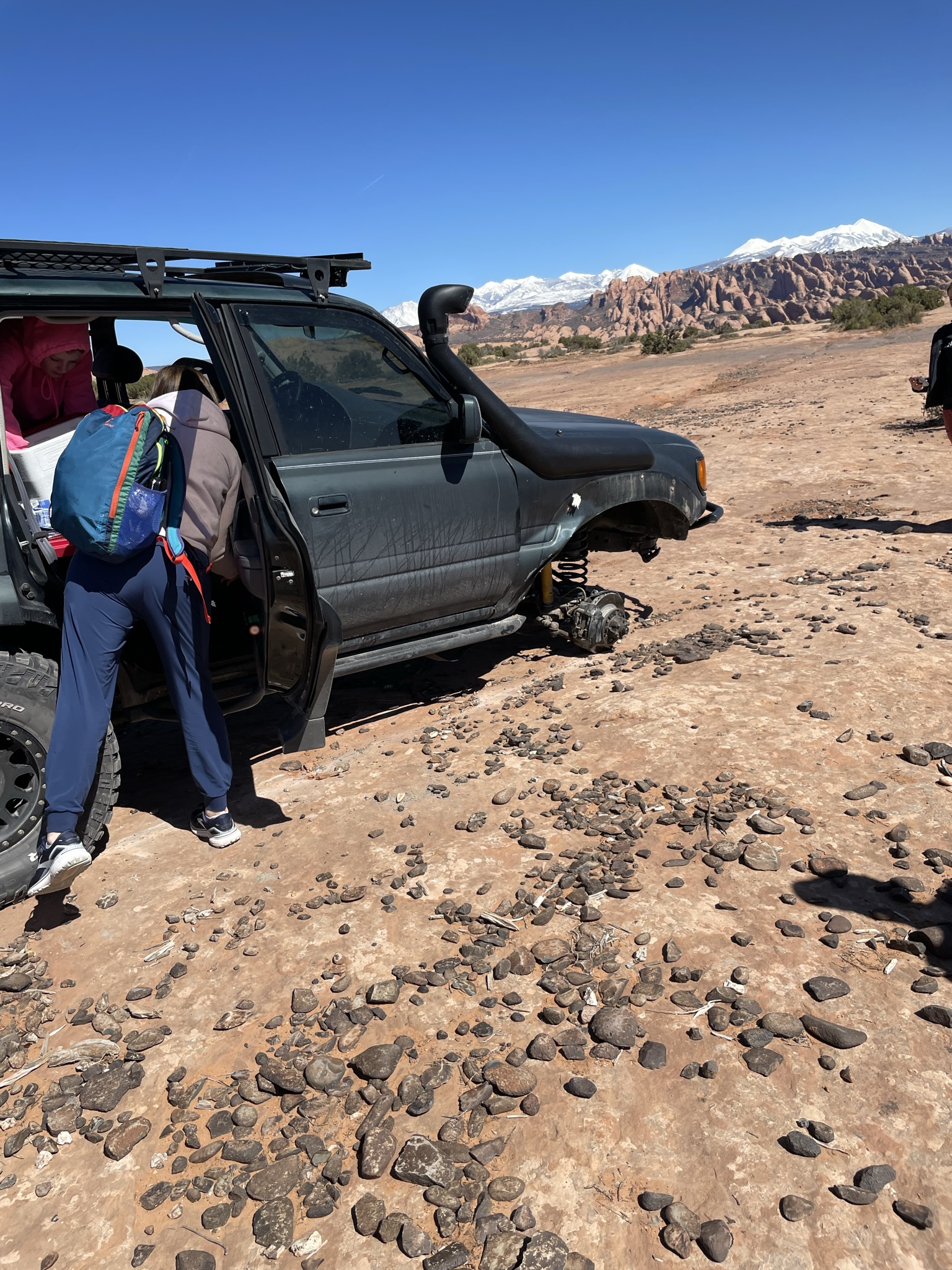

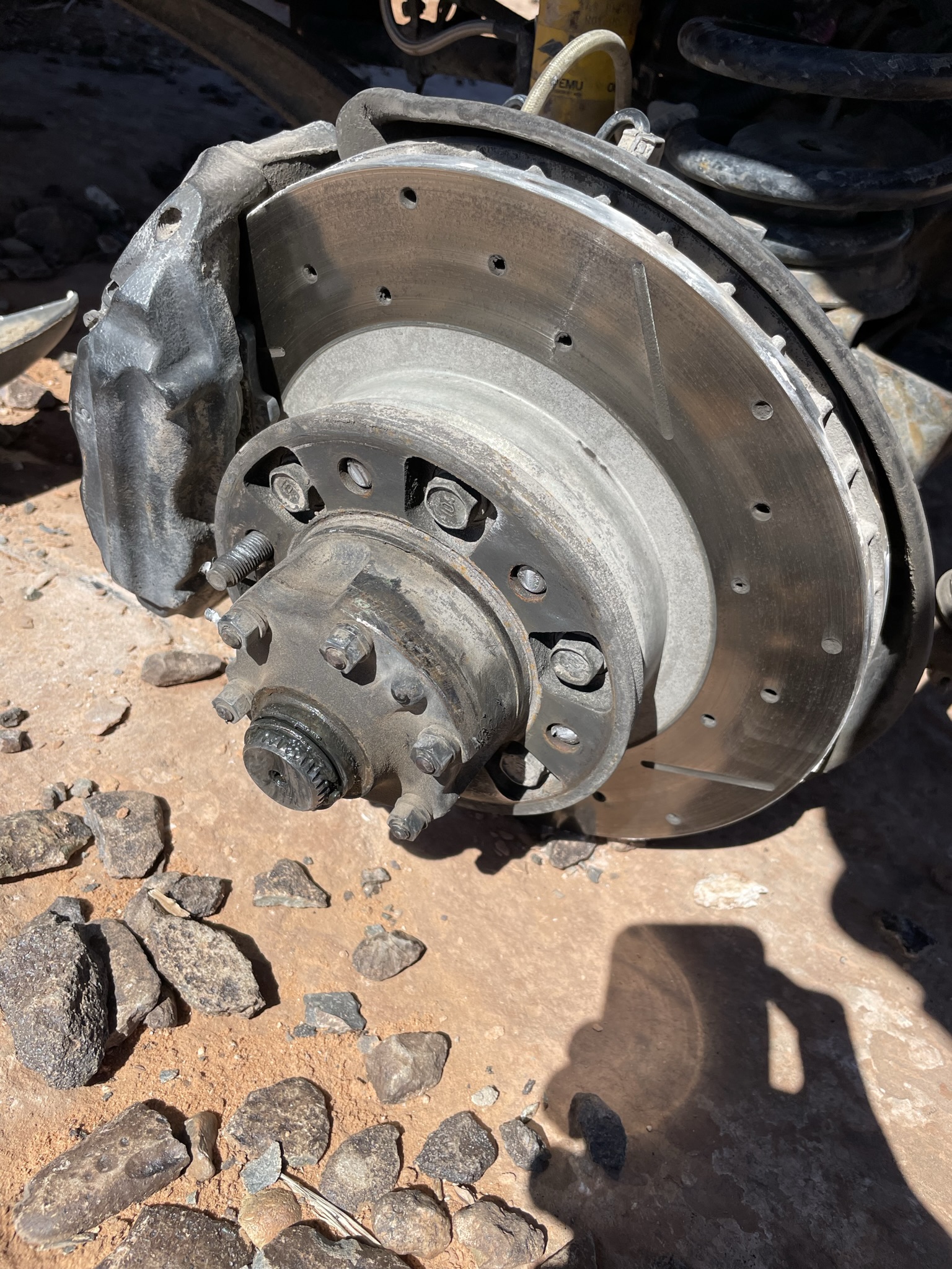

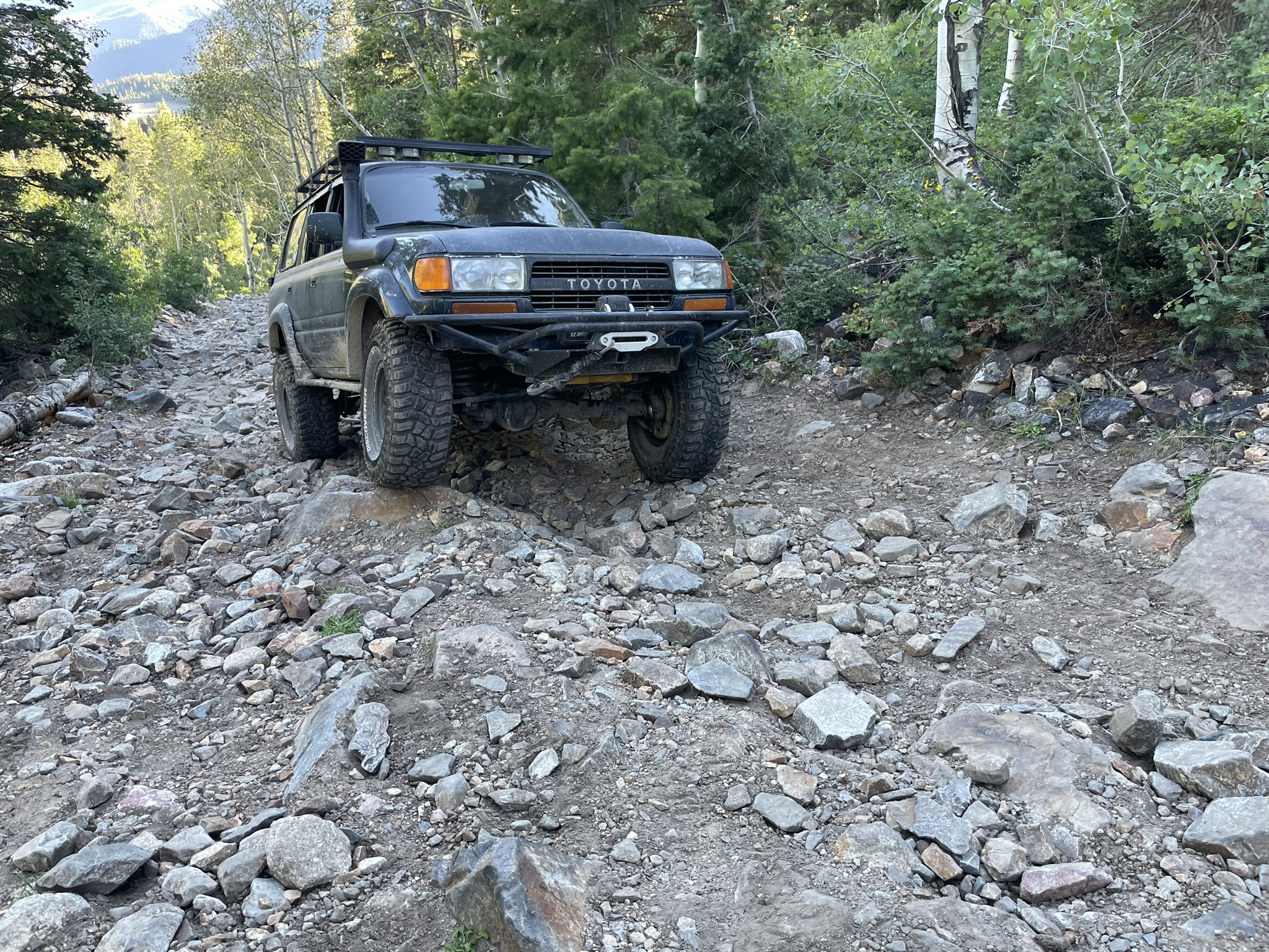

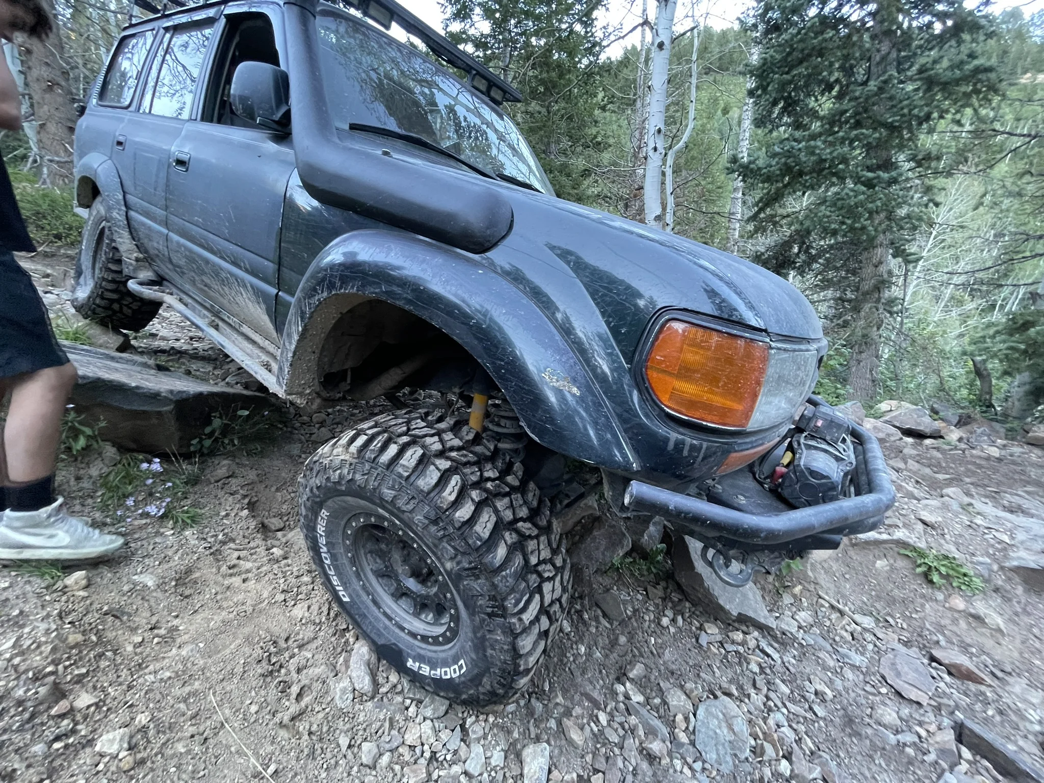

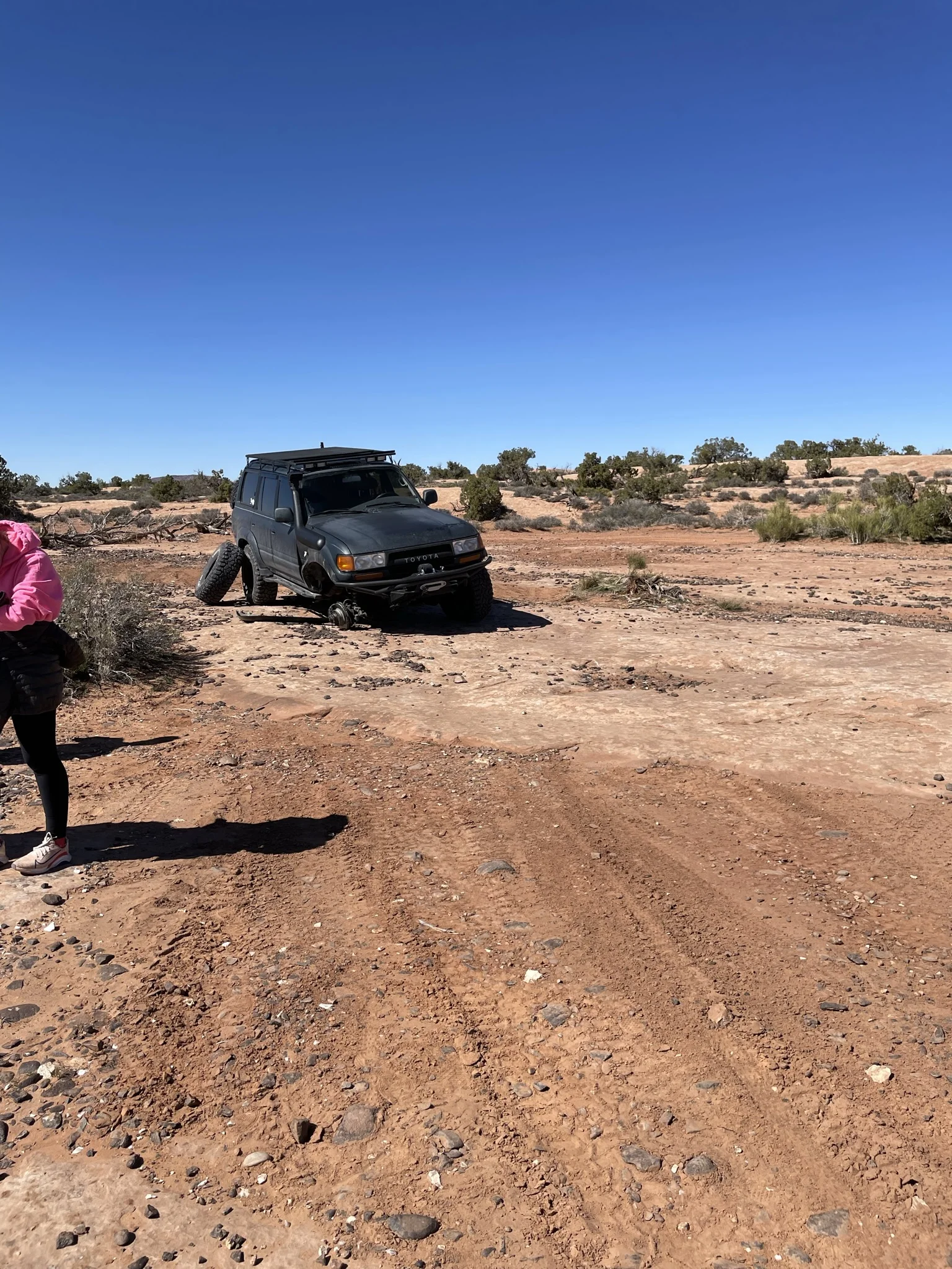

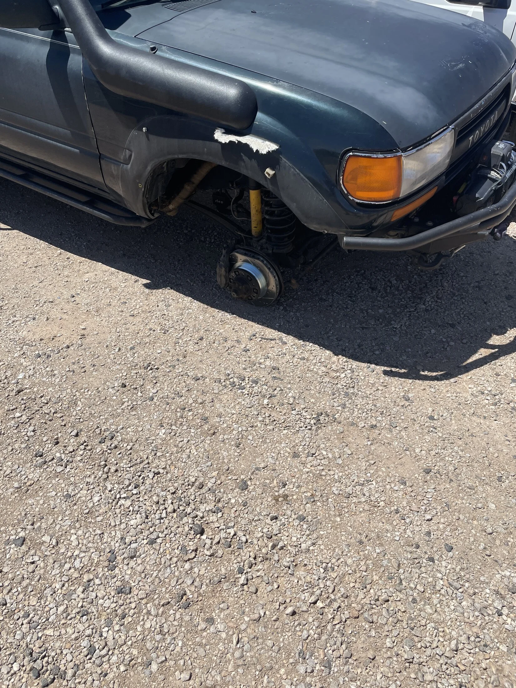

Once in Moab I ran fins and things for my second time ever but first time in the 80 and had a great time. Day two of Moab we did some hiking then went to run the poison spider trail. Again I was amazed at the Land Cruisers off road ability. Tons of fun was being had until on the way down the mesa there was a loud crunch and I watched the front passenger wheel rolling away from the truck. Upon getting out of it and inspecting the damage I found that 5 out of 6 wheel studs had sheered clean off. My best theory is that the studs were too lose as the next time I stopped by the alignment shop I asked about what spec they had for the 80 to which they told me was 76 ft pounds. I later learned that I needed 109 ft pounds for my conical-style lug nuts. I now own a torque wrench. Murphy got to be youtube famous on the Trail Mator youtube channel due to me not having the experience or tools with me to change them myself at the time.
Overall we still had good time and I ended up doing my first recovery helping a high centered slug bug out.

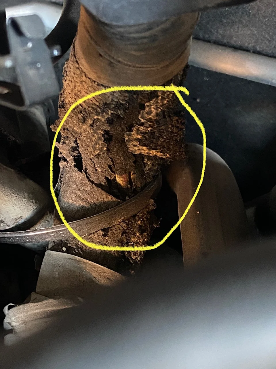

If you haven't solved the misfire issue, check your main engine harness near the EGR. It is known to melt the wires and cause shorts.
I knew what you meant, just wanted to know where you heard it. I've been running 80 lb*ft on my cone lug/alloys since I bought it.
I got it from This thread where @cruiserdan says
“Depends on the year.
94 and prior, with conical steel inserts are 109 lb-ft.
95-up with shank lugs are 76 lb-ft.”
Crazy thing is they sheered off again a few months ago but I’ll get into that to that in a later post when I’m back at the computer.

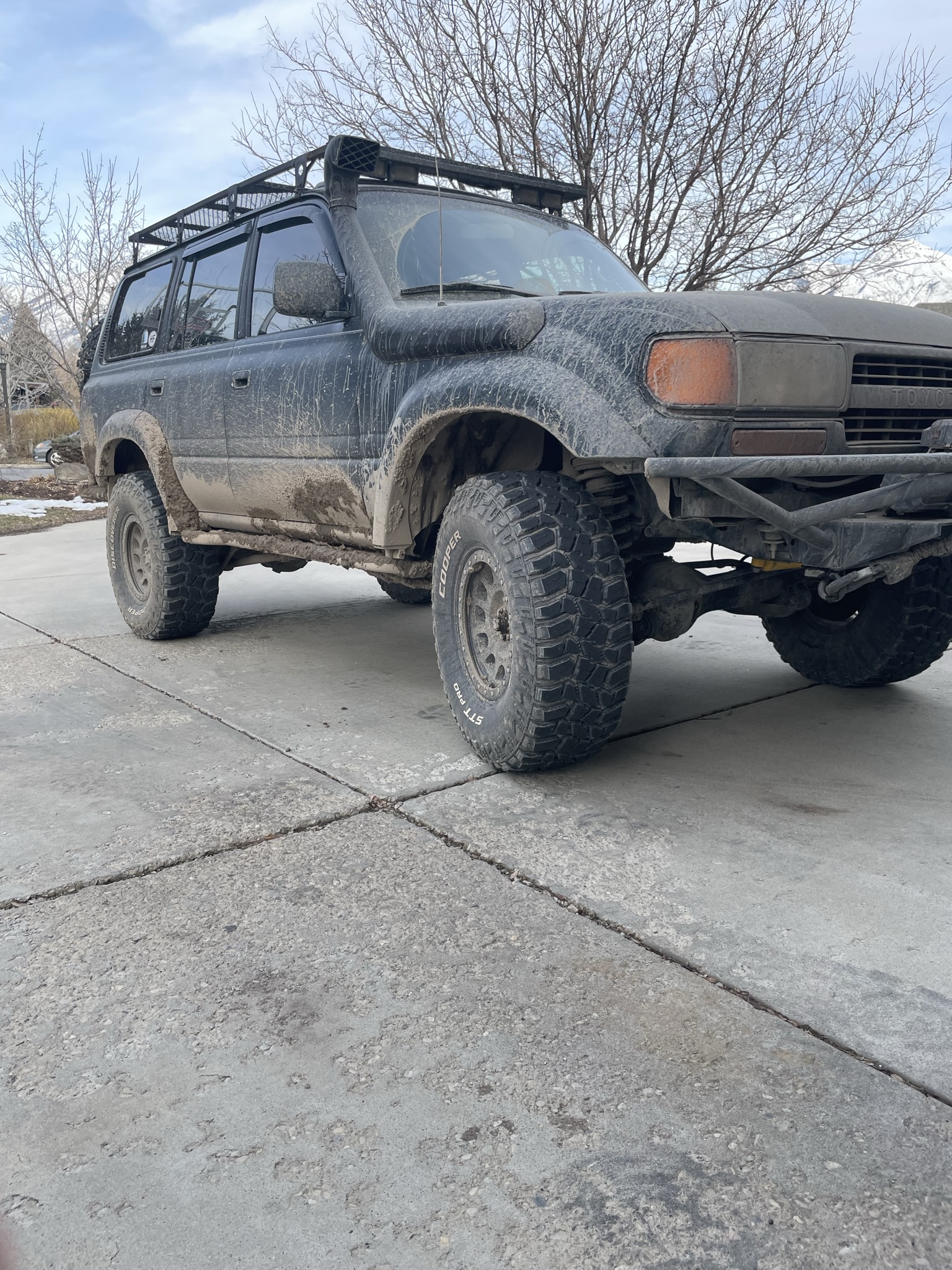

After repairing the fender, Fall came and apart from the check engine light for an 02 sensor the 80 was running well. I took on a little project to make sway at quick disconnects and had fun testing those out.
Drove it all through the winter only problem was a check engine light for the 02 sensor that I solved with new ones only for it to return the next day. I believe the signal wire may be damaged on the outside one. Went down to Sand Hollow for the offroad games and came back and it passed smog even without the functioning o2 sensor. Off-road games were tons of fun and I enjoyed wheeling in sand hollow.

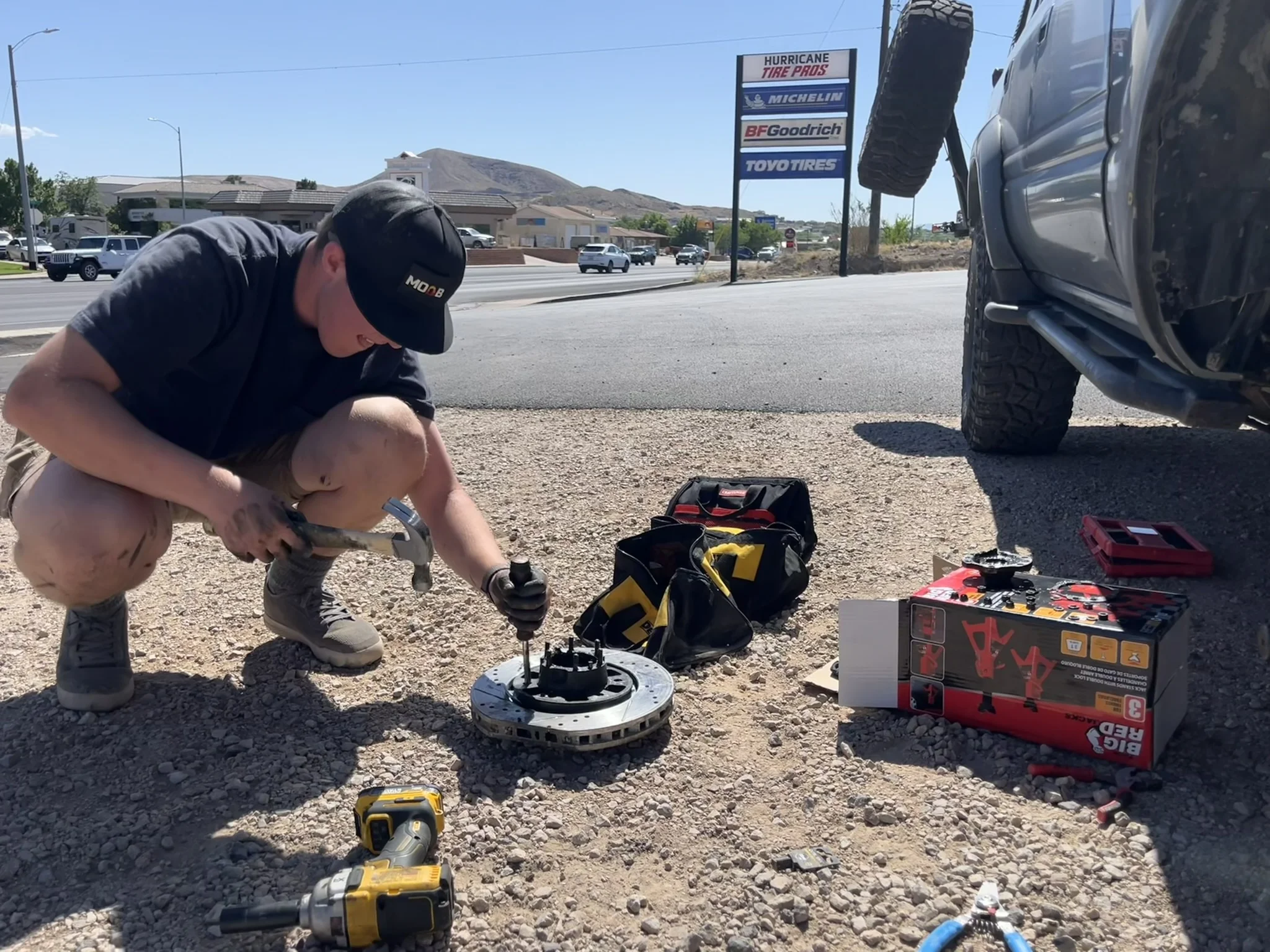

My best guess is maybe the studs that were in there from the trail mator repair were not very good quality and I should have torqued the nuts upon arriving in sand hollow since the wheels had just recently been off from the brake job. As soon as I returned home from the whole ordeal a matching rotor was put on as well as new Toyota wheel studs that I put in with an air hammer.

I would definitely check the main engine harness near the EGR, they are known to melt.
