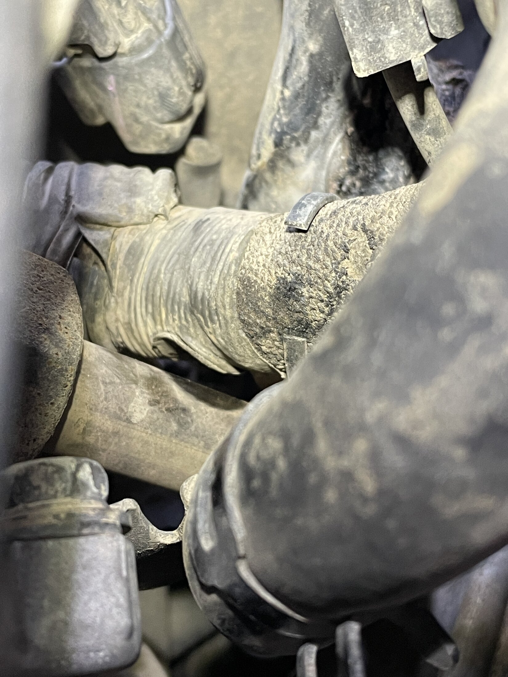

I would definitely check the main engine harness near the EGR, they are known to melt.
Hard to get photos but there is definitely some melting going on. It hasn’t broken the surface but any melting at all suggests posible damage underneath. Open to any suggestions or links to good ride up on the best way to inspect/repair this.
I would be concerned about that U shaped melting spot right above the EGR tube. Even though it doesn't look as bad as mine you can't be too careful.
As far as right ups, there might be one but the real only way to fix it is to replace the whole harness with a known good one. Check the part out section of the classifieds to locate one as they are no longer available. Keep your original one and repair it as you have time. Solder the connections is the best way to fix the splices.
To check the harness I would start the car up, let it get to operating temp and then move the harness around to see if there are changes to the way it runs.

That’s the same spot i noticed. I will try moving it and maybe sticking something to shield the heat temporarily to see if that helps. If no change is found I’ll have to dig more into the harness.

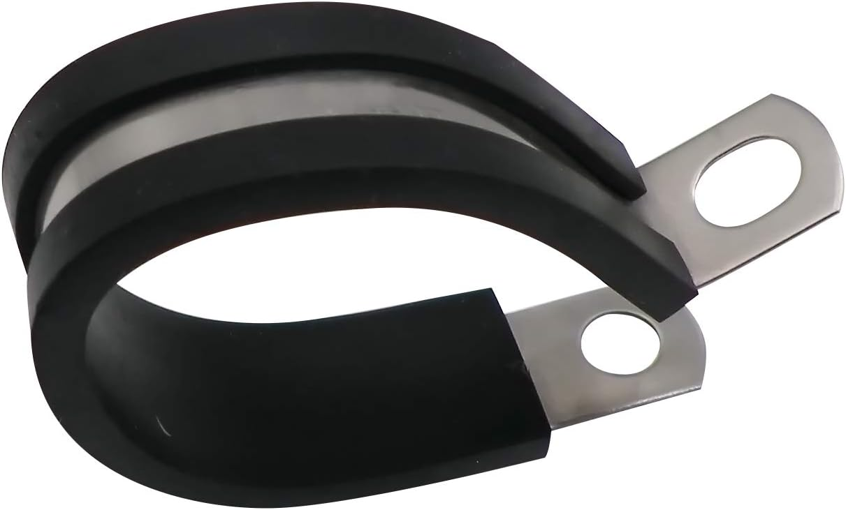

I am thinking of getting something like the picture below to secure the harness using the valve cover bolts.
As far as protecting the harness itself I would use this.
