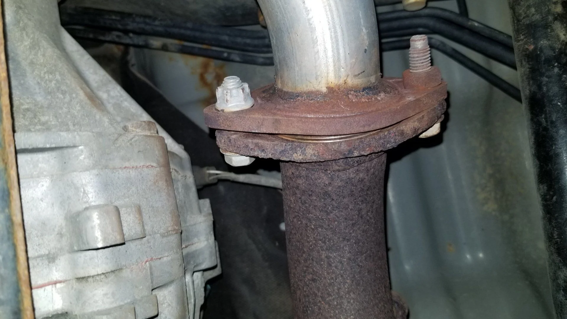

That connection doesn't look great at all, but I don't have any metal fab skills to fix it up
Given your description and that pic, I'm guessing your bosal isn't sealing correctly. My fitment was dead on, but @JunkCrzr89 seems to have had similar non-fitment issues.
I'd take that to an exhaust shop. Should take them a hour or less to cut and re-weld as needed to get that sealed up.
