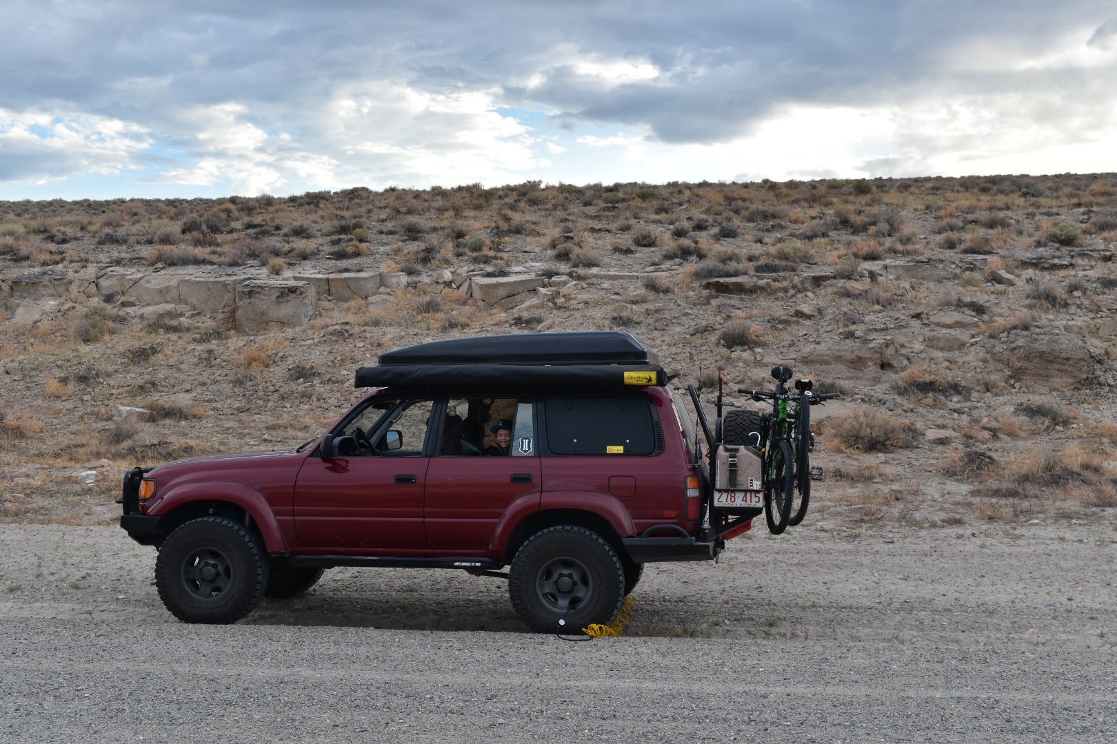

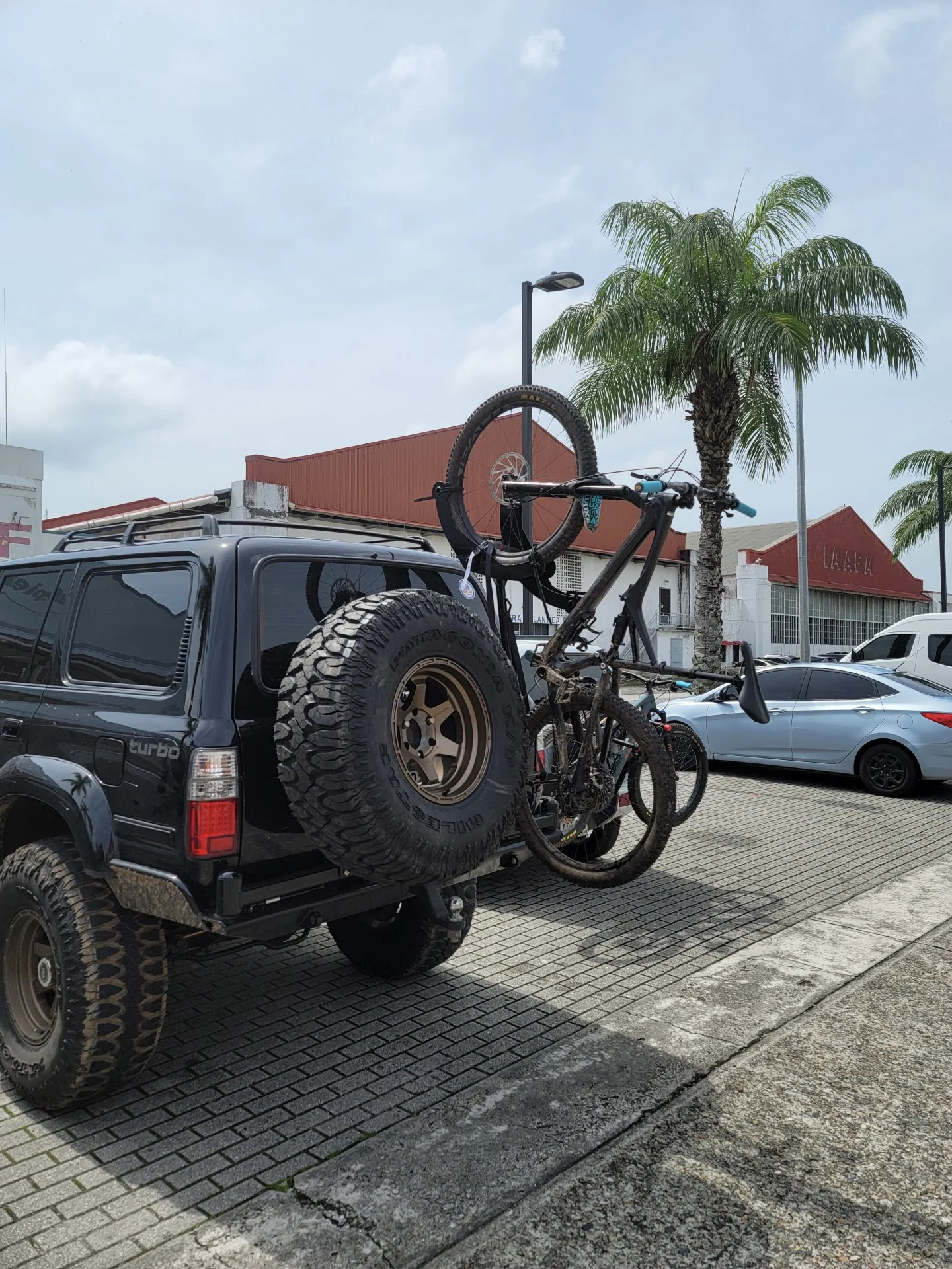

I did something similar on mine. I built a rack that clamps to the step of the 4x4 Labs ladder on my swingout. It required me to remove the front wheel, which was fine for awhile, but once I moved to a bike without a quick release and the rest of the family began MTBing I moved to the Northshore rack that @Marco Lau suggested.
I'm now in the process of fabricating a new rack for the swingout ladder to carry just two bikes. I'm using the DIY handlebar hooks available from Lolo Racks:

Ladder rack:

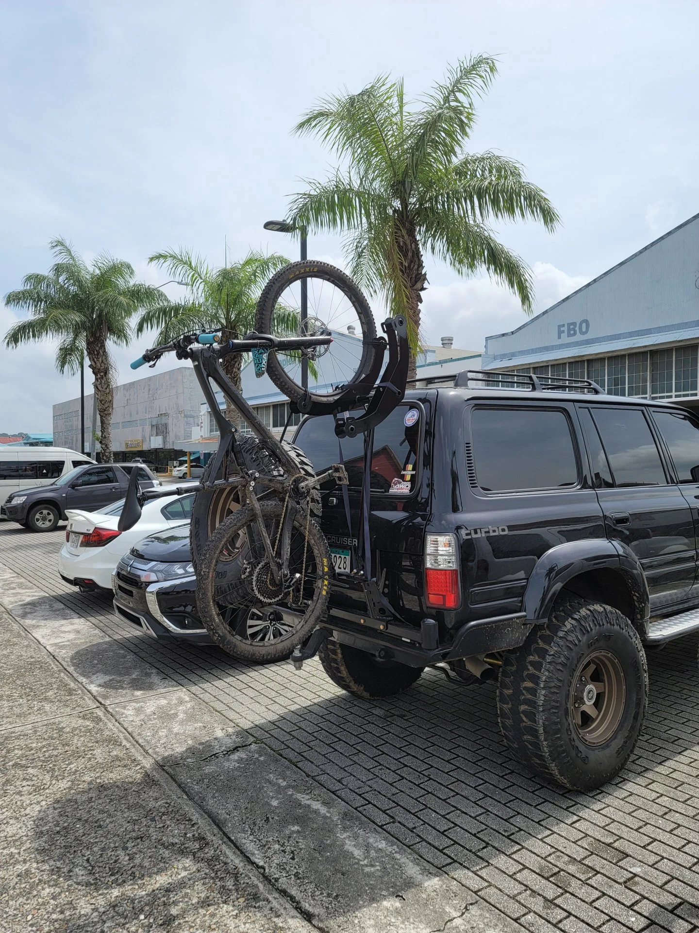

Northshore:

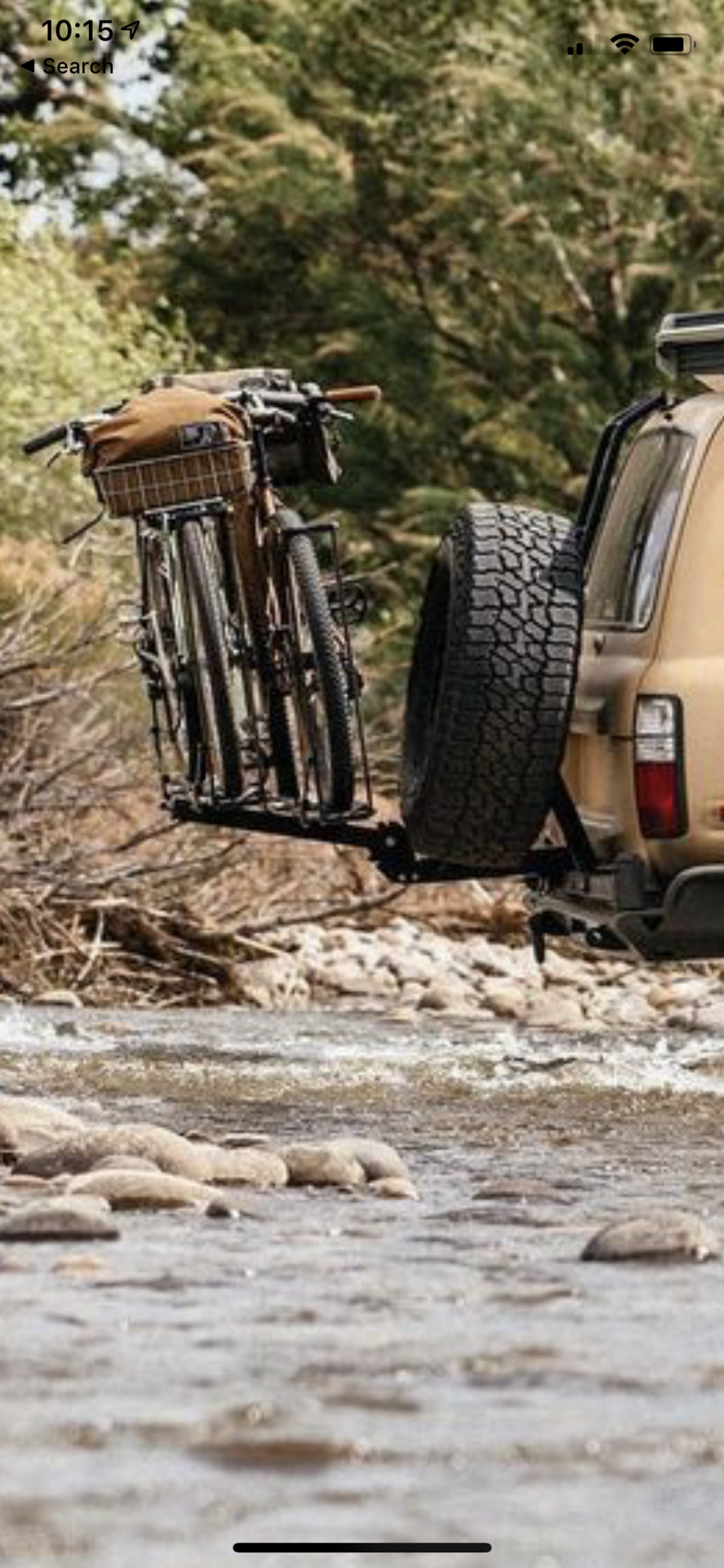

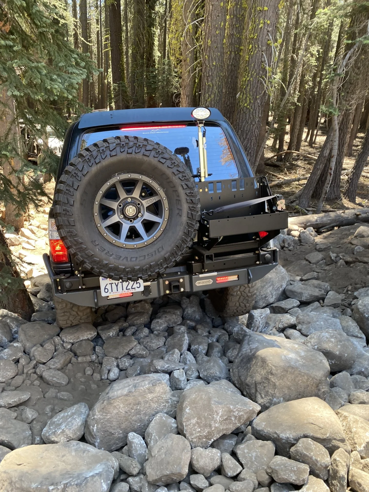

A few folks have done what you describe. Stole these pics from John Watson from the radavist. 2” receiver welded on to a Labs bumper.

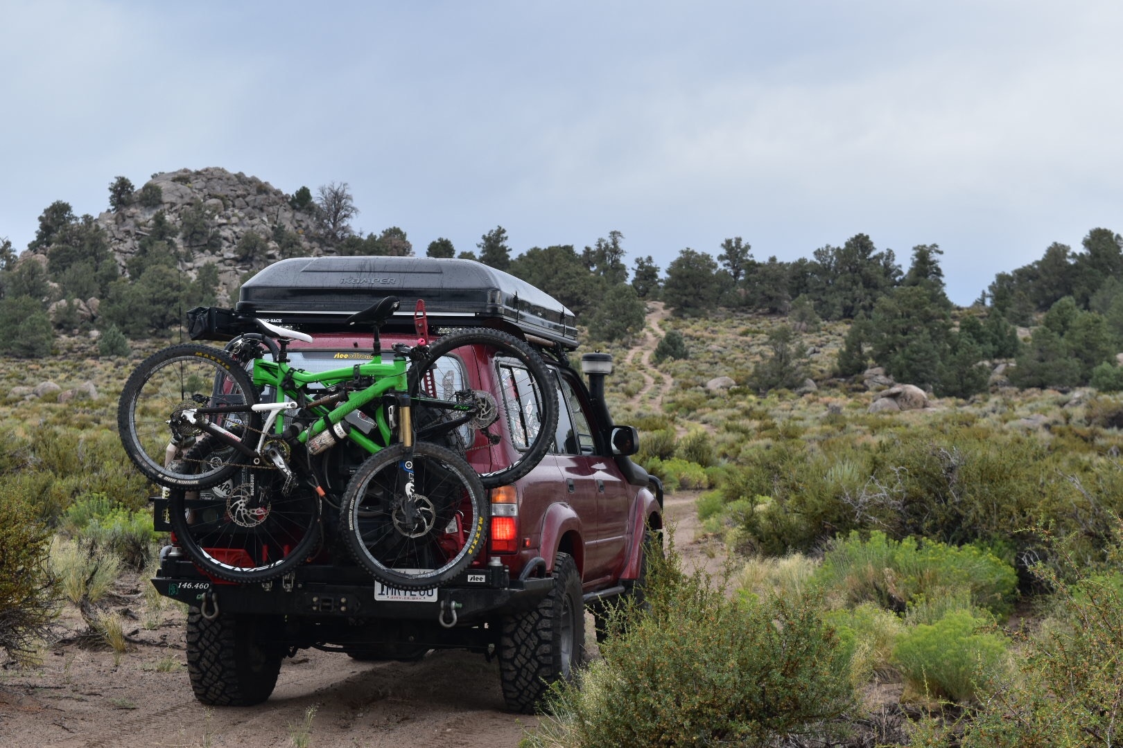

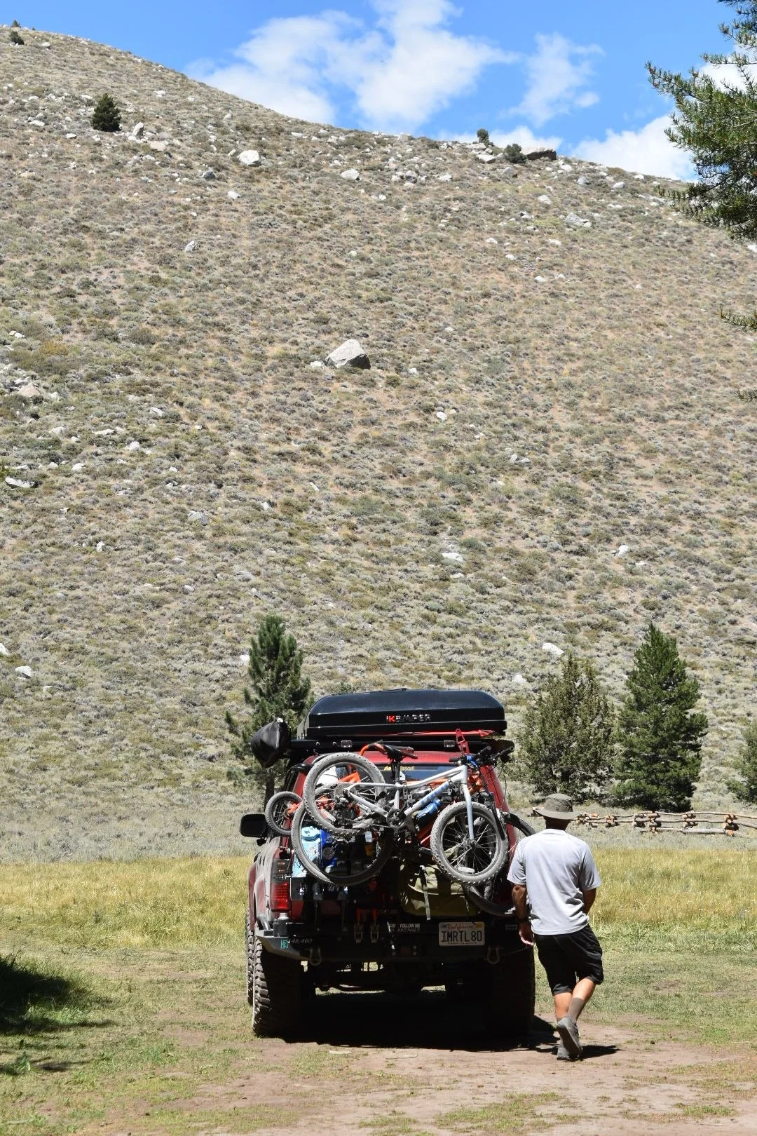

Take a look at this thread that I posted a while back. I ran this setup until I bought a 100 with a hitch. The spindle itself seems up to the task, but the long square tube seems to flex quite a bit. Didn’t lose a bike, but it’s probably not “my” preferred way to do it...

Northshore:

I welded up a 100series 4x4 Labs bumper for a friend and welded on a stinger just like this for his mountain bike. He said he got a lot of flak in the 100 series forum saying it wouldn't be strong enough but in real world use he had no issues with his bike rack and bike on the swing arm.

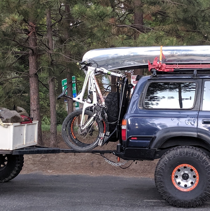

My 1up is loaned out to a friend this week but I'll share a photo of my setup next week. I just use an extension in the receiver on the bumper. It interferes with the swing aways but is not that big of a deal.

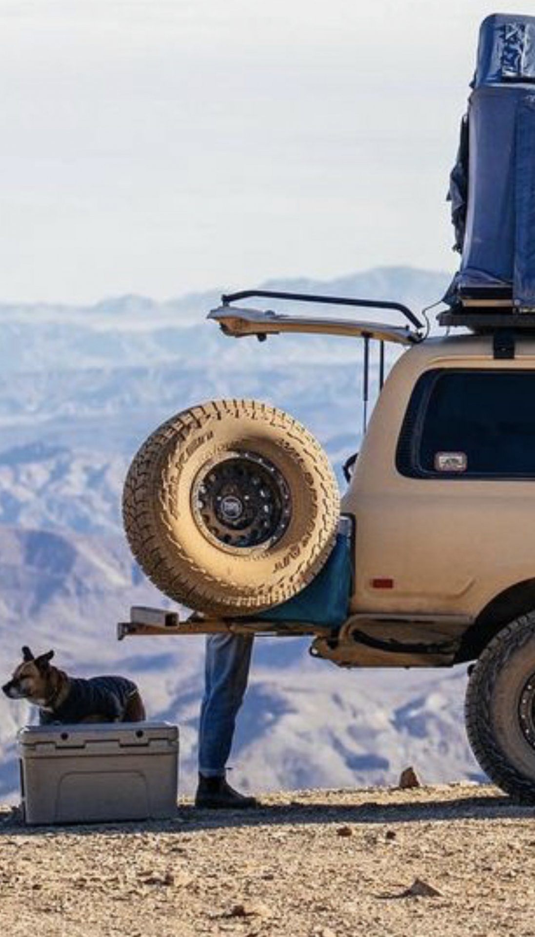

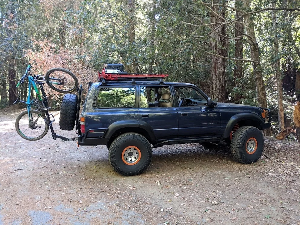

I’ve made due with this Hollywood rack. Takes a little longer to mount and unmount the bikes but is the lightest setup for 1 or 2 bikes and still allows full swingout. I still would like to try welding a 2” receiver to the Slee swingout arm and go with a real mtb hitch tray rack.
