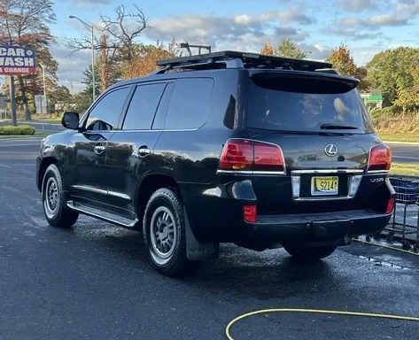

2011 lx570. No mods other than wheels (rock warriors with Michelin ms2s 285/70r17) and a half iron man sliding drawer in the back instead of a seat.

Your avatar pic shows you have a roof rack add on mounted. If you still have it on, that would be a major source of drag.
