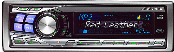

I have tried both the Monster and the Belkin FM Transmitter in my 80 and wasnt pleased with either. I made the decision to go with the Alpine head unit and adapter, so i can run the entire ipod from my head unit.
I am replacing the stock head unit with the Alpine 9851:

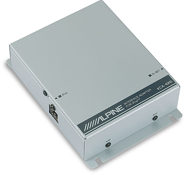

I am also adding the Alpine adapter (Alpine KCA-420i) for the ipod so that i can plug the ipod in somewhere hidden and forget about it. The adapter allows full ipod control as well as charging!
Should be all installed by next weekend and i will post up the results!
Any questions, feel free!

I have the alpine with the iPod hookup in the glovebox. I really like the setup but my major dislike is the fact that the the playlists on the head unit only support 255 songs. You can still play all of you other music but the playlist will only allow you to search through 255.
