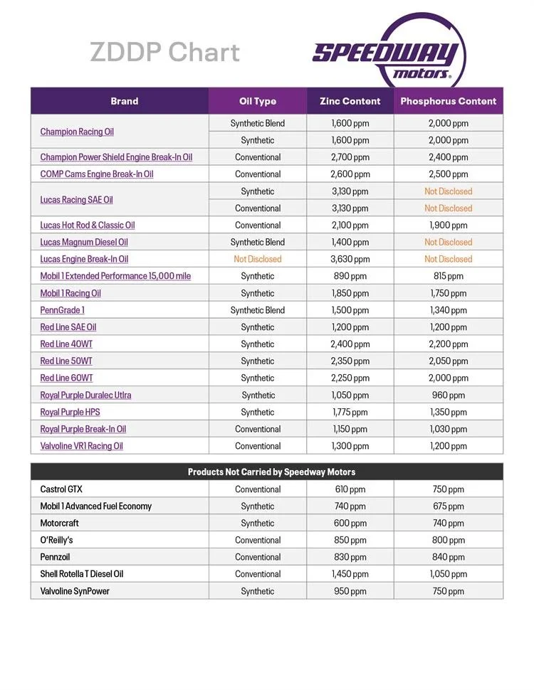

Amsoil is not API certified, refuses to meet API standards and testing.
Phosphorus levels are 5-25% higher than API standards.
Phosphorus is a main anti wear additive for all oil mfgs, but at the increased levels that Amsoil uses it increases the acid level in the oiling system and causes exhaust degradation to the catalyst system. Don't get me started on the cost to replace these components these days.
High performance engines that get rebuilt after every 1-4 passes for a quarter mile run are one thing. There is not a single NASCAR, Indy, or any other longevity required engine that uses Amsoil. Never seen a Amsoil sticker sponsoring on any of these.
Snake oil at best.

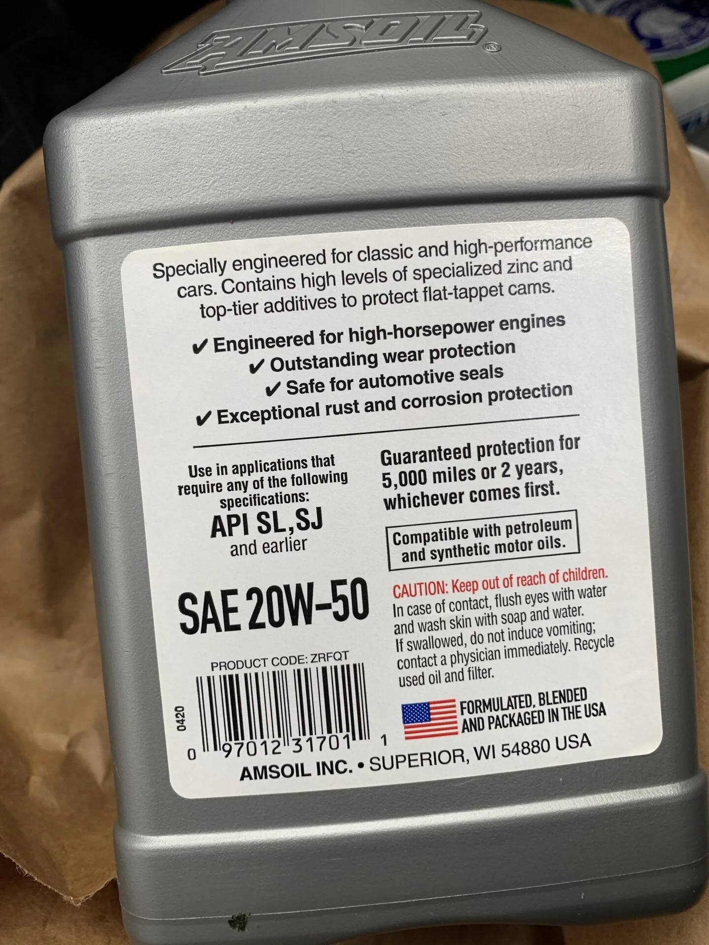

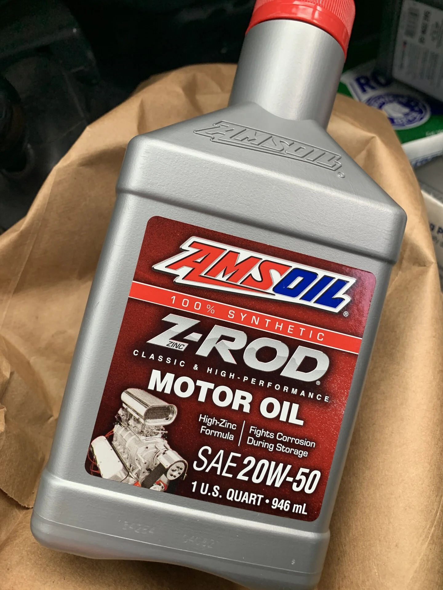

API - American Petroleum Institute
Increased acidity levels cause damage to all internals, but eat at catalyst media more. The longer an elevated acidic oil/solution is present the more degradation it causes. If you have a 60 it should have a catalyst system per federal regs. But that's for another discussion.
I've never tan 20/50 in a 2F or similar, especially in a cold weather climate.
But the most comprehensive " high content" zinc oils the early motors need..
I can verify it doesn't work.
but did you do the dip method or take a shot
seriously though...
the signature series IS really good stuff, the rest is just ok
and there is better than severe gear for sure
