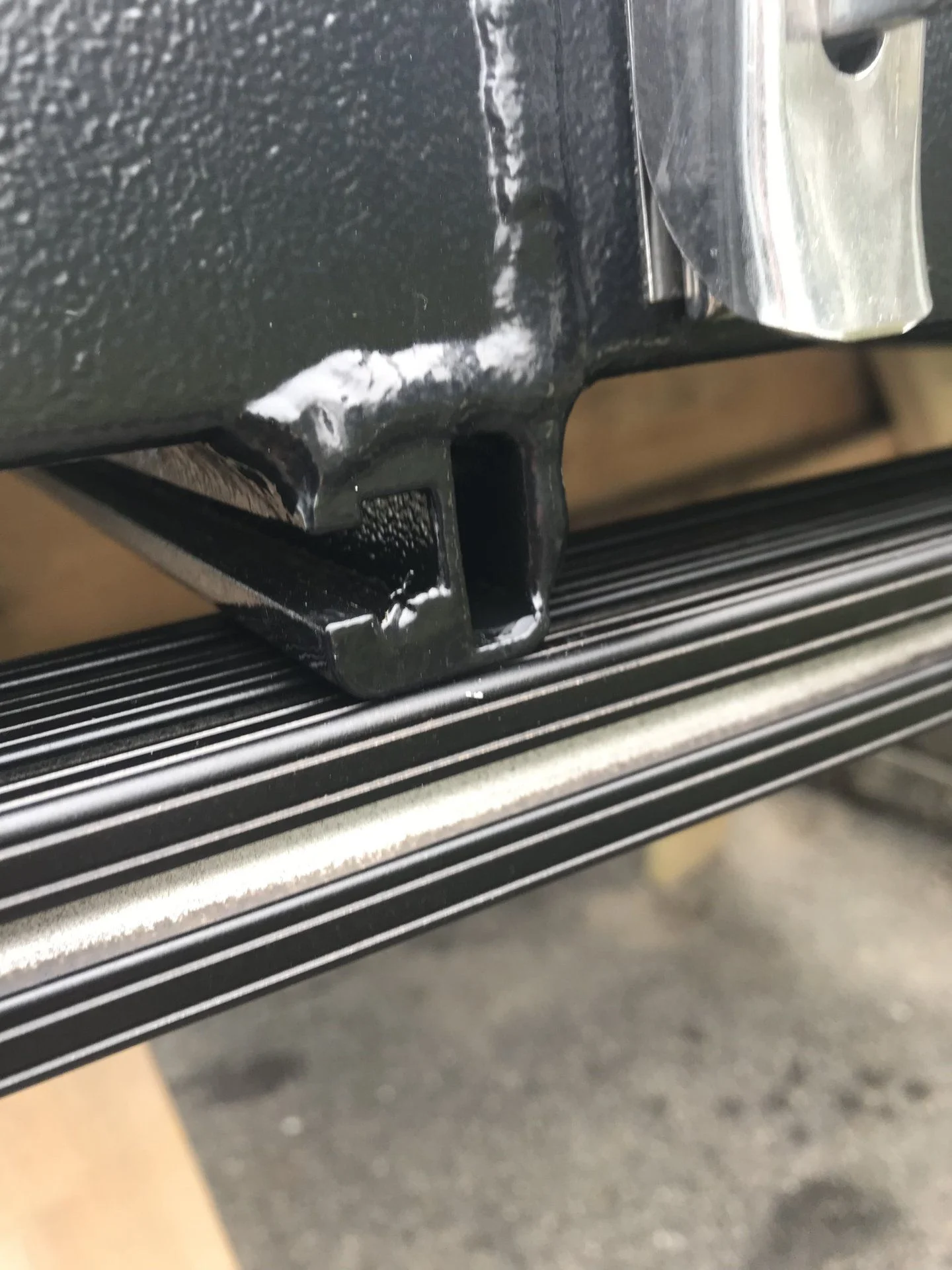

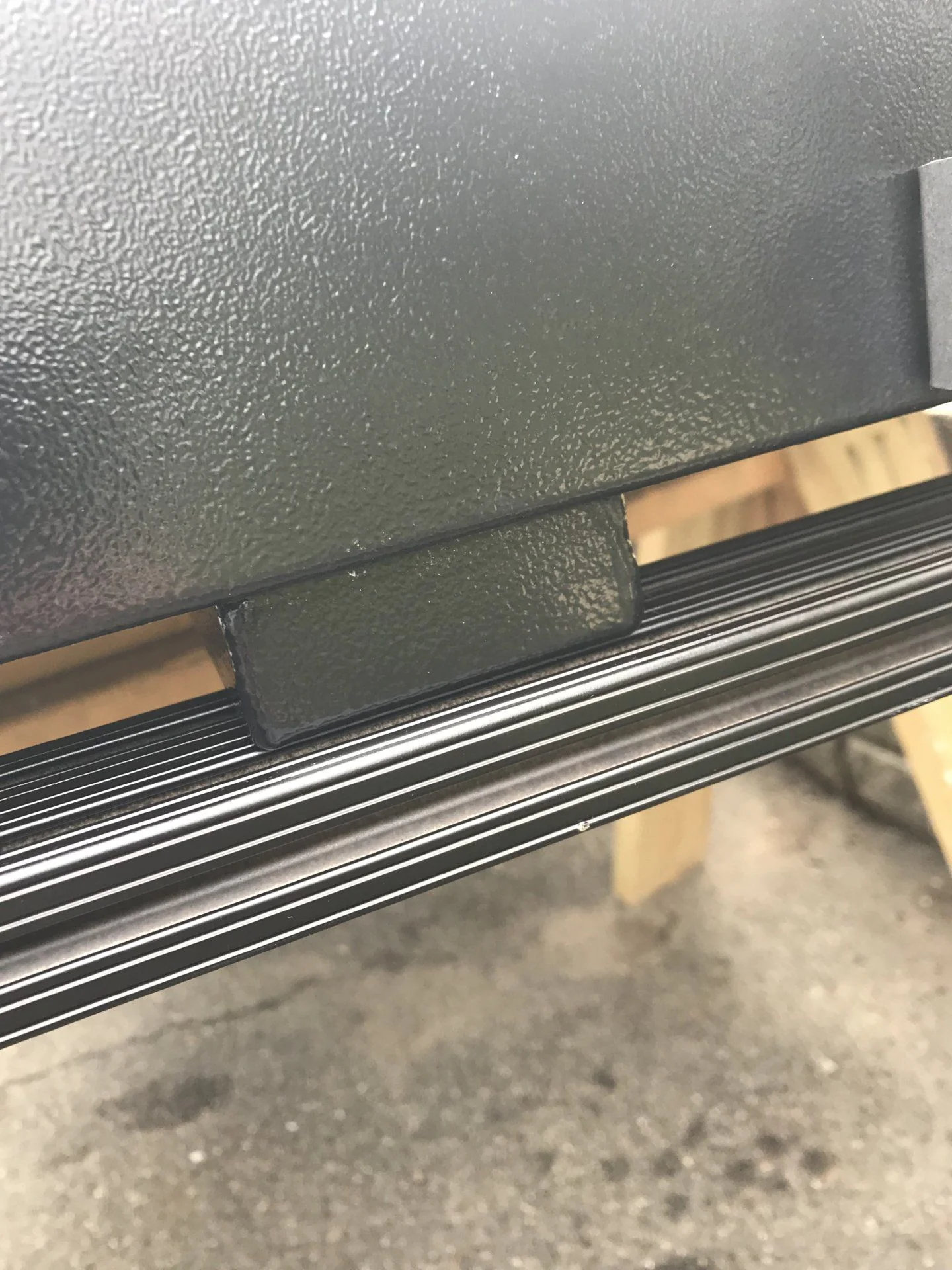

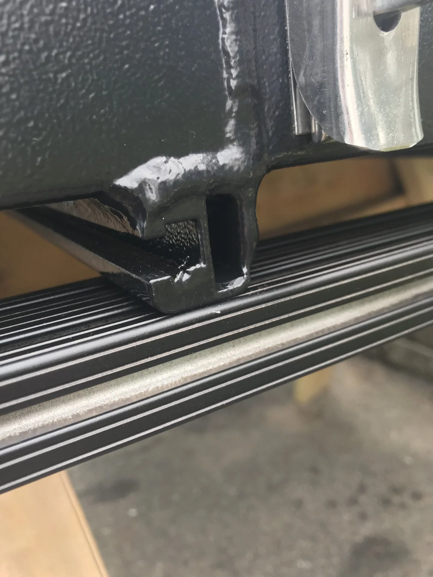

I have a prisnu style rack so flat aluminum cross bars and I need to fab up some brackets to hold the alu cab down on it. But I cannot find anything ready made. Does anyone have a solid idea. Not ready to cut roof off yet here’s some pics of what alu cab gives you to mount from and what I’m trying to mount to. Thanks
Here’s a couple more it’s a terrible mounting point.

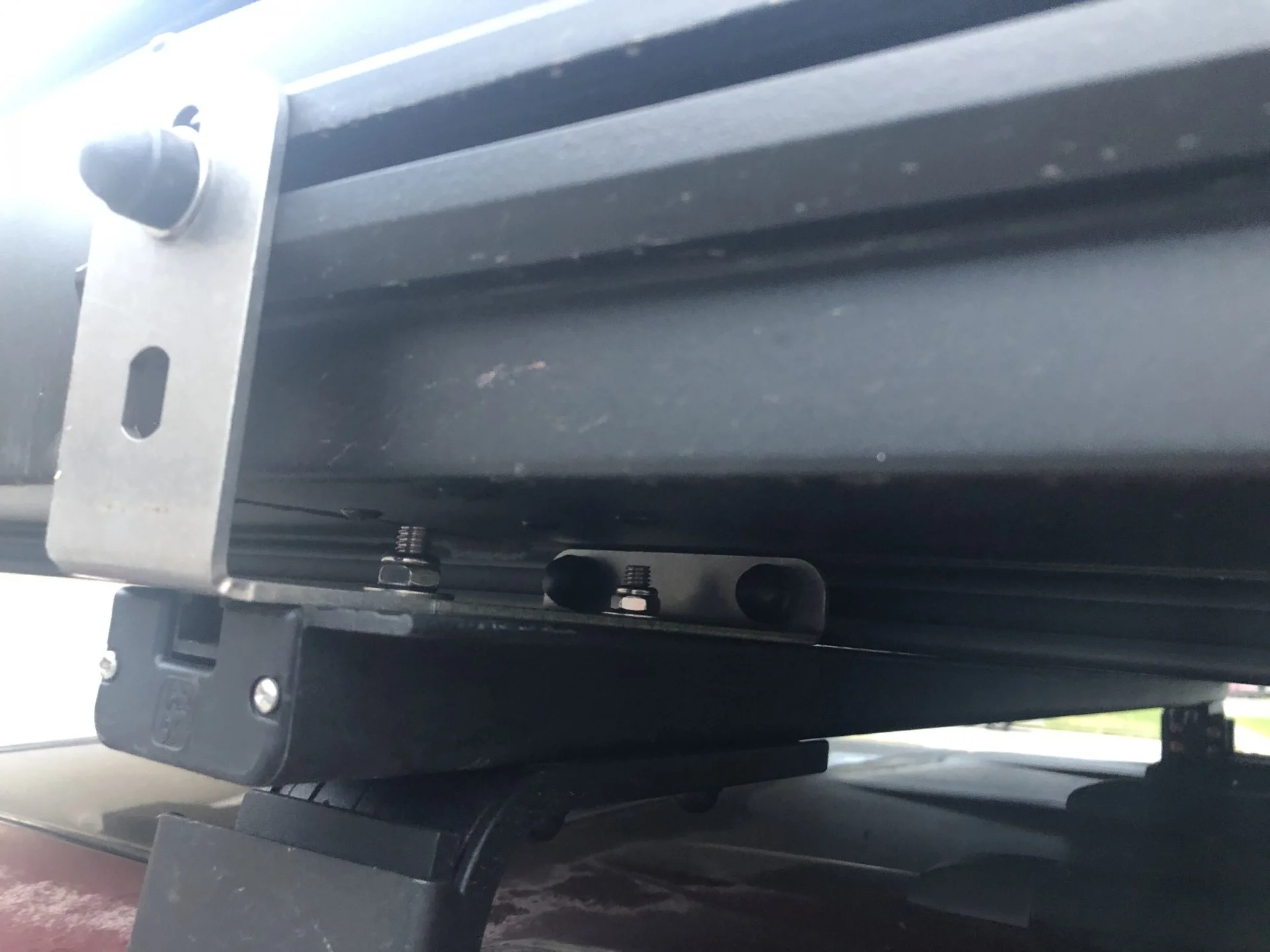

Was there not a way to use the supplied brackets? You really only need to use the two brackets on each side. I mounted mine to the Alu-cab load bars, but I had to use 3 bars since the 100 series stock rack mount are too close together.
Yes Im using the supplied brackets your showing but im using them underneath on a prisnu style rack.

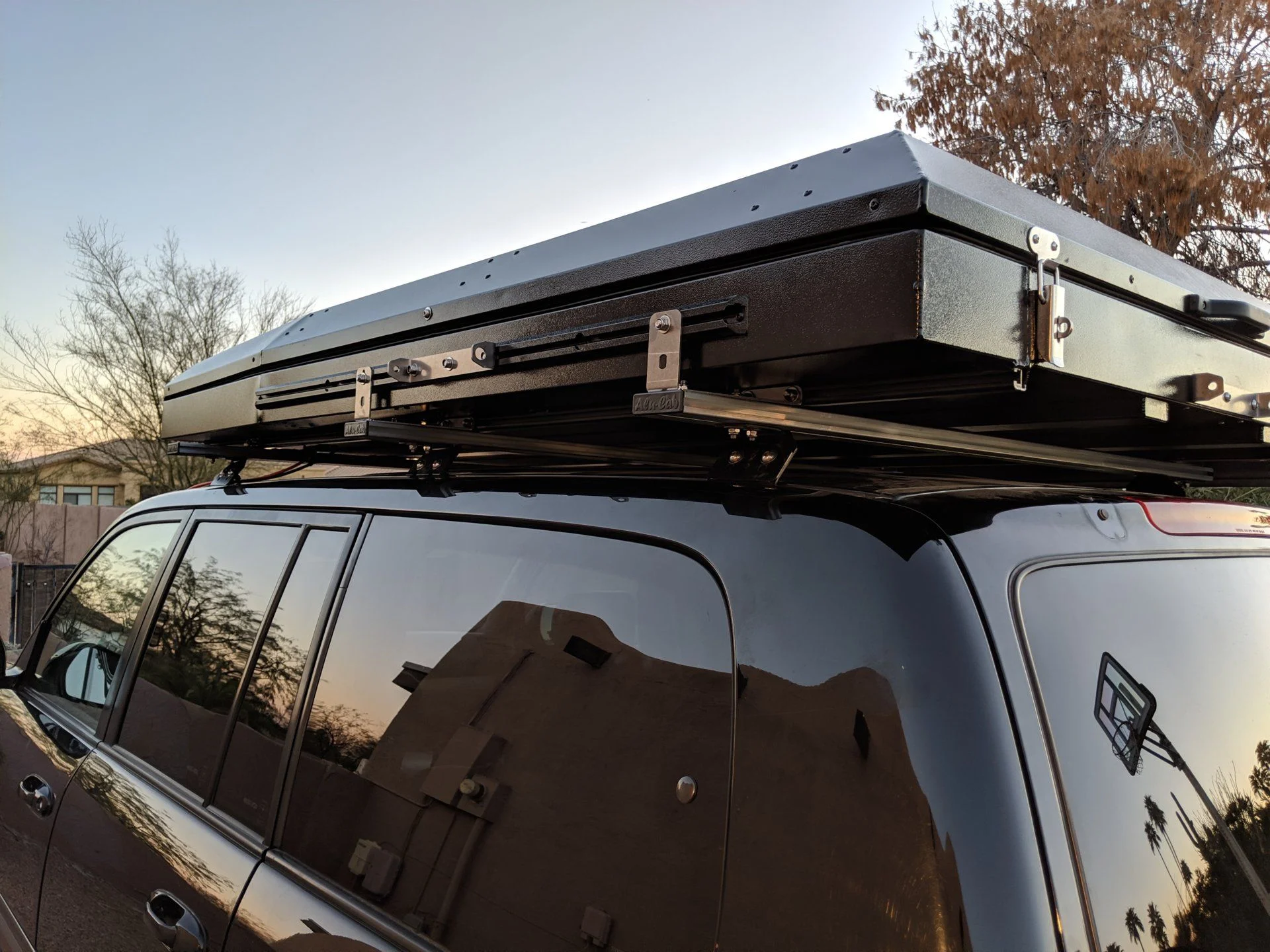

i think you see mounts here. I used what alu cab supplied and you cant see them unless you look under RTT

There are pics of mine mounted on 3 load bars up above. I now have it mounted to the Dissent roof rack. I was able to use the supplied mounting brackets and the hardware built into the roof rack. I did use some homemade brackets at the front, which I'd made for the load bar setup. Those are basically short pieces of 1 inch angle steel from Home Depot. It's worked out pretty well for me, and it's super solid.
