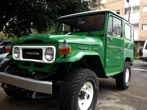

Take a search on "esmeralda". i am doing a true frame off on a Colombian Cruiser FJ40. I am nearly finished. We dont have many FJ45 pickups here for some reason. I have personally seen over 25 trucks for sale here and I liked about 2 or 3 of them. Granted I was looking for a rust free example to export for a business. I am pretty certain that those great looking in photos trucks are not that great in person.
There are different prices for different levels of quality of course. And disclosure is everything. I am showing off everything bec I want to build a good reputation. I don't see that having something painted down here is necessarily bad but why not say where it was done? In fact I think that the restoration can be done as well or better than the USA.

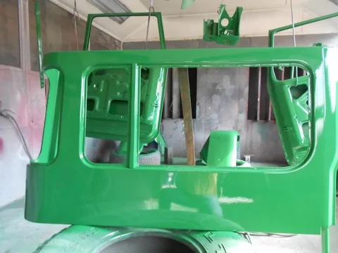

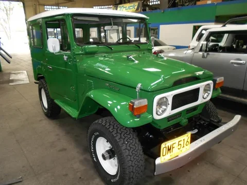

Here is my 1983 FJ40. Frame off engine out. 6 layers of PPG brand paint. no bondo, paint booth and parts painted separately.
Not to highjack the thread I just remember oogling over those trucks trying to figure out what the market is doing and whether they were really nice or not. Any comments or criticisms will be well received. if not for this forum my truck would not have turned out nearly as nicely.

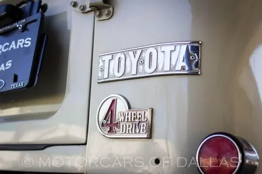

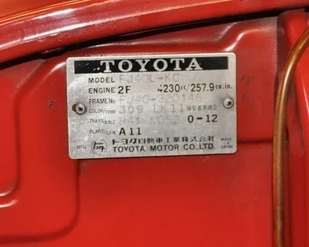

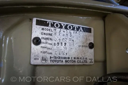

That Troopie is nice looking but I'm a little surprised that someone would go to the trouble to paint this truck and then decide to just rivet the old emblems on. I seriously doubt the mileage with all the restoration work that has been done. Where's the spare tire carrier? Lastly, what is up with that ID tag? It's not right. It's screwed on rather than riveted and the color / trim code is 8012 which is not a code I can identify. The stamping is not right either. Compare it to the ID plate from a Freeborn Red 1980 Colombian truck I have. Something strange going on there?:meh:

I was looking at the tan troopy as well and the data plate looked suspect to me too, and I'm new to Land Cruisers. It reeked of "gasoline overhaul".
