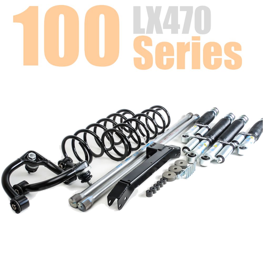

Hello Everyone,
My right and left front shocks are leaking to varying degrees. I had pretty nasty fluid so I flushed the AHC system. Everything seems to be working again and it’s definitely smoother ride now, but I have a feeling it’s getting close to that time where the decision will be whether to keep the AHC and refurbish / get new soft goods and bushings, etc. or take it all out and put in a replacement kit of some sort. This is the main kit I’ve considered as a suitable replacement:
What do you all think? I don’t really need or want the 1.5” of lift just leaning that way because bilstein makes a great shock and slee has put together a nice kit that I feel might be possibly better on road than what came from the factory 20 years ago. If you have other recommendations for a full time daily driver on road 90% of the time 10% light off roading camping etc. I’d like to hear what you think and which way you went - keep AHC / refurb as much as possible or replace it with a nice kit?
