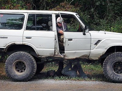

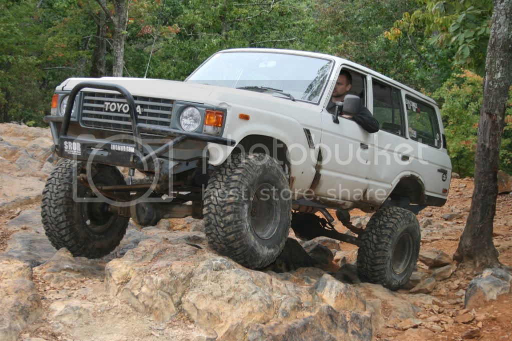

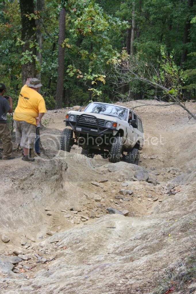

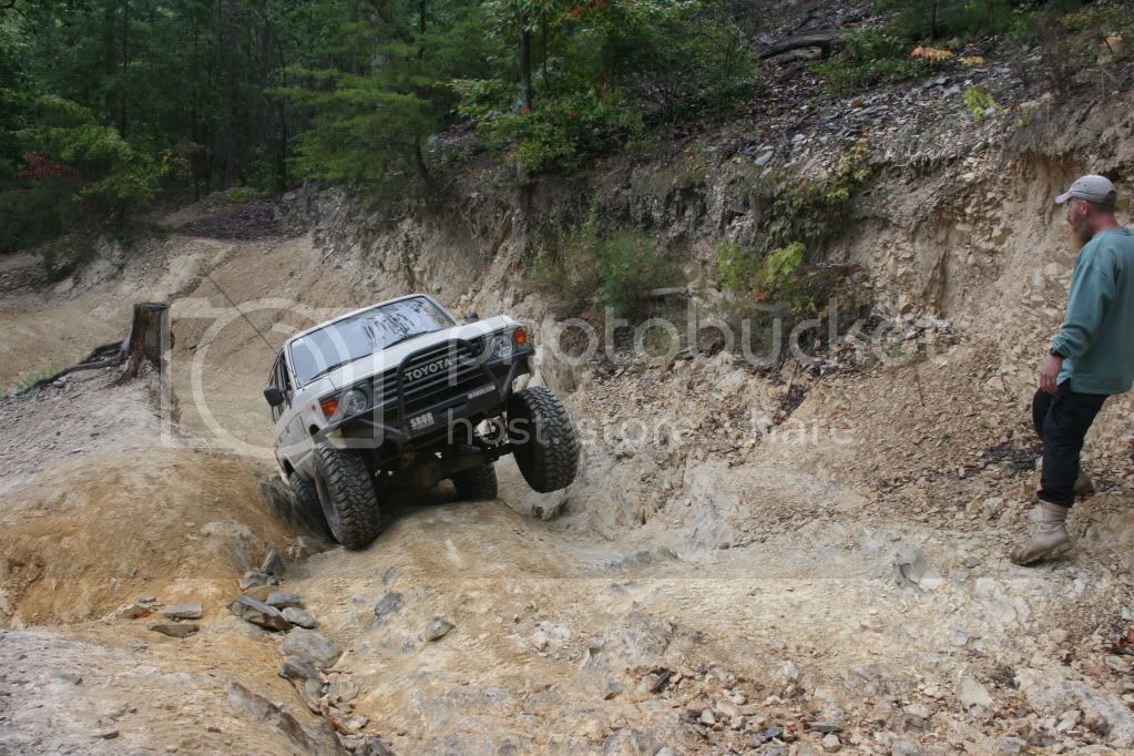

ONSC had its Cruisin' Carolina event this weekend, dedicated to Logan Monk ( RIP ). It was a hell of a time and Al ( lt1fire on mud ) did a hell of a job organizing it. I met a bunch of awesome people and got to wheel some great trails. Didn't break a single thing and all I can say is that Moonshine can CRAWL! I'm super impressed with how she performs with the wider stance and e-locker. T-case is leak free and running strong.
Here are some pictures and a video or two:
More to come in the next few days as they keep trickling in.
Very nice flex. Your suspension is working well.
Looking forward to more.
Rear springs are still too stiff but I'll take out a few leaves and then it should perform like the front.
Thanks for the kind words sir, I'm pretty happy with her:D
Also, I forgot to mention that my tires rub badly on the front fenders, so bad that the outer lugs are all cut up from this last weekend. The fenders are going to be opened up soon.
