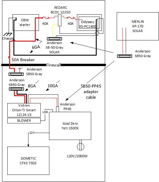

This is almost exactly the approach I took. I have a 3 battery system.
I have a 2nd AGM battery connected to a REDARC 1225D under the hood and a Goal Zero Yeti1500X solar generator which sits wherever it's put. Either can be charged via the alternator or solar using an Anderson SB-50 connector. The same solar panels that charge the AGM 2nd battery via the REDARC also charge the 1500X.
The Goal Zero 1500X primarily runs the Dometic 75LDZ fridge/freezer direct DC and anything else via the inverter and USB ports. I suppose I could have rolled my own like you did but chose not to.
While on the road I charge the 1500x from the alternator (6GA wire through the firewall on the driver's side) via a Victron Orion 12-24-15 charger set up in power supply mode at the rate of about 360W. I use a blower to cool it, otherwise it gets hot and drops the current. NOTE: Goal Zero also makes a car charger that charges at a higher wattage (600) but it wasn't available when I put my system together. This setup has worked very well for us for over 2 years.
There is no downside to the modular approach that I can think of - but I'm biased. The biggest advantages to me are when you're done traveling it all comes off the truck and it can be used for hauling whatever. We don't camp ALL THE TIME after all. :cool:
Another advantage to going modular is that the 3rd battery, the 1500X in my case, can be moved to where you need it. Want to run a chain saw or connect it to a blender to make frozen margaritas on the picnic table? Perhaps there will be something unforseen and you want power. It's easy if you can take your battery anywhere and it' not bolted to the truck.

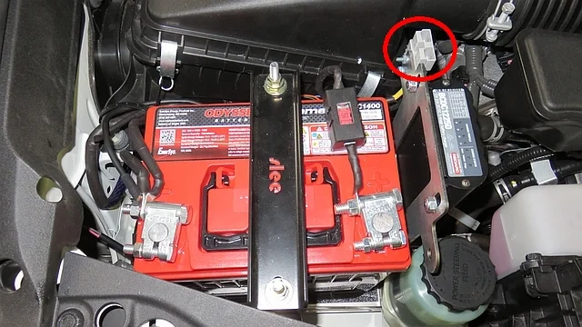

Under hood - REDARC 1225D on SLEE mount, solar hookup circled:
Overall electrical concept:
