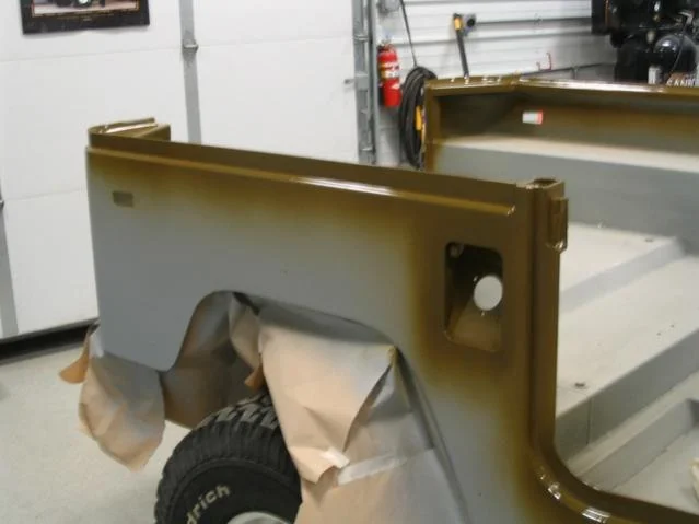

Again got a lot done last night about 5-6 hours of work and drinking :beer:…. I had to tape everything off and I sprayed 2- 3 coats of sand able primer. Let that dry and lightly sanded out the edges and what needs to be painted to put things together…. I also tried to hit a lot of areas where I know I would get runs… that way now once I get it all together I will wet sand everything down again before final paint to get rid of all the runs I caused as I knew I would… those “hard to get areas :rolleyes:” will not get wet sanded unless there is a run or something in them… which I don’t think there is…. Just around them… anyway I will be able to just hit those difficult areas with a simple light 3m pad as they will just get hit really light with paint anyway… that way I “figure :rolleyes:” I will have less chances of getting runs on my final paint….. Well since I have never done this before your guess is as good as mine…. :flipoff2:
Came out good….
Also put up plastic on everything to keep dust and over stray off everything… set up two fans blowing out…. Actually worked really well to clear out shop fairly fast… I was impressed and a little surprised to tell you the truth…

few after all paper and plastic is off...
