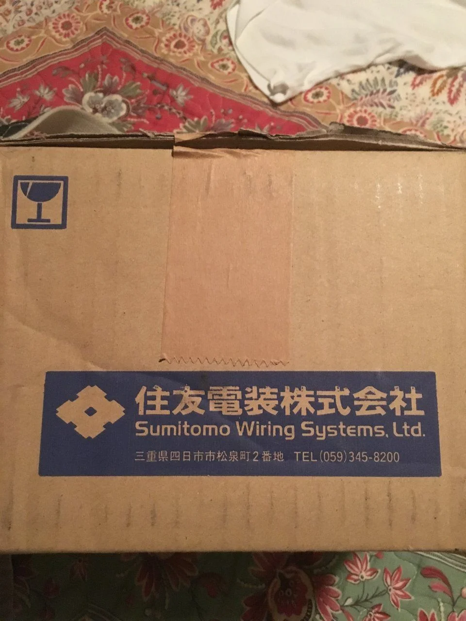

Ordered an 82169-60080 from ToyotaPartsDeal for $145.10 plus $11.07 shipping, no tax.
I hope the plugs come out easily.
