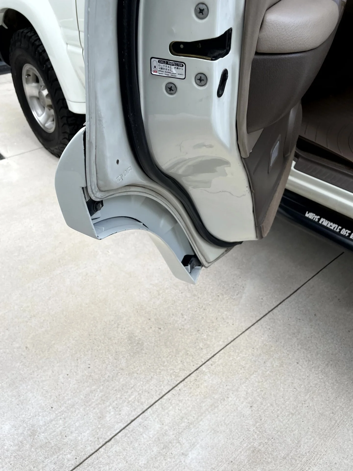

I recently had my fender flares reinstalled but it appears that the body shop might have missed some pieces reinstalling them.

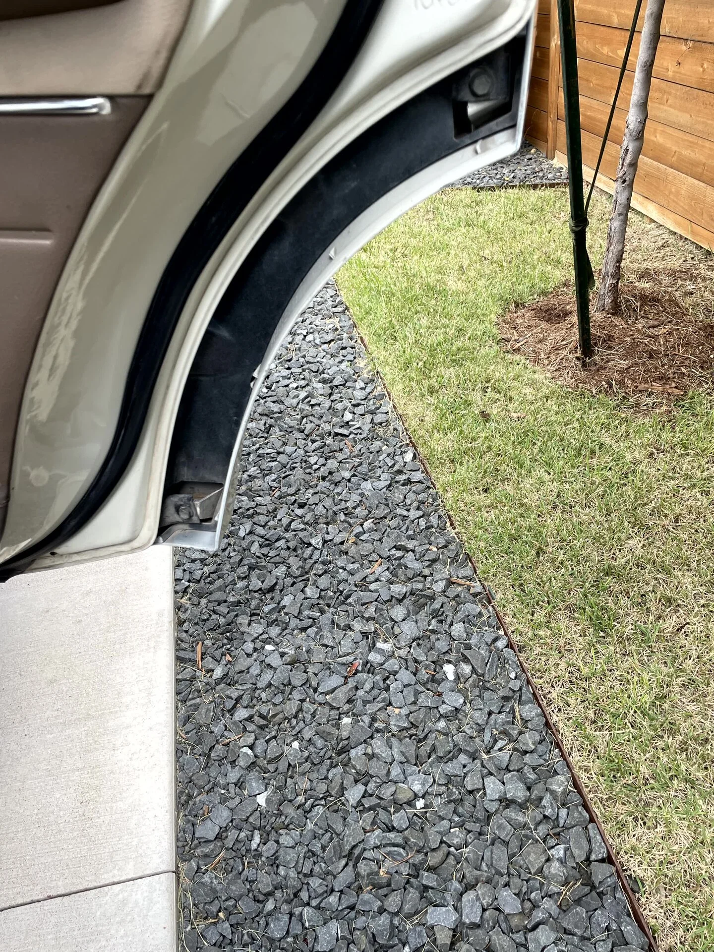

Does anyone happen to have a picture of what their rear door fender flares look like on the inside? The pics below are for a 1995 FZJ 80.
What I'm trying to figure out is: Am I missing just one piece on the driver's side (to match the one on the passenger side) or am I missing more on both sides?
And if I am, does anyone happen to have the part numbers for what I might be missing?

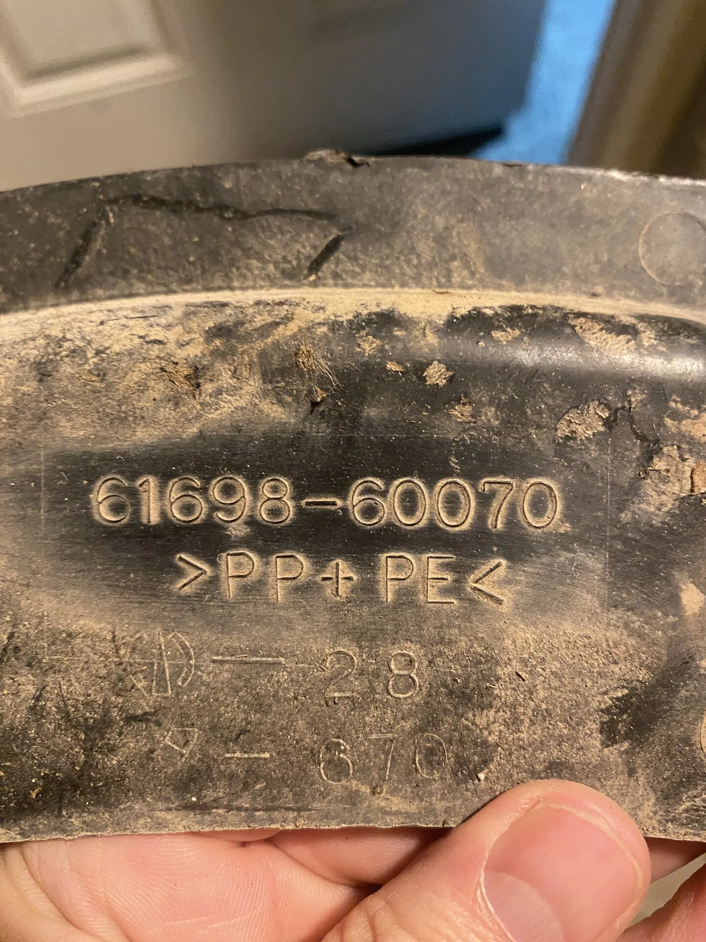

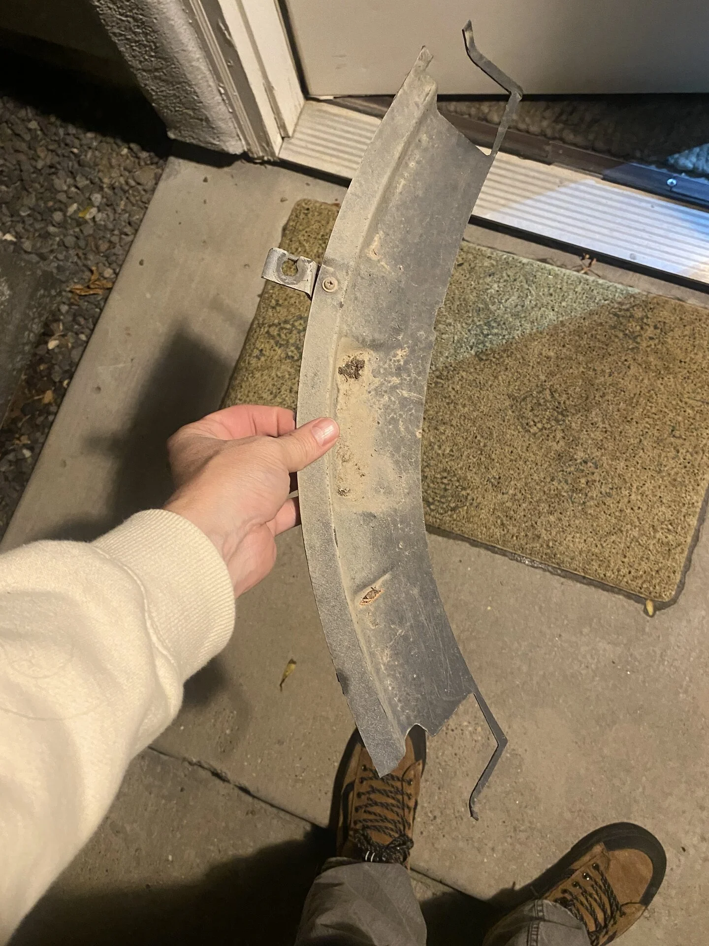

Amazing @ajax1! Thank you for that.
For anyone else that ends up looking for this, the part is only available as part of the entire fender flare arch: 61062-60903
