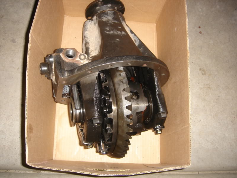

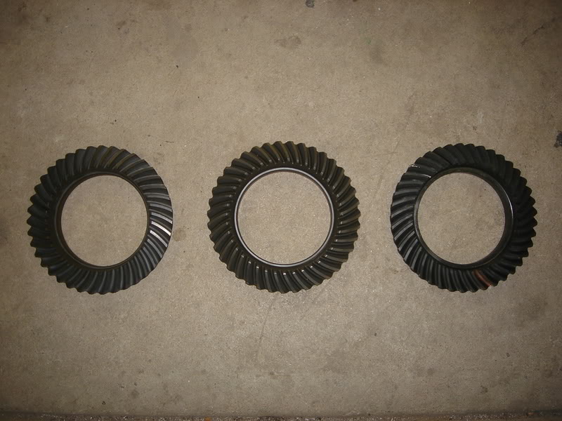

Generally no news is good news, not in this case. We got the rear set up, all new cryo'd bearings and tore the front apart and cleaned everything thoroughly. Bruce has photos as I forgot my camera the first day. Anyway, as I'm looking at the ring gear on the front carrier, and glance at my new ring gear I get that horrible sinking feeling. One is reverse cut, the other isn't! *#@*
I bought them from a guy who bought them from PORC. He never got a chance to install them, so I bought them at a discount (or so I thought). Anyway, PORC sent him the wrong crap (big surprise) and I had to order the right ring & pinion (from JT's of course). So I got boned assuming that PORC had sent him the right crap, and of course didn't realize that until I got mine apart. So hopefully my Precisions will be here today, and we can put it all back together and get things broke in.
On a brighter note, got my rear all buttoned up, axles back in, brakes bleed, a few other things completed, and just waiting on the front.
Moral of the story, for TRD Tacomas and 3rd gen 4rnrs, the rear is the same old school 8" with an e-locker (fairly easy to work with, as long as you have ALL the right tools). The front is a high pinion 7.5 clamshell with reverse cut gears.
So now I have a new set of standard cut 4.88s for the 7.5 IFS (i.e. pre 95) if anyone is interested, or knows of anyone else. Damnit.

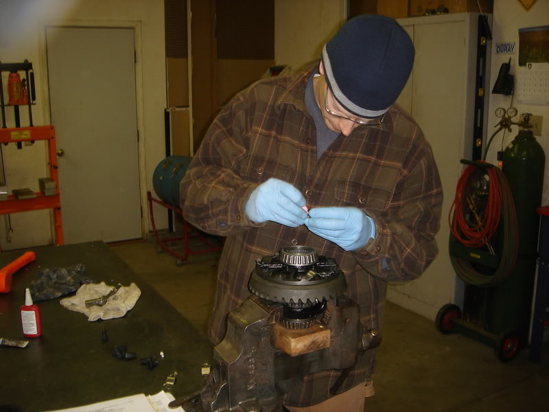

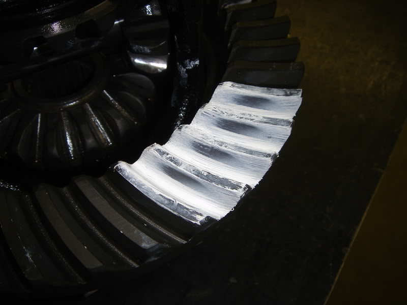

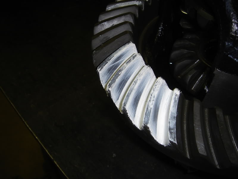

So shortly after I posted my woes, my new Precision gears arrived from JT's Diffs (less than 24 hours). Wow! Called Bruce and we were back in business. Only had to go to Eddy's for one part, a driver's side axle seal that they just happened to have in stock (and cheaper than others).
We had to make some special tools for pressing out and in the special shims, but now I have all new cryo'd bearings in. I was amazed at how well the front setup went, especially after all the horror stories of how hard they are. I was so happy I got everything buttoned up Sat night.
Sun I went out several times taking things easy, and heard no whines or unexplainable noises. So far so good. :bounce::bounce2: Diffs get warm, but I can hold my hand on them.
