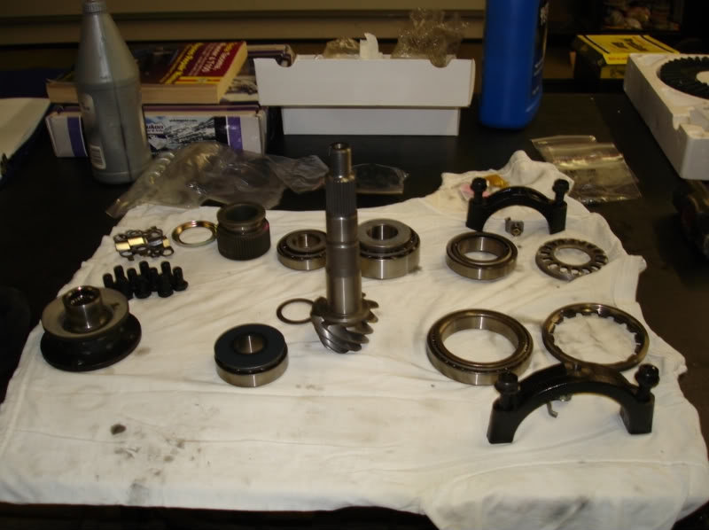

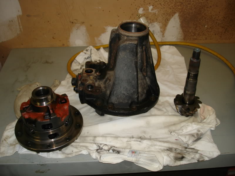

Here's a few more...

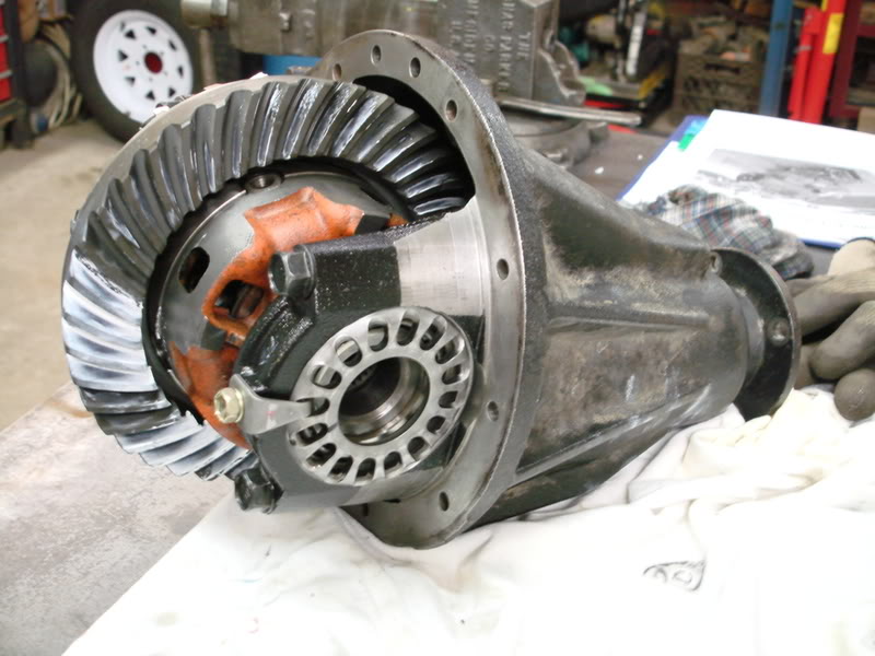

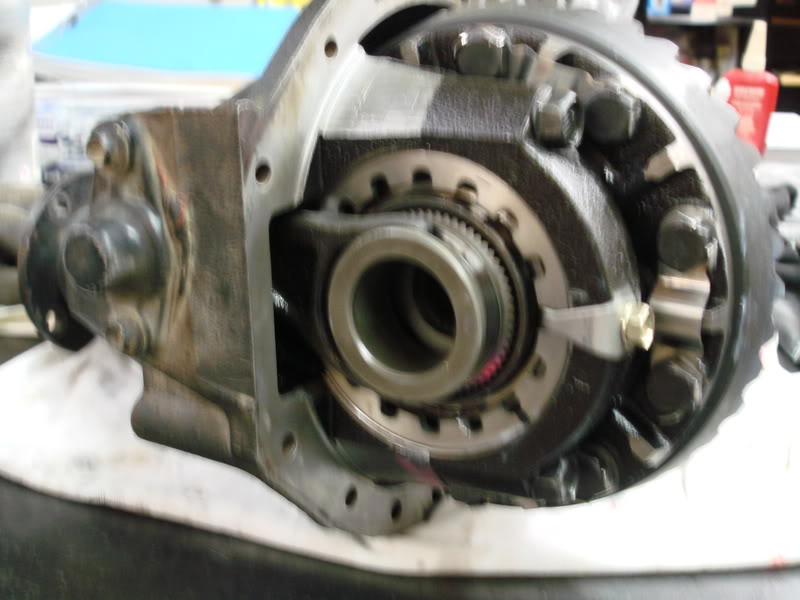

Clean version ready for install, on this side you can see the e-locker fork that is in the locked position

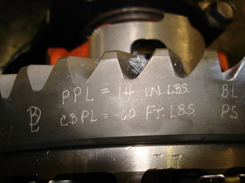

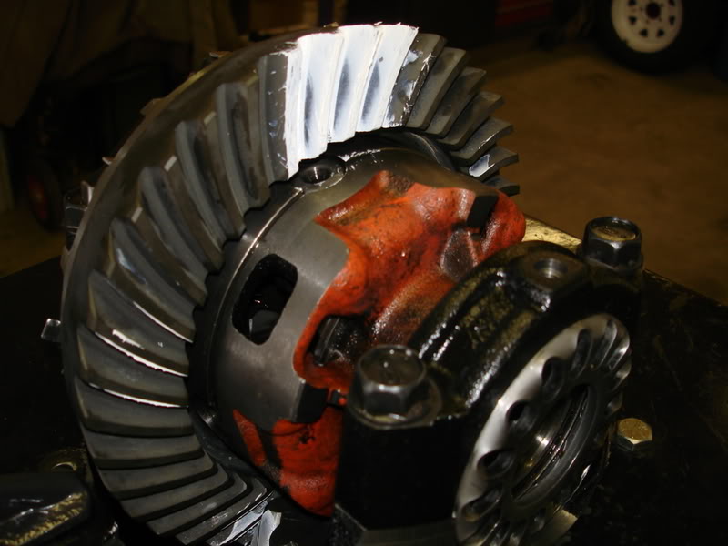

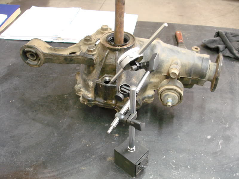

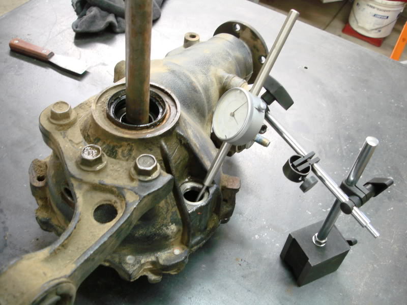

Before tearing the front apart we practiced gleaning back lash, through the drain hole. We had to tear it back apart after each reading for adjustments and pattern check, then prior to final seal up for fipg.
So last night I drained the rear diff oil, and things looked and smelled good. My two magnetic plugs had some material on them, but not a lot, and no large pieces. Filled it back up, and once I get enough miles on the front, I'll drain it.

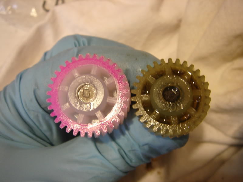

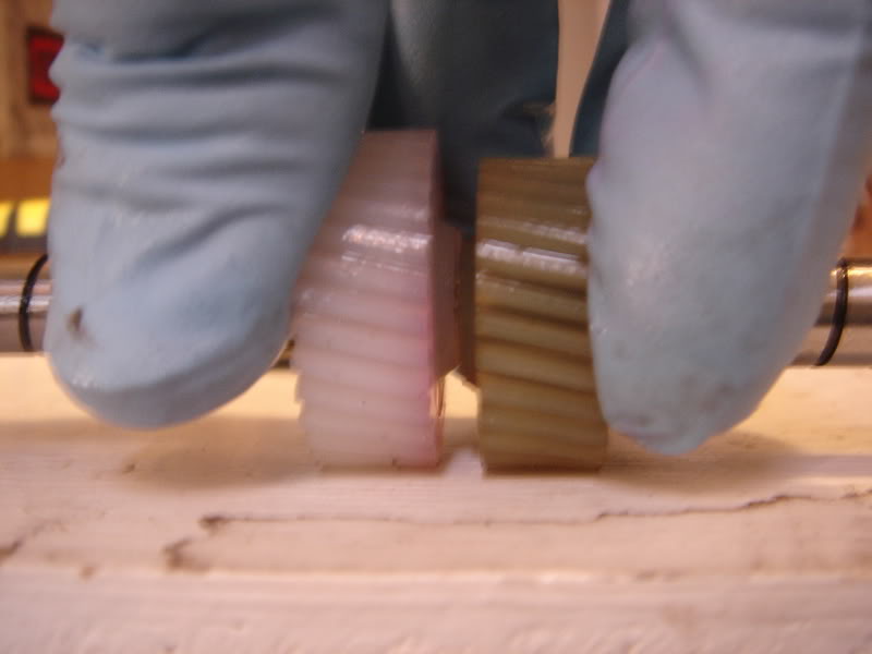

Replaced the 30 tooth gear sub-assemby with a 33 tooth. Each tooth is good for about a 3% change, and I needed to correct the speedo in the area of ~10%. Simple install, only the new gear is noticably larger.
After fighting with it, the speedo is now more accurate than it has been in several years. Now I can focus on other things :D
