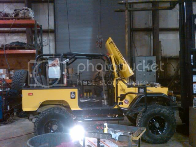

Not much done to her since my last post. I added the KC lights to the windshield. But I did purchase some "new-to-me" drivetrain parts from the bellhousing to the t-case.

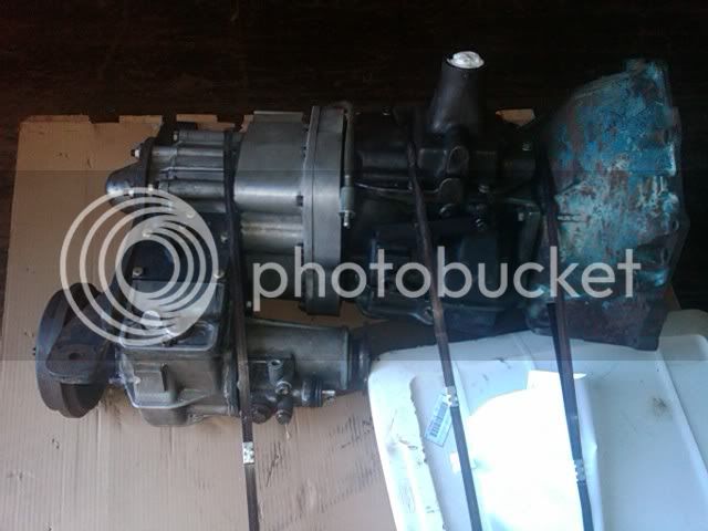

This is going to be installed in the next couple weeks: SM420 / AA Rock Box / Toyota 3 speed t-case. :clap:
SM420: Has less than 500 miles on it (PO bought it brand new, military version). It's a 4 speed with a granny 1st. Will give me the lower gearing I was looking for.
AA Rock Box: Gear reduction box with less than 500 miles also. This was a bonus as I wasn't really looking for this.
Toyota 3 speed t-case: takes care of my leak issue in mine. Although, I can see where the PO was having the same issue I was with rubbing, just not as severe or in the same location.
Oh yes it did. You can't see it but it also came with a home made tranny cross member that I probably won't use unless it looks like it needs it. I asked the PO about it and he said he just likes overkill and didn't think it was necessary. Got the whole set-up sealed and ready to go for less than the cost of a new rock box alone (if they were still available). :clap:

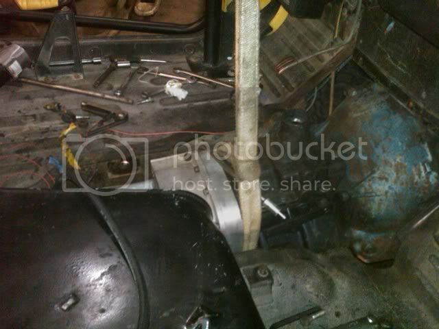

So, I finally got around to getting the new-to-me driveline installed this weekend. It is not complete but the really hard $hit is out of the way. With lots of help from lots of friends, we got it installed. I still need to fix the clutch slave, get the drive shafts re-worked (or get new ones), fill the cases with gear oil and install the revere switch. She is getting there......
