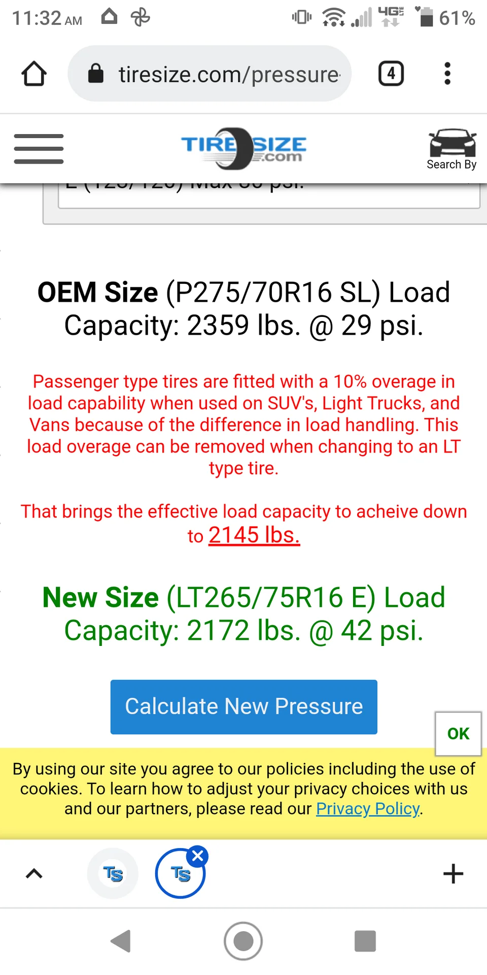

Good info thanks. Yeah I called BFG recently and they sent me to a conversion chart for LT tire pressure to E.
To achieve the same load rating of your LT tires when switching to E, the pressure just go up. You may sacrifice a little ride quality but the tire seems to hold up longer and wear better. At least in my case paired with a 7k lb 100 series

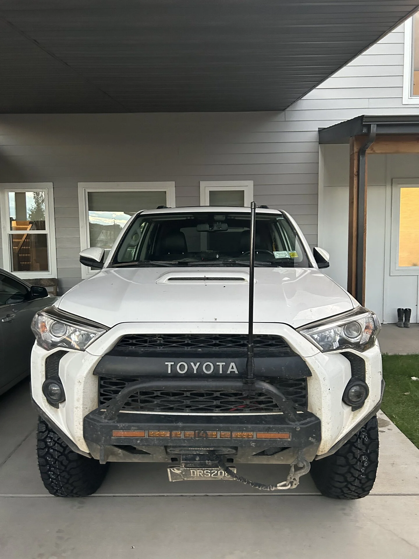

Just got the new wheels and tires on today after work, i have yet to take them for a drive but planning on Flathead tomorrow. Also got my new antenna on replacing the loaner from pat at right channel. But oh boy do 35s just look right

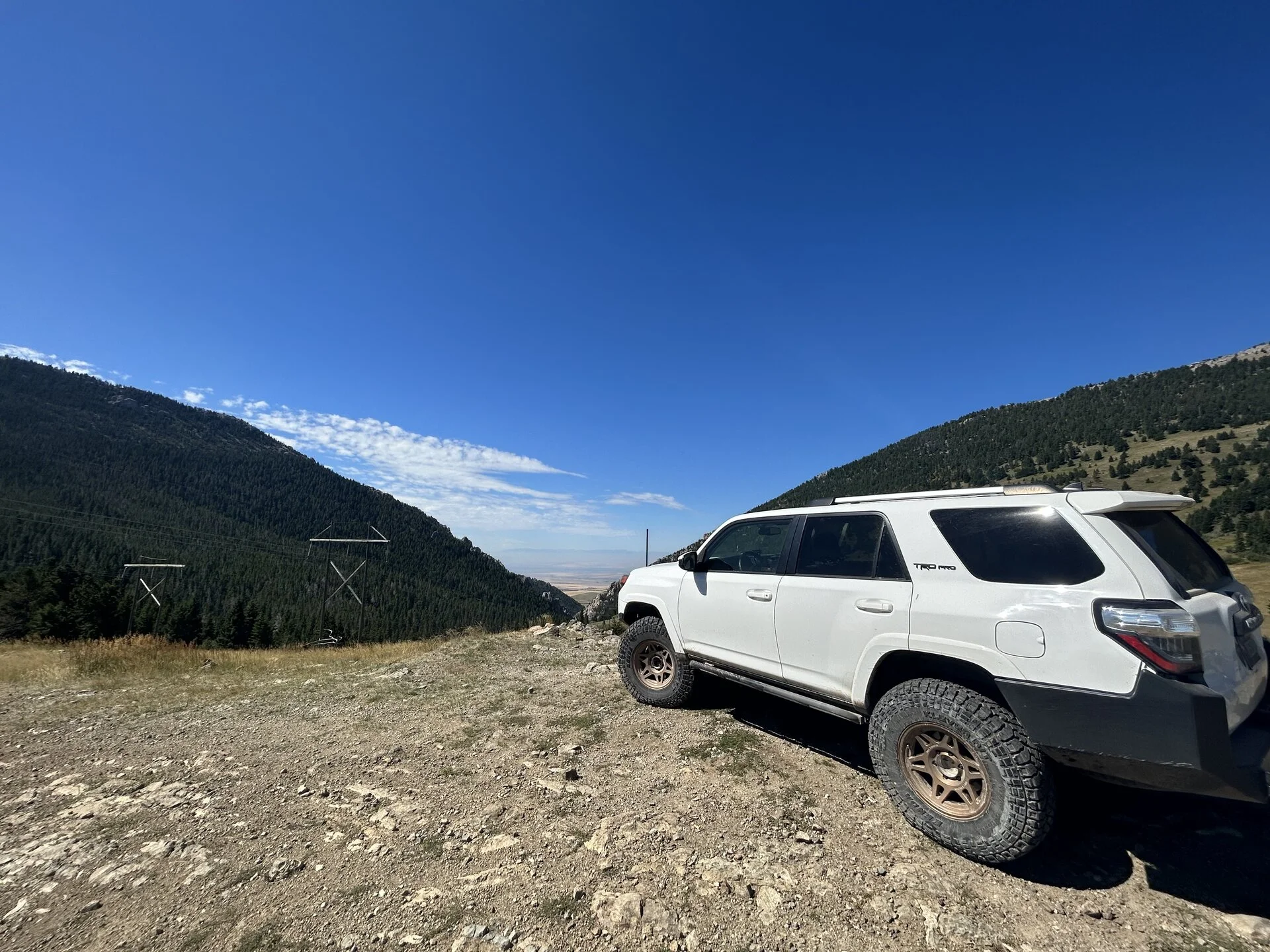

Just ran Flathead this morning, glad to say no rubbing and they are quite a bit quieter than the General grabber x3s, a smidge louder than K02s, I don’t have a re-gear and it feels fine on the road but I can understand why I would want to for better control on the trail
