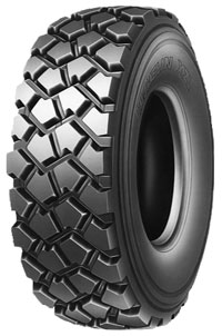

The XZL in 9.00R16 (255/100-R16)
Pros:
- Military Choice around the world
- "100" side wall
Cons:
- More expensive
- Too stiff for LC100 ?

The XZL are from Michelin, search the forum and google'em, you will find all what you need to know ;)
http://www.expeditionexchange.com/michelin/

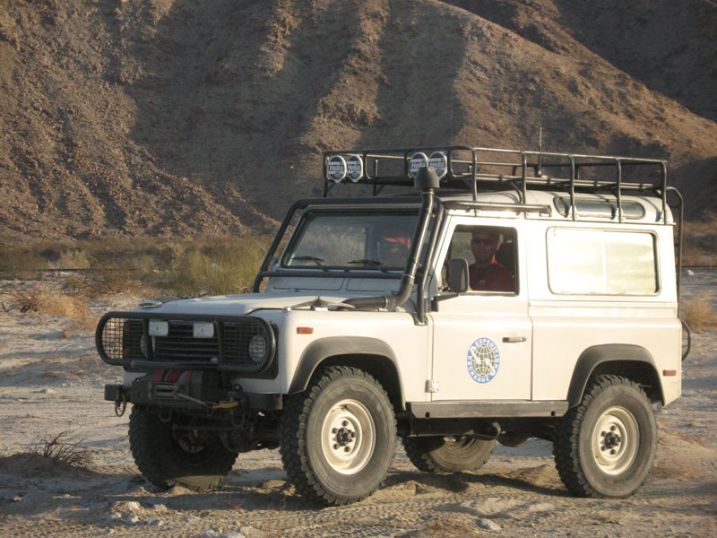

9.00R16 XZL are about 36" tall. Do they fit?
Overlanders choose the XZL for its toughness. Although many times it is said that they are horrible on anything other than mud. On pavement performance is reportedly the worst. But you say your LC is mainly off road.
I don't know anything about the Baja. But if it were me, I would choose the XZLs just because it is a PROVEN tire worldwide.
They certainly do. Skinny 255 but tall 100.
The siam have rounded edge so, they appear smaller

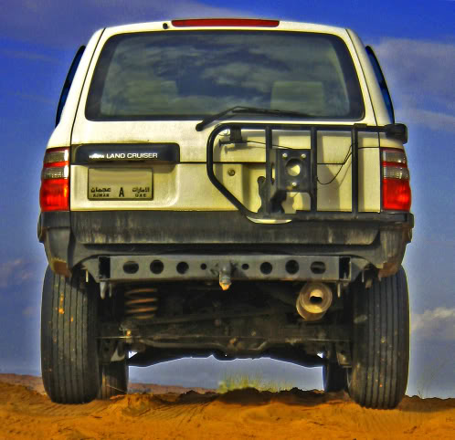

see the first pic in first post ;)

grab, hate to go off topic but uhm why exactly do you have a LX470 errr Cygnus front bumper? It looks good just wondering why you swapped it.
