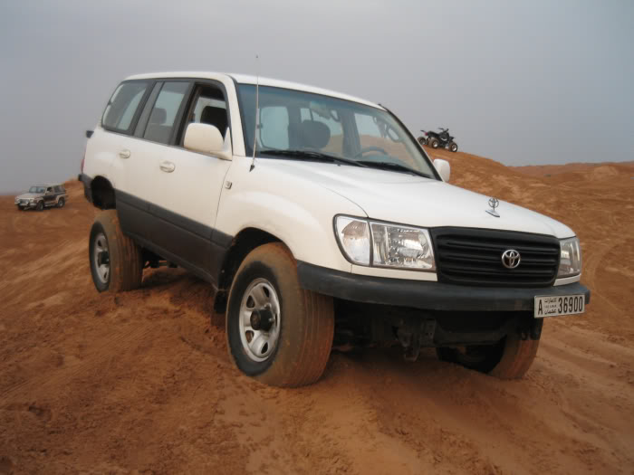

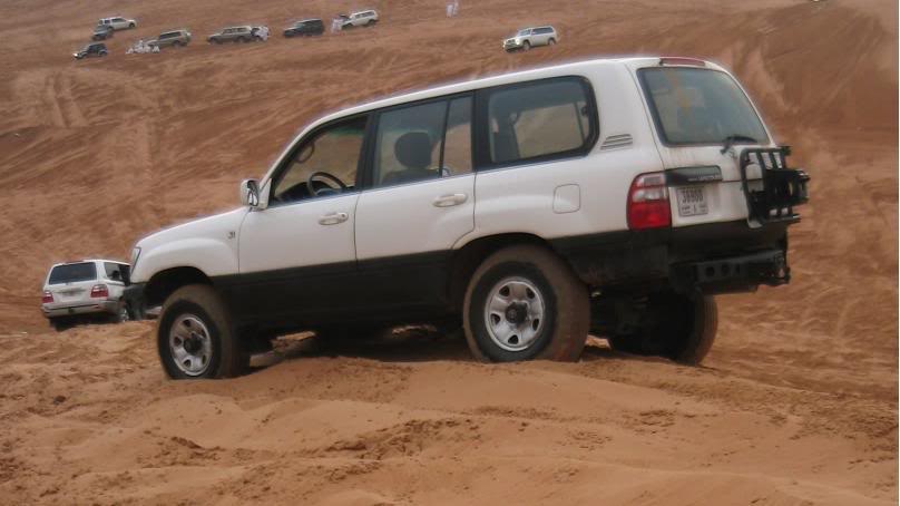

I measured those Siam today
33" inch tall no were close as XZL 255/100 (36.1" inch). I know BFG A/T's are 34.6" tall and would work with some minor rubbing under full compression.
[3.61-34.6]= 1.5inch = 3.75cm
The question is how I can make the XZL fit?
Mounting them on 8" inch wheel wide (255 work beautifully on 8 wide, I don't know the recommended size from Michelin)
1-2inch body lift?
Or just pick the BAJA and call it a day

Michelin recommends a 6.5" wide wheel for the 9.00 R16's. I would guess they can fit with the right wheel offset and at most 1/2-1" of body lift (if any at all). Compared to a 315, they are about 1.5" taller, so then they'll require .75" more clearance within the wheel well. But they are also over 2" narrower in width and all the 315's rub on the outer edges of the tread.
Also be aware, max speed rating on these tires is 62 mph.
Nice to know. I have the option off 6.5, 7.0 or 8.0 wide steelies
That max speed at max load ;) (~3750lb@80 psi)
Who would go over 80mph on lifted 100 anyway... SCARY!! :D
You could get some slightly taller rear springs and crank your stock torsion bars a little to help keeping stuff from rubbing as often, extend your bumpstops (lose up-travel), and do a 1" BL. I wouldn't go over 2" on the BL, and I'd actually like to see someone with a >1" BL on a 100.

The thing is SamoL, after to much researching and exploring the net forums I'm leaning toward tall and skinny preferable 255/85 (33" tall). I really don't like a heavy steering, It just not fun add tire deflation.
The 255/85 is just not available in any dealer, only by ordering them. In the other hand the size 235/85 is available more often.
If I decided to go with XZL, I will need
1- 1-2" body lift
2- 5.29" re-gearing
3- beadlock wheels (with that much meat)
I'm really close to pull the trigger on 235/85 for this moment, either toyo M55 or rally raid G1 and ordering BFG 255/85 MTR for next season.
The truck is barley covering any miles (max 10k/year) with no loads
:cheers:
