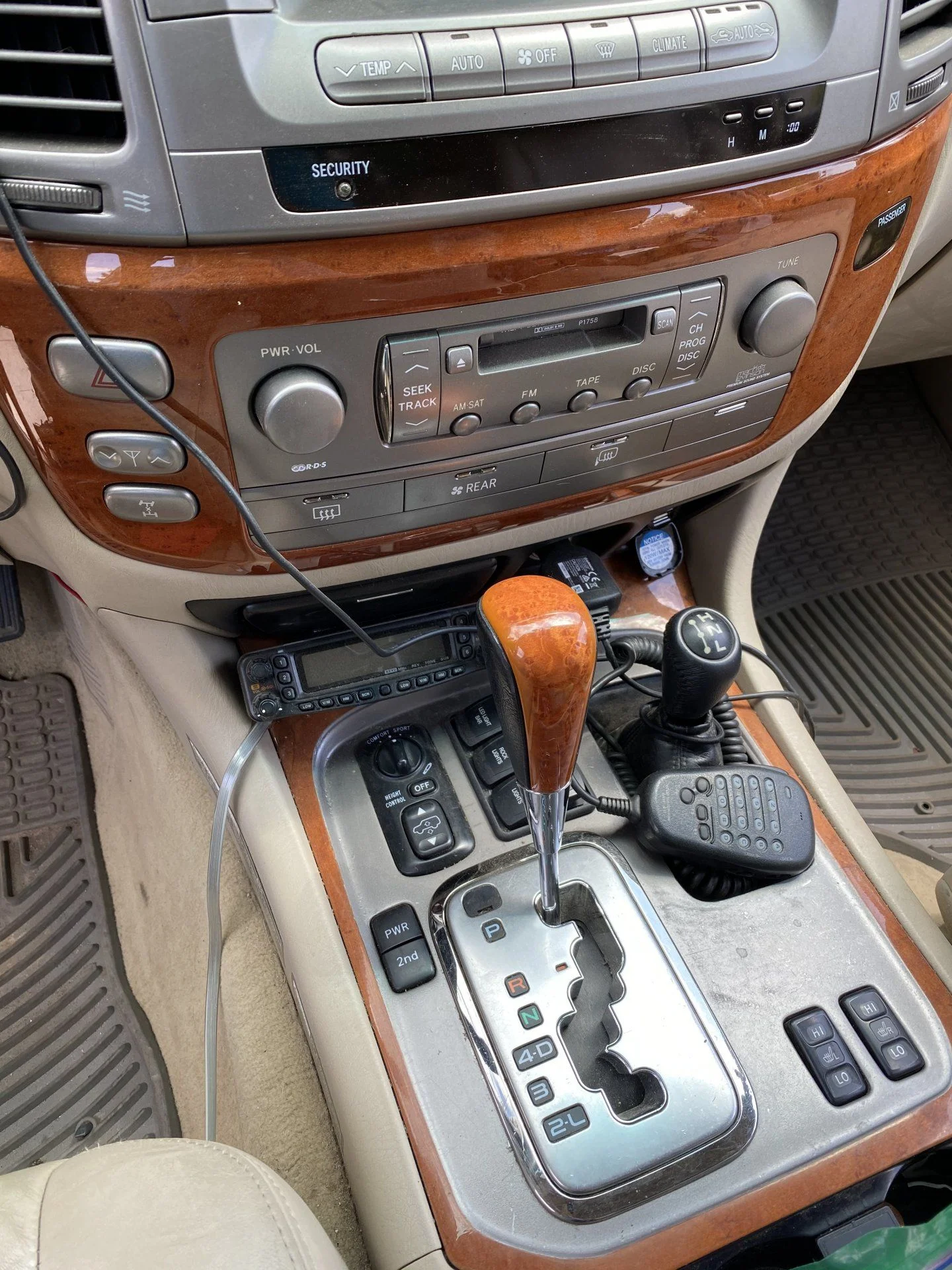

Looking for your pics of how and where you mounted your radio microphone. I've been (over) thinking this thing. I installed a HAM radio last year in my LX470 and my mic is just wrapped around the 4Hi/Lo shifter because I can't seem to find a good solution of how and where to mount the mic. I've seen all sorts of mounting stuff. Ram Mount, magnets, clips, sticky tape. What have you done? Do you like it?

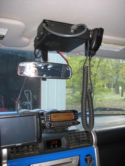

Don't know anything about your LX layout, but you can buy a little chrome mic clip for next to nothing and screw it on anywhere you want. That's what I did on both of my current trucks. FJ40 on the roll cage:
FJC on the radio mount:
They're handy for me there. Passengers don't seem to mind much; the mics are probably closer to them than me.

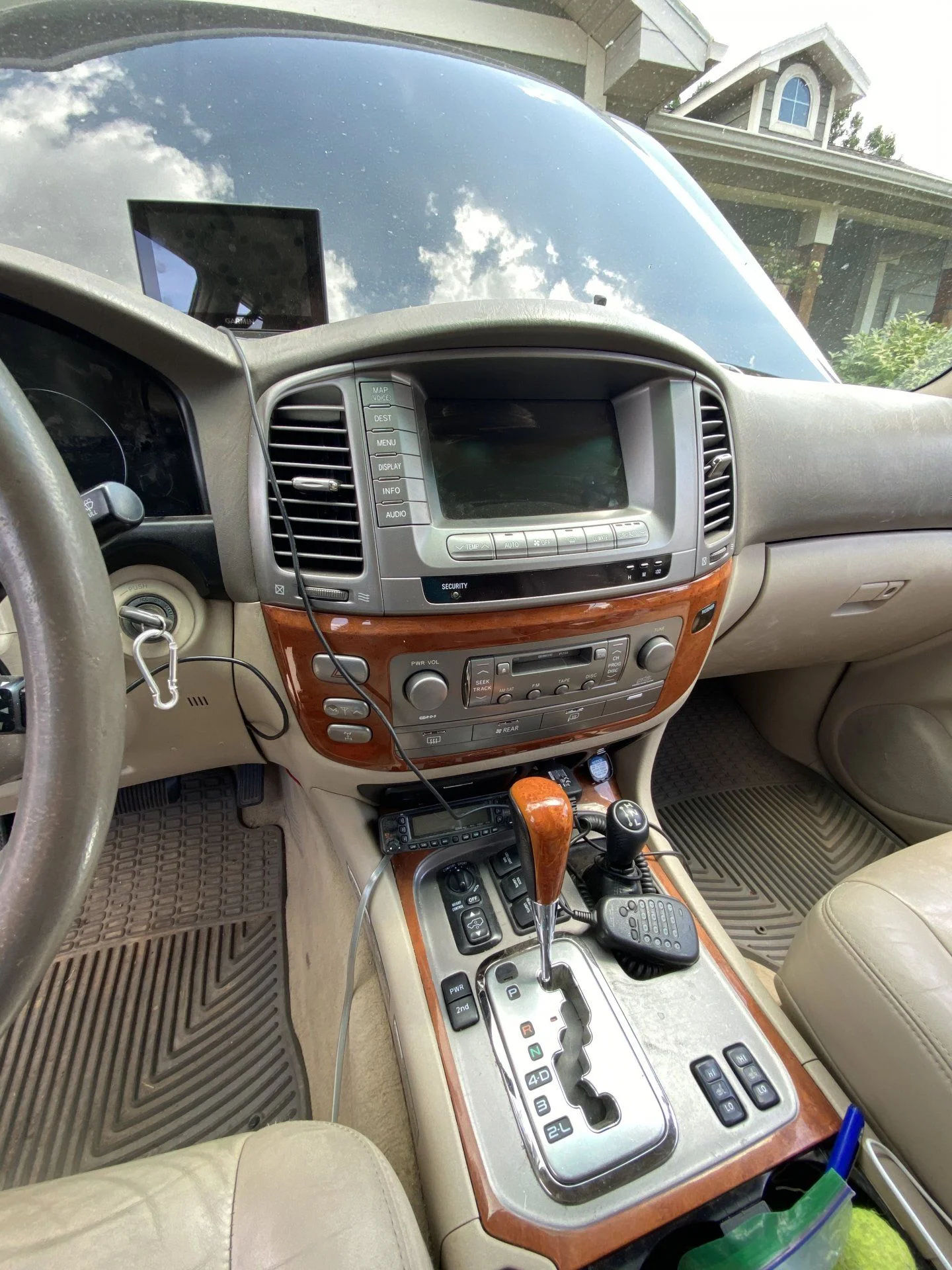

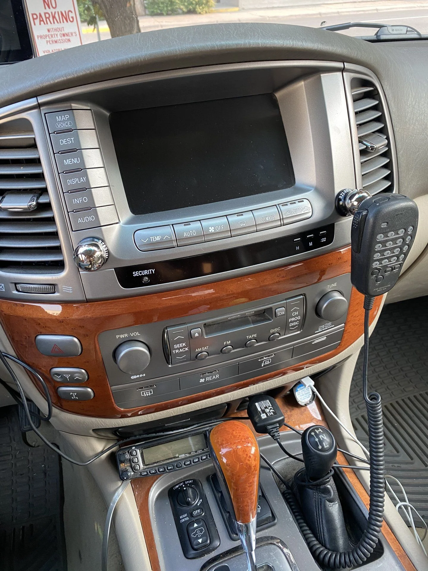

I wish the LX470 had a more utilitarian dash layout. This is what I'm working with. My radio is snugged up under the ashtray with velcro tape. The ashtry might be good place to screw to, but there's not much room for the mic there and I'd have to relocate the radio head. There's no convenient panel to pop-out like earlier LX/LC versions where BenCC made a mic mount. I have one tiny "blank" in the dash under the Tuner Knob.

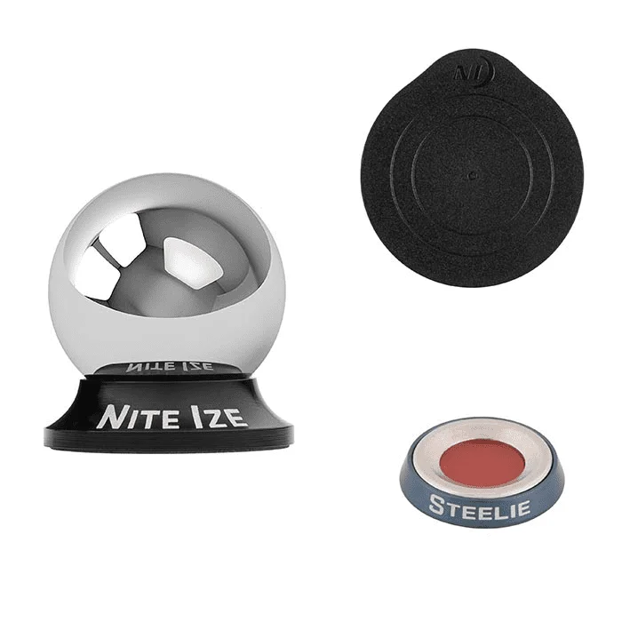

I'm using the Nite-Ize Steelie mount. Low profile button on the back of the handset clip and multipurpose steel ball on dash. Basically the red button has a high strength neodymium magnet inside and a covering of red nonslip rubber. The steel ball has 3m double stick base and can be used with other devices that have the button magnet.
I checked around with some local 406 Cruiser Club members and found another guy using the Nite Ize Steelie with the same low profile button on the mic. He also said it was bomber. Low profile button on the mic fits perfect. That was enough to tip the scale for me. I bought a second Steelie to hold my phone. Figured I could swap the phone/mic from left/right Steelie when wheelin. Access to the stereo and climate controls doesn't seem too limited. The sticky back on the Steelie feels super strong. I hope it will hold up to wicked hot summer dash temps and the occasional 20 below winter days.

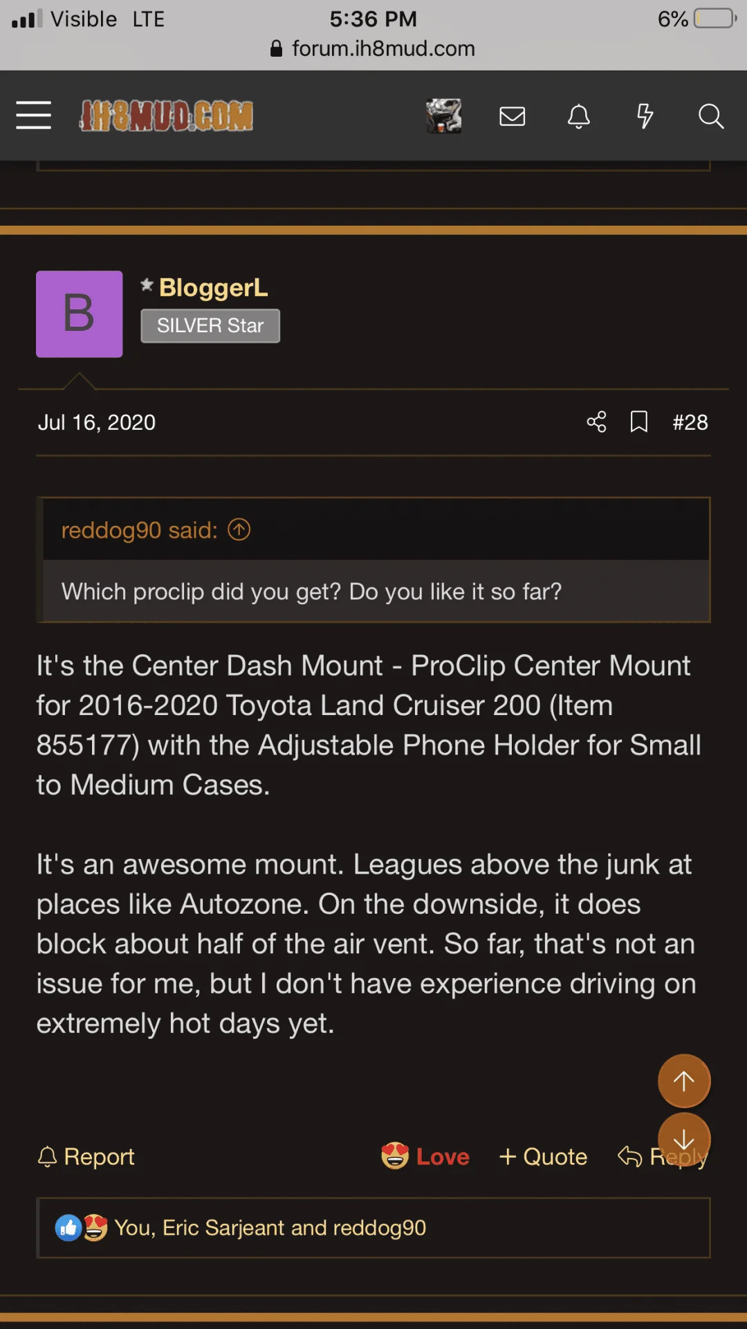

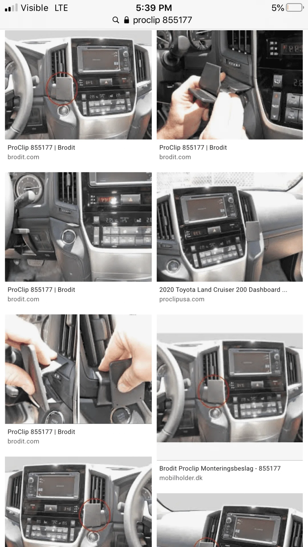

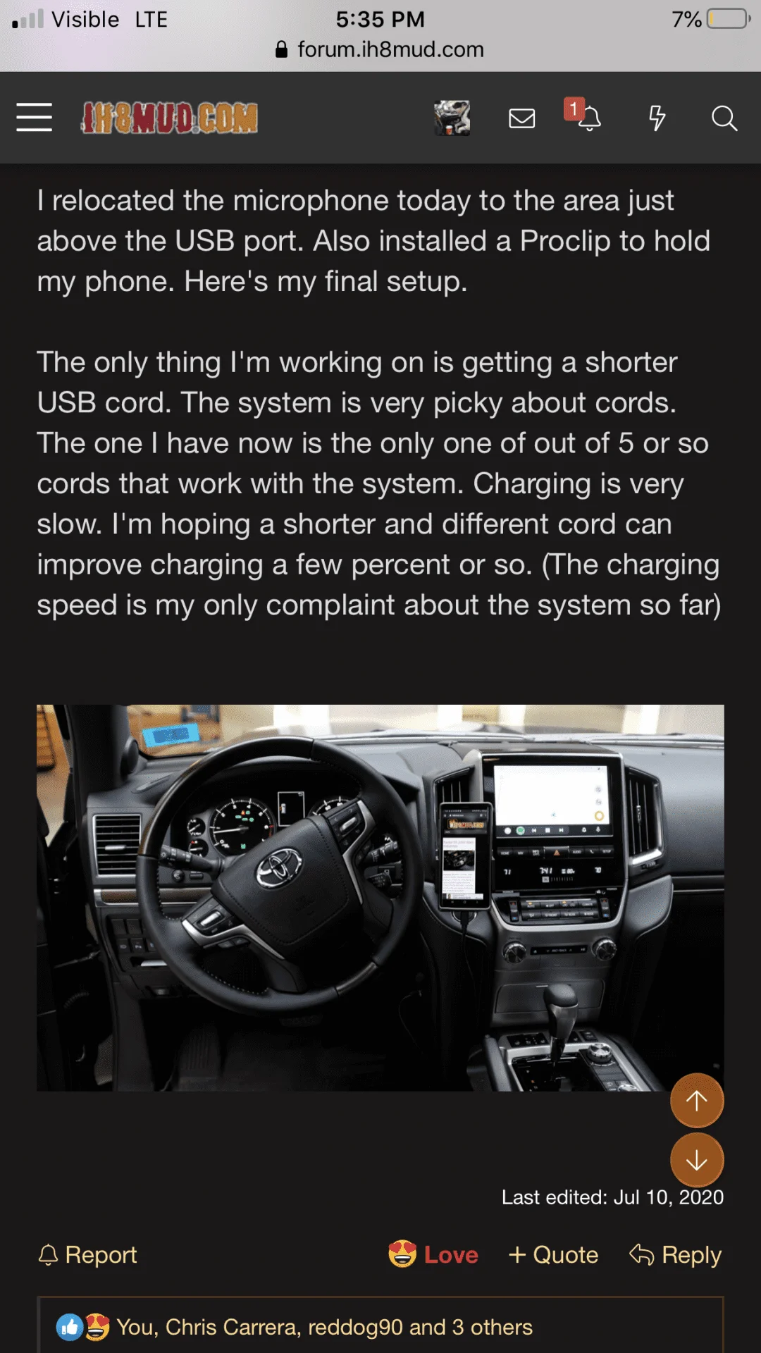

Maybe he’s referring to the ProClips? Here is an example of one that a member used to mount his phone. I’m sure there is a version for 100 series.
Flat piece of bent steel that slides right into the gaps. @BloggerL might be able to chime in here.
No. I wasn't referring to that ProClip at all. That's not how it's done professionally.
On a modern vehicle a plastic section of the dash will pop out, special bent steel will go between sections with screws hidden behind dash.

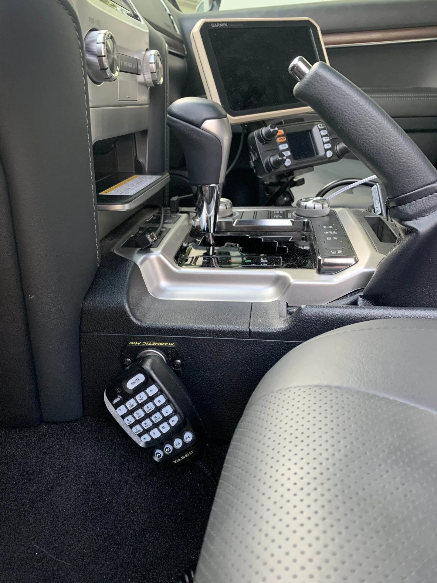

You might try one of these Magnetic Mic plus, I hear this guy will cut you a decent deal. I have one that I use in my SxS.
I have the Magnetic Mic mounts. Works well.
How has this held up for you? Trying to decide between this setup or a Magnetic Mic.
The Nite Ize Steelie has been great. I put a third one on near the top right of the display (for second mic on my GMRS). I've had one Steelie fall off once or maybe twice in the years it's been on. I got a 3M sticky kit off amazon for a few bucks and put it back on. Easy.
Ditto, had the Steelie on for a few years and recently it came off the dash. Just cleaned up the surface area and going to use 3M tape to remount at the same location.
