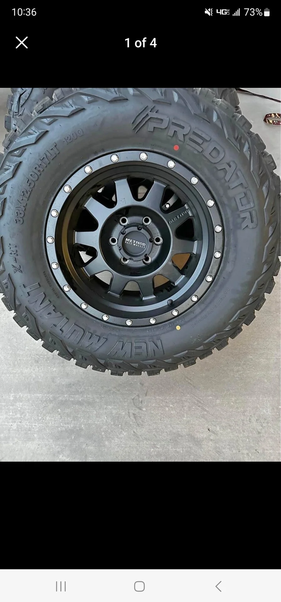

Would these wheels fit my 80 series? Are they a real bead lock wheel? The guy selling them says they are 6 × 5.5. How would I know the offset? What offset does an 80 series typically need?
Thanks
Not a true bead lock. Dollar store tires.
Should fit the 80 unless it’s a full float rear which might require milling the hubcap portion of the wheel to clear.
Offset “looks” like it would work on an 80.
Also offset is generally on one of the rear inside spokes of the wheels

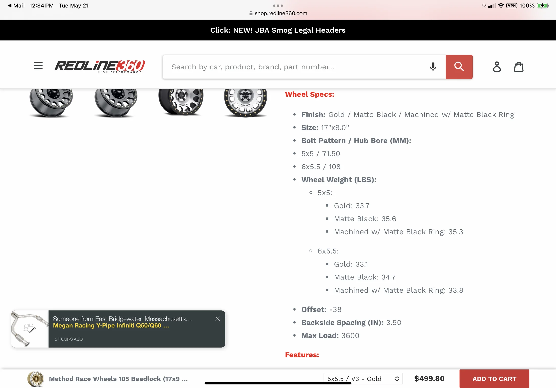

Im running these, they work great. If you get your hands on them you can measure back spacing to see if they will work on your 80. Never had an air leak.
