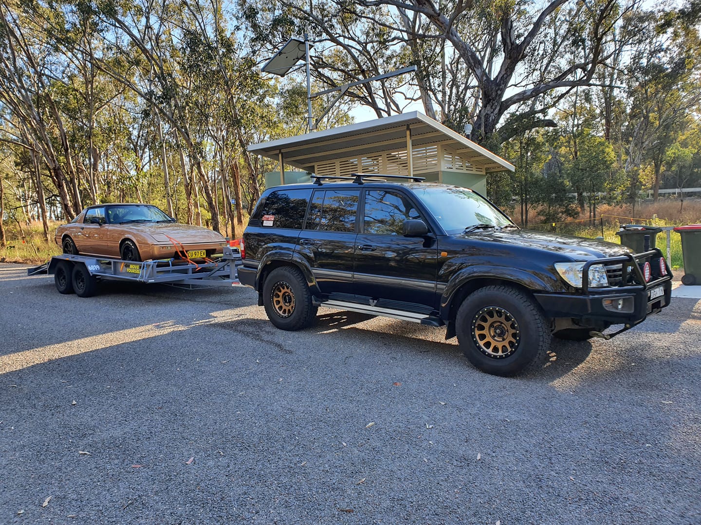

This is my rig. These are the 18x9 701 wheels with BFG KO2 35/12.5R18. I'm not running any spacers at this point, and from my research I shouldn't have to but I haven't been able to test that off road enough yet. I'm working with Bencc to create a cap for the front wheels.
