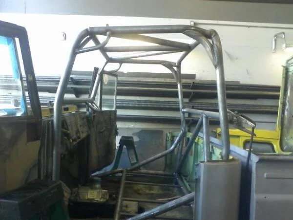

X2 on the custom cage mated to the frame. External tank, and removed the filler on mine. Plus FC Fabs shaved part of the dash so the front verticals are straight shot to the floor.

The problematic area is the gas filler neck on the tank and the connection from the tank to the body. I wonder if just notching the corner of the stock/rare gas tank and move the filler neck to another area on the tank is enough. For refilling, just open the passenger door and pump directly into the tank.
