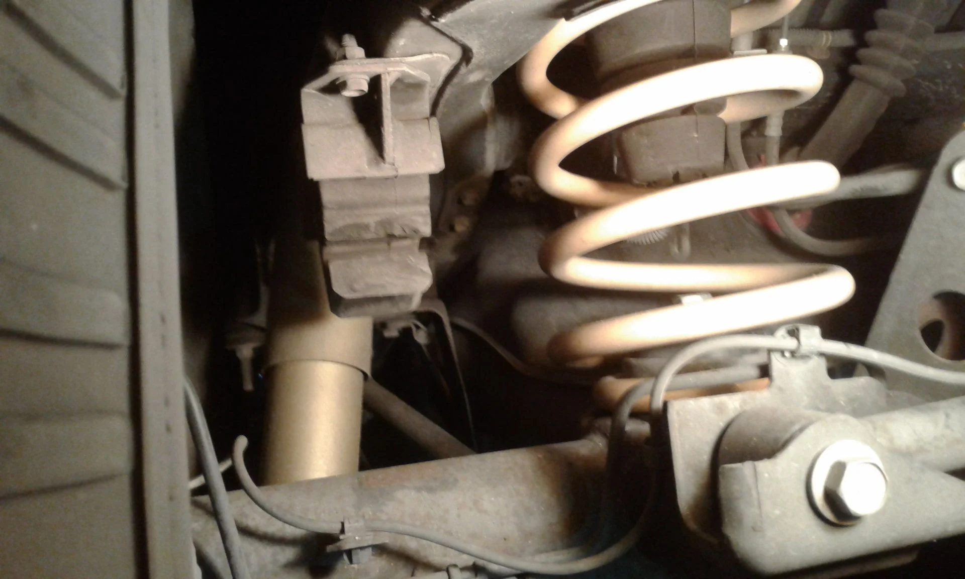

I have a concern about the design of the metal tech suspension conversion kit. I recently purchased and installed the kit but am not pleased with its performance. I installed with FJ Cruiser springs and Bilstein 5100s front and rear. I wasn't looking for much height just a little lift.
I found the ride to be very nice for typical driving, but larger bumps would result in harsh bottoming out. In looking closely at the suspension I noticed that the secondary isolator is too high in relation to the bottom spring mount. This allows the bumpstop to contact the axle before the secondary isolator contacts the bottom spring mount. The result is the harsh ride that I and some others have experienced with shorter springs.
My solution was to buy Daystar spring spacers to put above the springs and the isolator moving the isolator down in relation to the frame and the bumpstop.
This has greatly improved my ride/comfort as the secondary isolator is now able to perform its job and take some of the energy keeping the axle from bottoming out on the bumpstops.
I would like to see either a taller bottom mount, or some type of spacer included in the kit to bring the isolator down so it contacts before the axle bumpstop. I'd also like to see the bottom mount have a bottom so it sits more securely on the axle. Mine was like an upside down cup sitting on the curved edge of the axle spring mount which relies on the tightness of the bolt to keep it from moving. I'm concerned this will lead to loosening of the bolt over time. Fortunately it is a nylock nut and won't likely fall off.
I would also like to see the top of the mount smooth so the exposed bolt head doesn't damage the secondary isolator when it makes contact.
Here is a photo from another build on this site showing the metal tech mount and the isolator. It looks like the isolator will contact at about the same time as the bumpstop.
Here is an image showing a 4runner - notice how the isolator will contact the bottom perch approximately 2" before the axle will contact the bumpstop?
Has anyone else experienced this? I noticed several people had moved to a taller spring and then felt their problem was solved because they weren't feeling the harsh bottoming of the shorter springs.

I think both of those images are with the axle hanging free - I'll take some of mine with load on it when I get back home. I only have a couple of inches when weight is on the springs.
I had this issue when running FJC springs. Solution was simple, go with springs that work w/ the GX, and FJC springs don't fall in that category (too little spring rate). The fact your suspension is moving that much in daily driving is a blatant indicator the springs, while seeming to ride "nice," are not approrpriate for the application. (If you haven't loaded up your GX while running FJC springs, just wait - the ride will be utter s***.)
The isolators are not proper bumpstops anyway. They serve to progressively moderate bump until travel limit is reached and the axle/fame bumpstops limit further movement to prevent damage.

I think that's my axle in the 1st pic. As @Fubeca mentioned, the axle is hanging free. i have attached a pic of the same axle with the truck on the ground for reference. I gotta agree with @little_joe - there is only one bumpstop. If you look at the original design, there is the bumpstop and the air spring.

I agree with this - and this is my concern with the original design. It seems like the isolator can't do its job to add that progressive energy absorbtion if it is too high relative to the bump stop. From the original design of the 4runner it looks like it should contact about 2 to 3 inches before the axle hits the rubber bumpstop which is the ultimate end of uptravel.
The GX design doesn't use the isolator/secondary bumpstop because airbags by nature are progressive.
