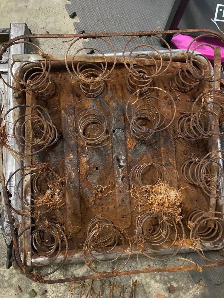

Would love to replace all of the springs in my driver and passenger side seats, but would settle for replacing the one metal spring that has been broken as you can see in the photograph below. Does anyone know of a company that sells these springs new? Thanks in advance!

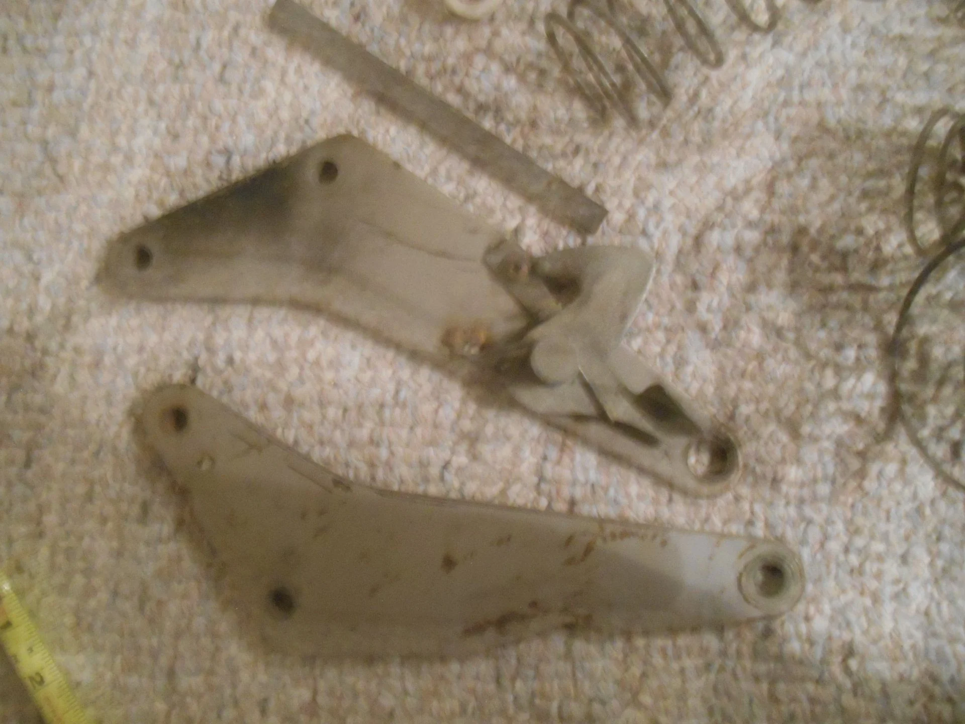

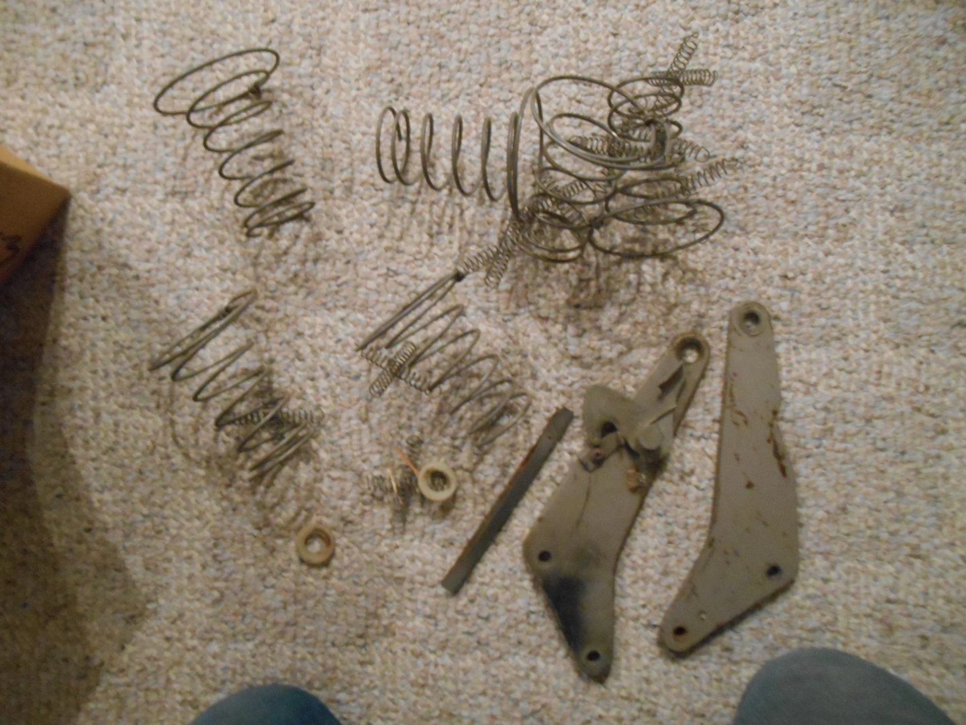

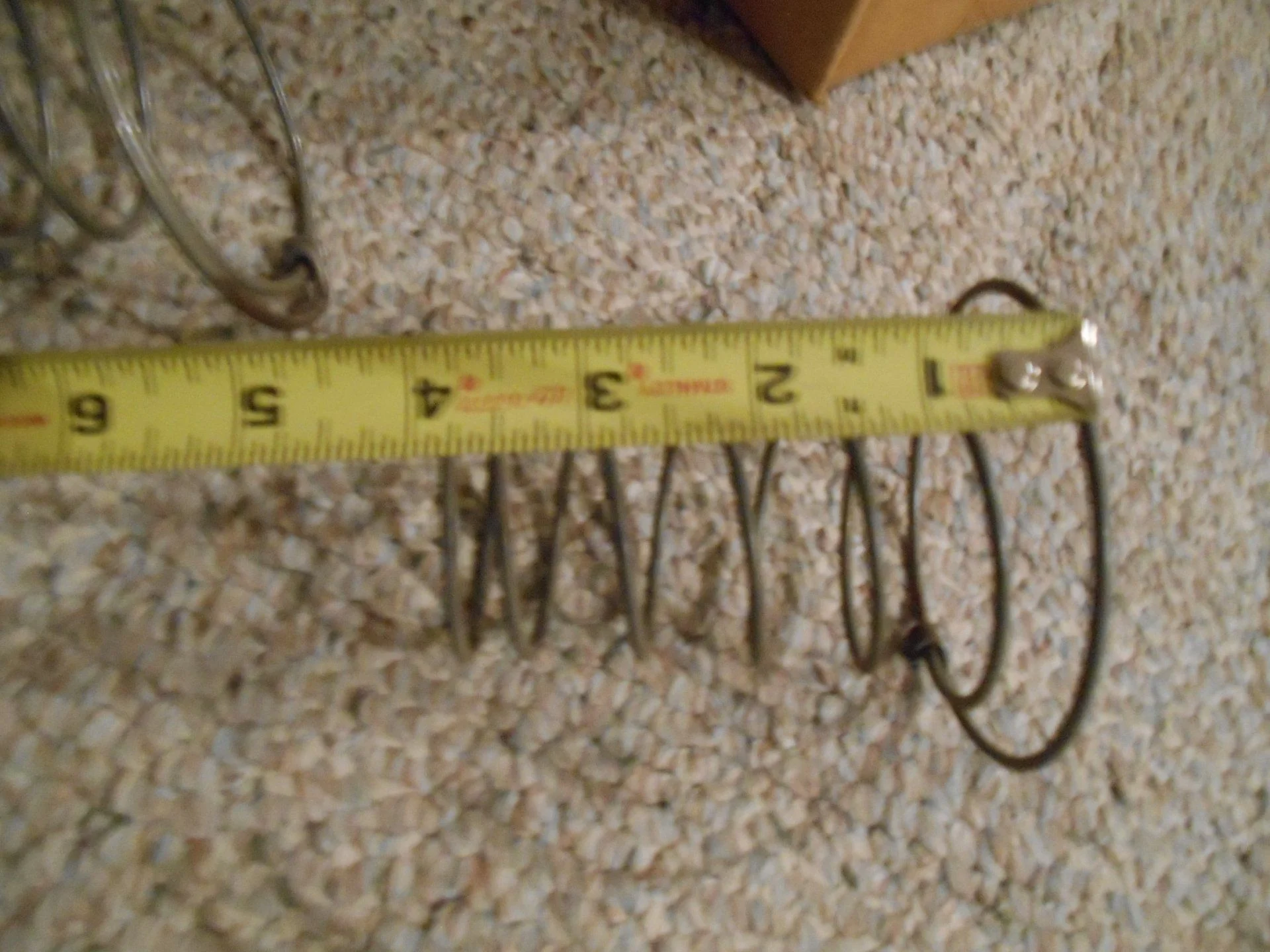

I have a pile of springs and side plates for a 1970 FJ40 seat. Springs are 4" tall free height. Let me know how much of any of this you want. Please send a PM. (pix are blurry/crummy - will clean camera lens...)

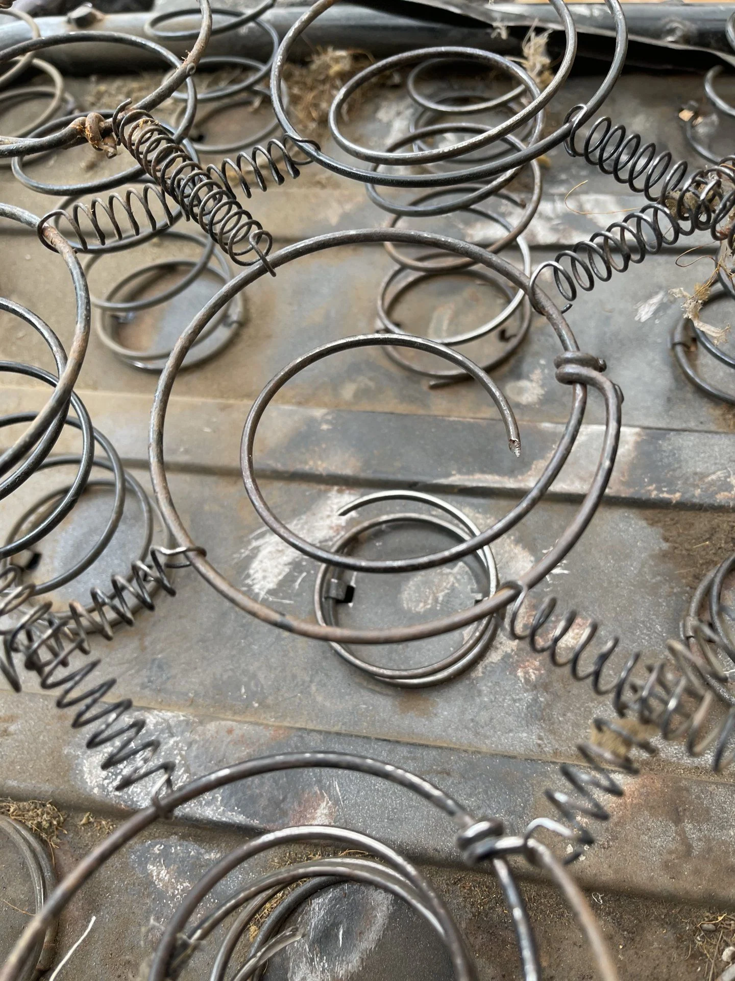

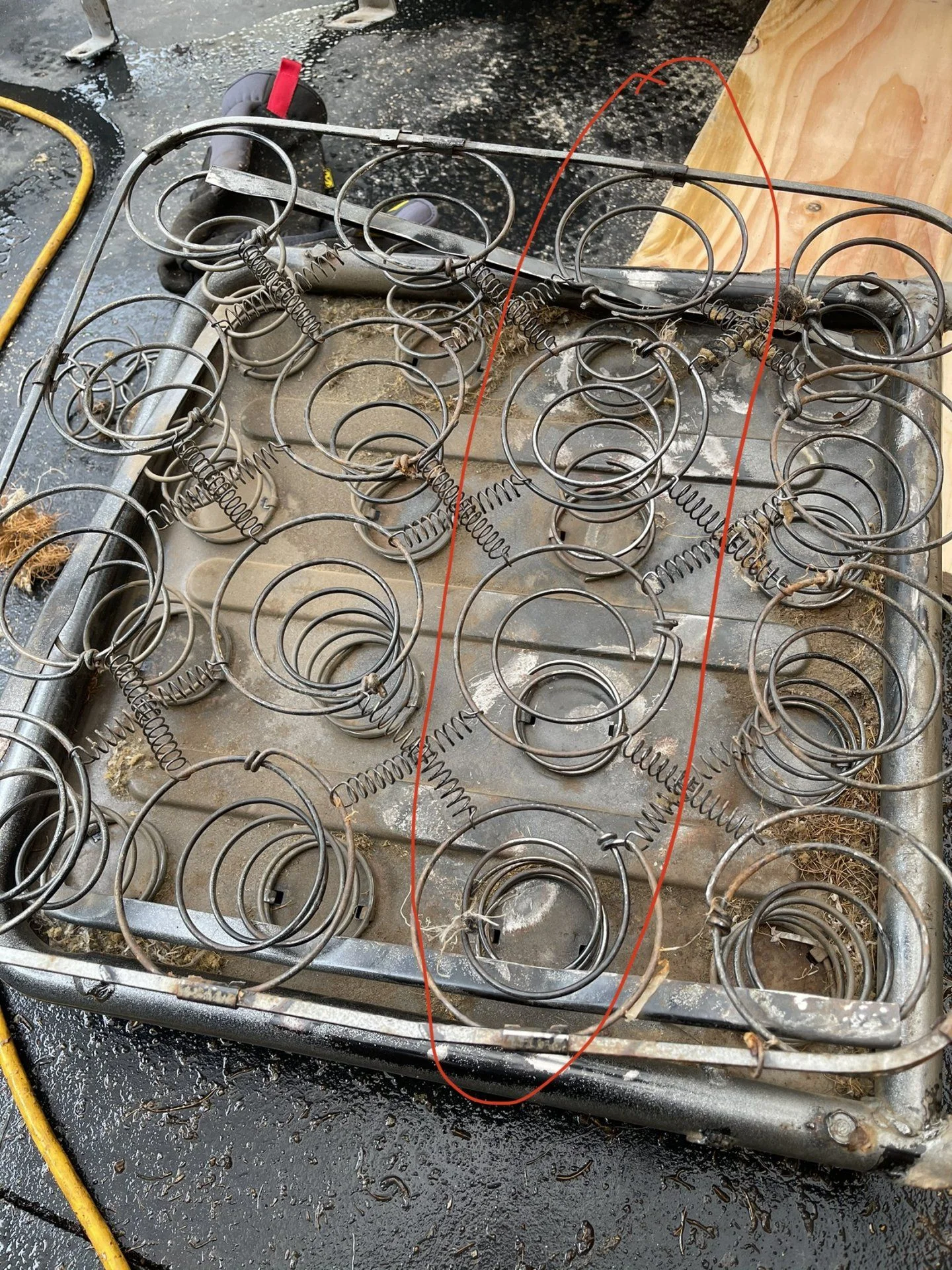

I have front bench seats for my 72. Just picked them up yesterday to replace the buckets that came with the truck. They are in great shape overall, but 3rd row from the front of the driver side has broken springs all the way across. I can tell by pressing down that there would be a significant low spot if I don’t fix them before reupholstering the seats, even with the new foams.
I suppose I could have someone weld 2 of the 4 that are just broken in one place, but not sure what that would do to the integrity of the spring and seems like a lot of work.

I had two broken springs in my ‘63 seat that I was able to weld back together. The trick was getting the pieces lined up and also a good ground connection (flux wire feed welding). I removed the springs from the seat and worked them on my steel table using magnets to hold and align the pieces together. I stretched and compressed them a fair amount and the welds have held. I love a challenge, especially one where I have no clue whether it’s possible or not 😂, must have skipped that lesson in elementary school.
on edit: looks like at least one of those springs is missing a section, not just broken. If so that’ll have to be replaced. Google upholstery coil springs, there out there just need to match height, coil diameter and wire diameter as best as possible. Good luck.
Good call. I don’t see any springs online that taper down at the bottom like these do, but I suppose if I order some that are an inch or so taller than I need I can cut them down. For the $25 or so, it’s worth a shot anyway!
