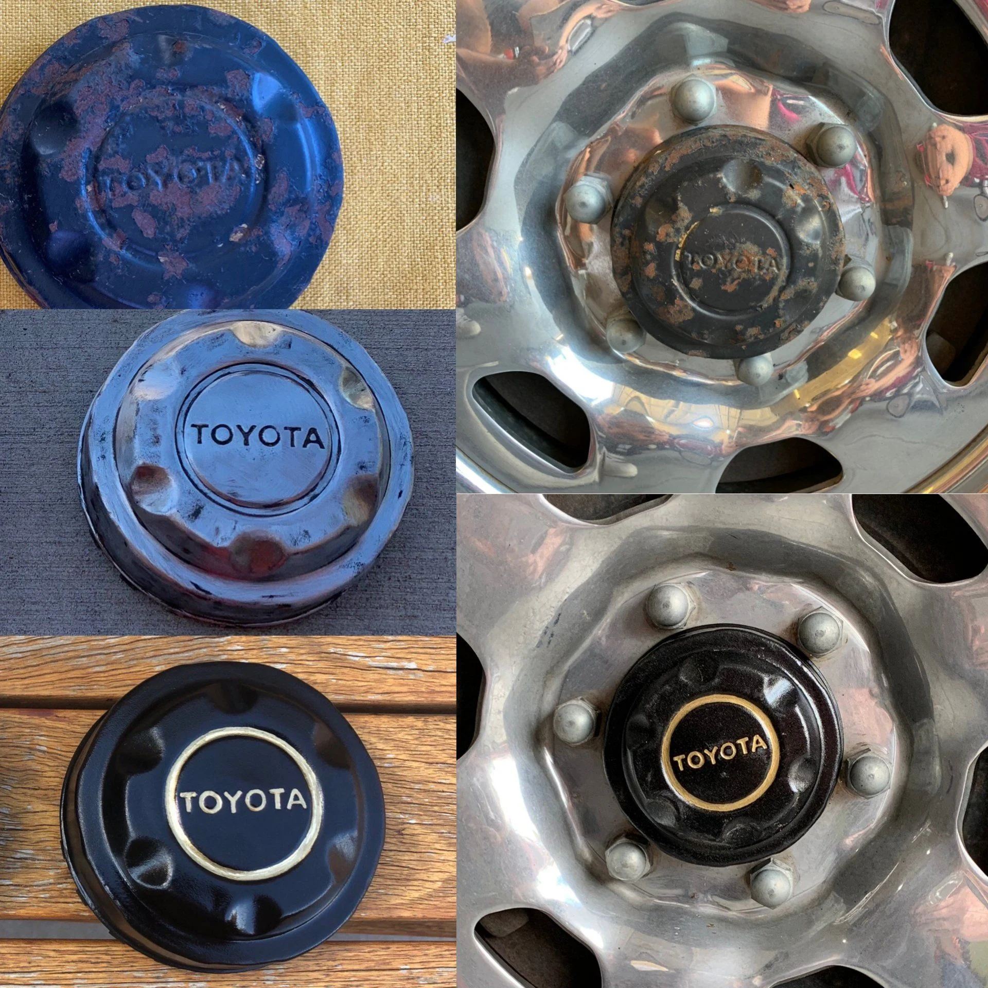

One of the first little projects I embarked on was cleaning up the OEM wheels. Following the advice of some other folks on here, I used bar keepers friend to polish the chrome.
Then, I removed the wheel center caps and used a wire wheel to remove all of the old paint and rust, and repainted in black. My wife used a gold paint pen on the rear caps for the gold circle and Toyota logo. It turned out pretty nice.

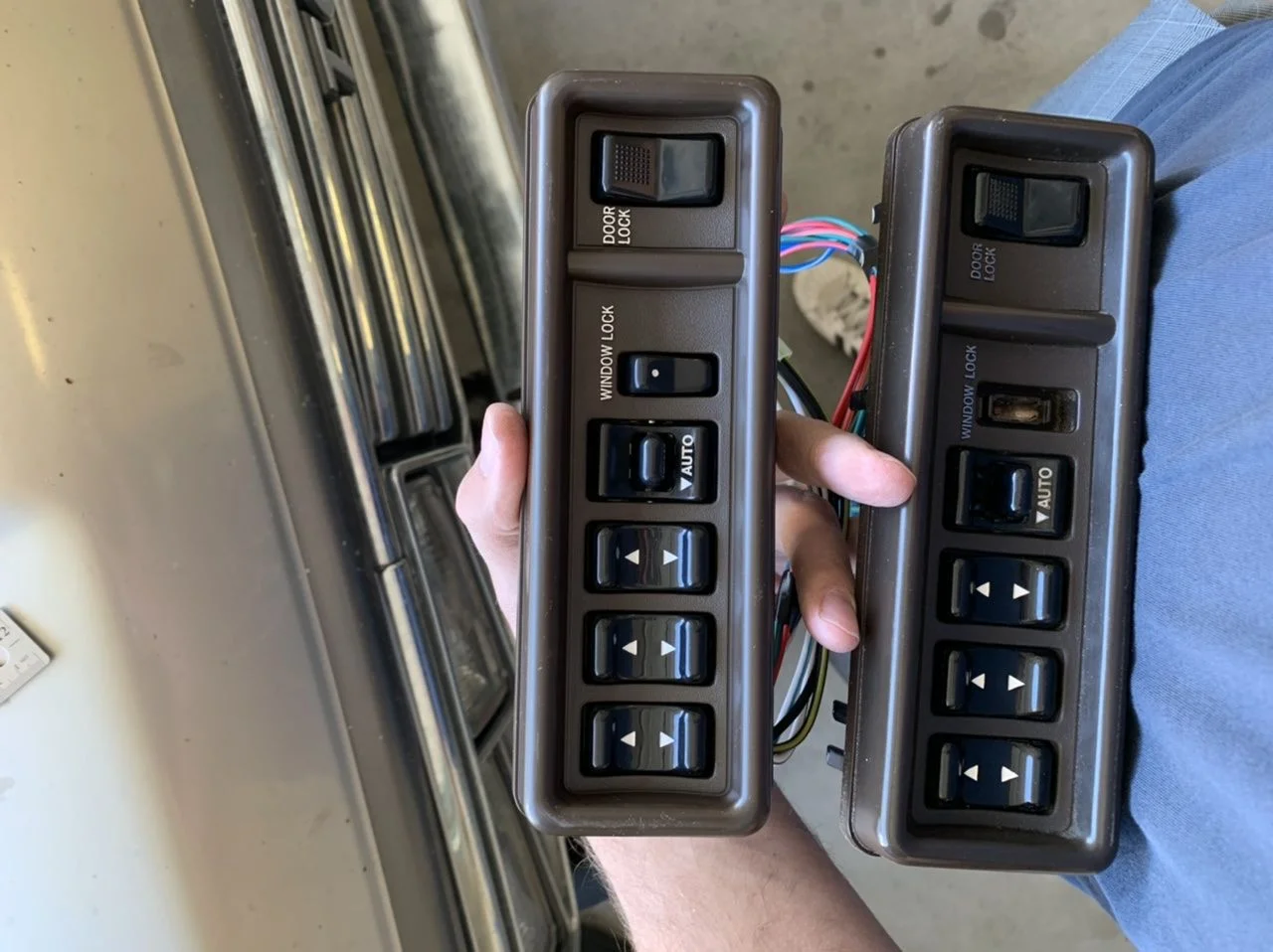

The window lock toggle switch had broken off on my truck, leaving me with only the drivers window working. I bought a replacement drivers side switch unit from switch doctor and swapped that in and everything is good to go. And it matches the oem unit surprisingly well.

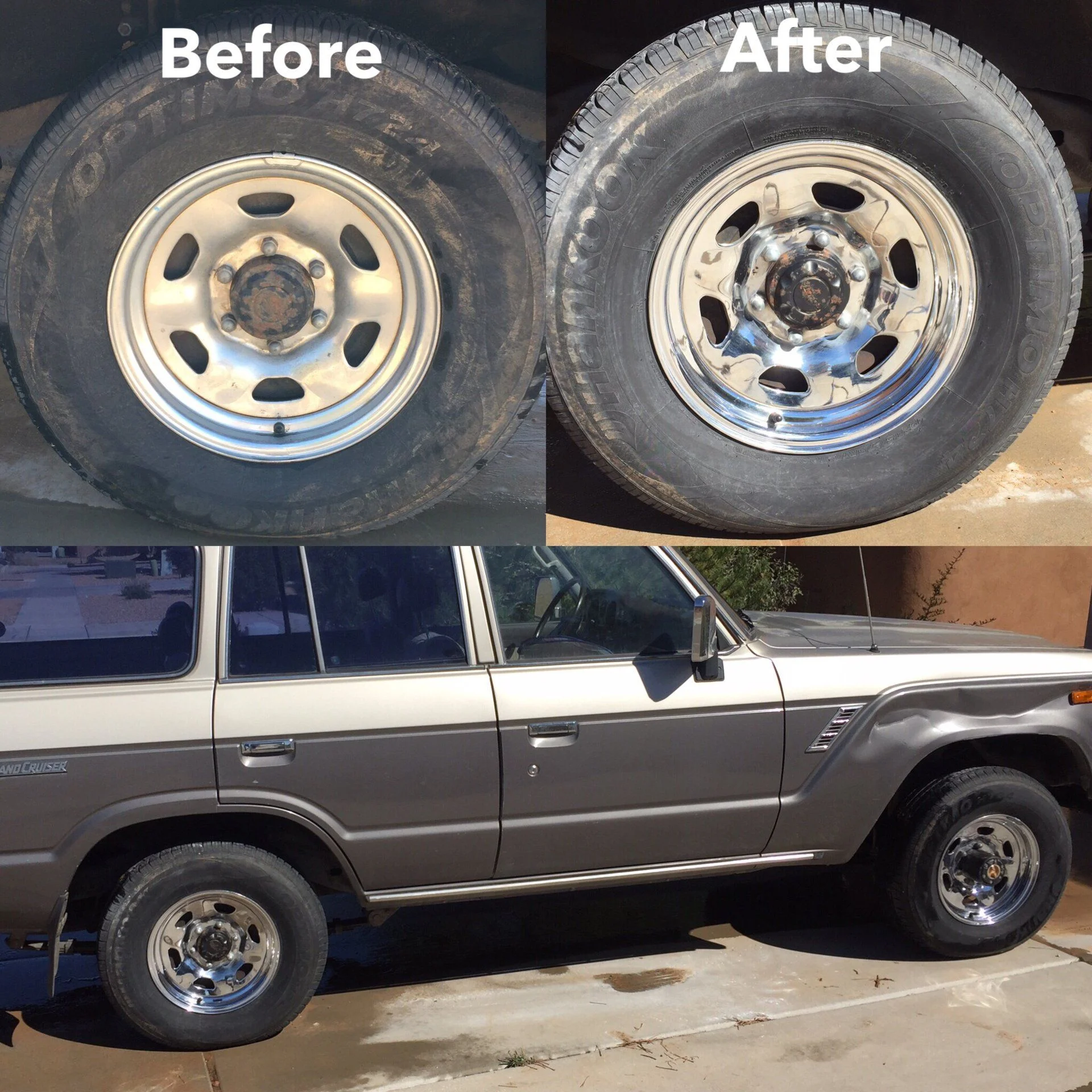

I also bought a $25 clothing steamer from the Wal and used that to remove the old purple and bubbling tint from my rear windows. There’s lots of good YouTube videos on how to do this. Took me a few hours to do mine. Not bad and certainly better than scraping with a razor blade.
I’m enjoying the old school fish bowl look for now, but I am intrigued by the“clear” ceramic tint others have mentioned to cut down on heat. Or maybe replace with regular tint at some point. Here’s a before and after. The purple tint looked worse in person.
