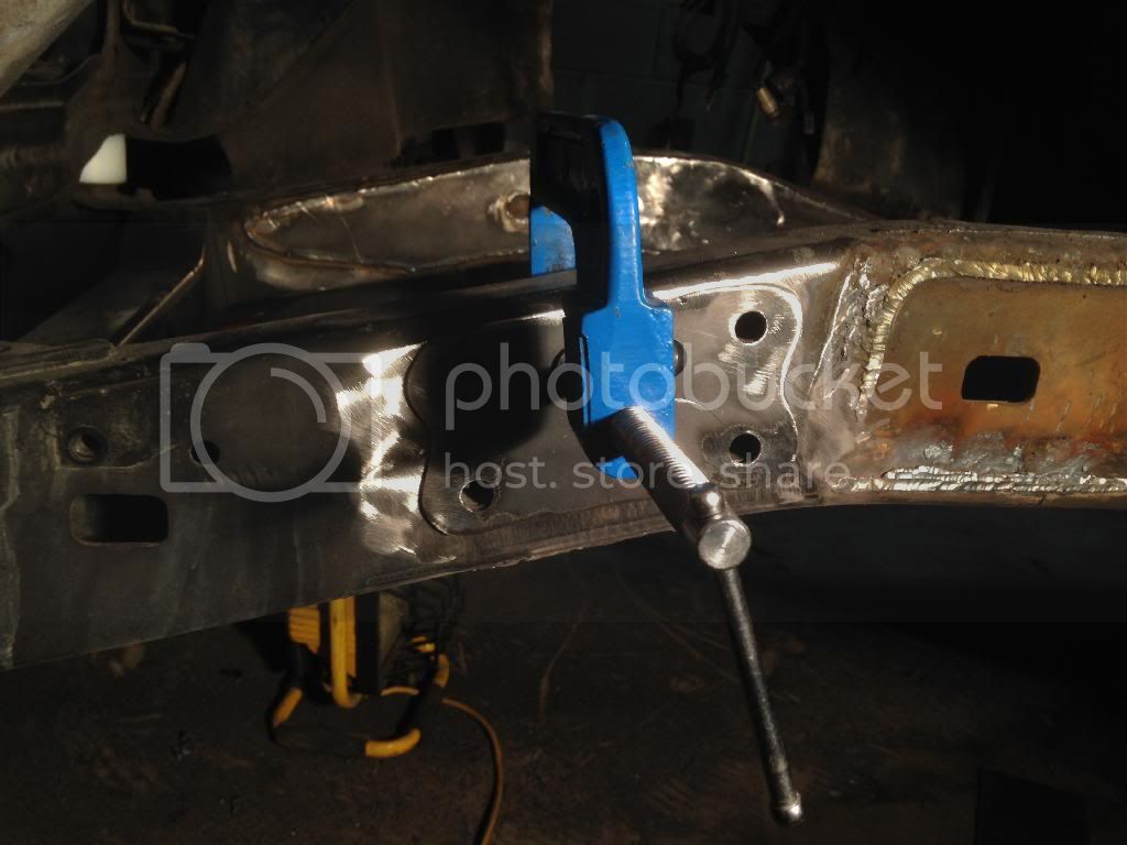

Haven't really done too much. Decided I want coilovers. Cleaning frame is a pita and time consuming. Wondering if I should plate more. Plate rear or behind firewall? Plate outside of frame from coresupport to firewall?
No cracks or anything and think the steering box will be fine with how I'm plating it. I think..
It is fully boxed front to rear.

No the frame was perfect. But with a cummins and a 3 link on tons I wanted more. In addition to cutting out the box support...
