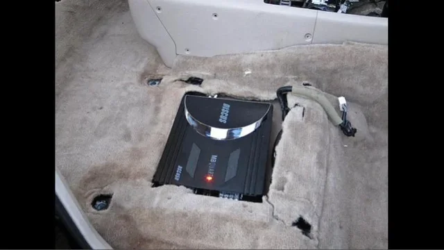

image-3977223070.webp Not a direct answer, but hopefully helpful: Here's a photo of an amp installed under the passenger seat of a 2000. The amp dimensions are roughly 11" x 9.5" x 2.75". There is a little room to spare but the amp has to be pulled out to access the terminals. The ridges the amp sits between are plastic and could be trimmed to gain more room.

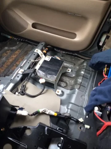

I cut a piece of card board yesterday with the dimensions of the Alpine PDX-V9 which is a 5-channel amp. I moved the seat (our driver seat) forward and up and put the cardboard over the factory amp.
It is slightly wider but it will fit.
That one is 259mm x 192mm from memory.
